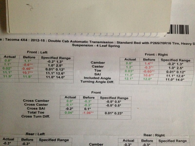

    Thought I would post up and contribute to this thread since It was one of the main resources for my decision. Mostly
    FJ to Taco 's truck was what I was shooting for and thank you to him for all the photos he's shared.
    Here it is.
    Pre lift
    And post lift 3 days after install.
    Installed 885's with 5100's and 1/4" lean spacer on drivers side. Full dakar pack, no leafs removed, with RCD/Bilstein B110 in the back.
    Got this exact kit with coils assembled from Headstrong O
    ffroad.
    http://www.headstrongoffroad.com/store/p312/Coil/Bilstein_5100_Kit_w/_Dakars_(HS05BK-1-Dakar).html
    and it was so simple to install for my Dad and I. Hope this adds to the thread.

    Very nice! What do you end up with for height in the front and rear?

    Thanks a lot!
    LF 20 1/4" RF 20 1/2" to both fronts at 23 1/4"
    Rear was at 20 7/8" to both at 24 1/2"
    Thanks! I already do love it! Rides and handles great. I still have stock upper control arms. Had an alignment completed and they say its in spec, but after my research on this site I'm not sure its the best specs for our trucks. Heres the numbers:

    Those must be pre lift measurements on the front. You should be around 22" to 22-1/2" now.

    Sitting at 23 1/4" now. Its only 3 days old so I suspect it will drop a little.
