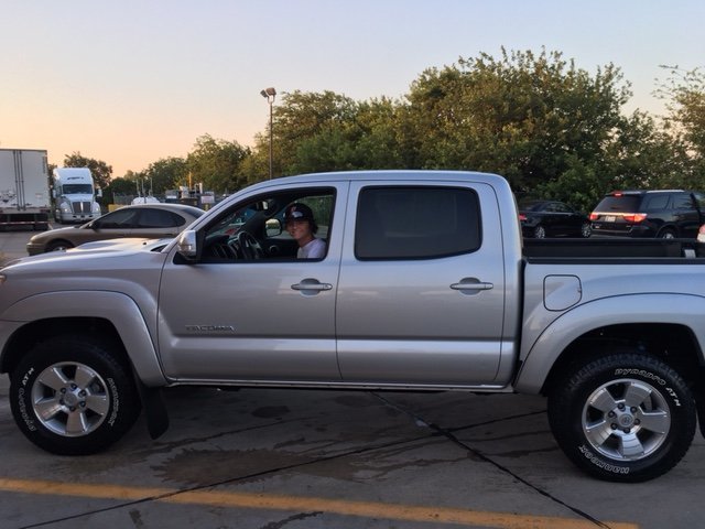

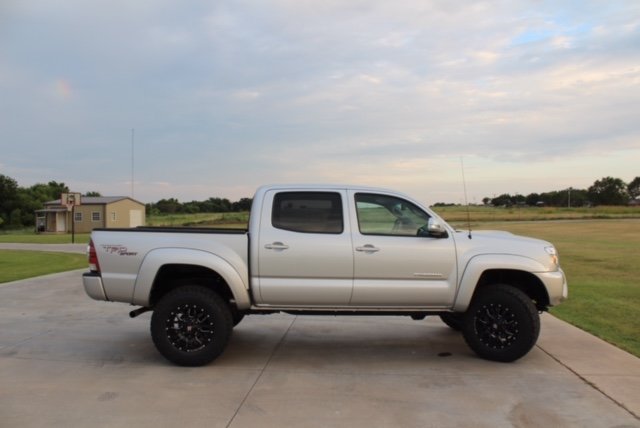

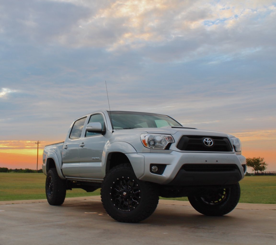

    I'm new to the Tacoma club, but I thought I would post some before and after pictures. I purchased the Bilstein 5100 lift kit (HS05BK-1) from Headstrong for my 2013 TRD Sport. It came with the OME 885 front coil springs and HS 3-Leaf add a leaf for the rear and the 1/4' spacer for the drivers side lean. I opted to have them assemble the front struts. I highly recommend Headstrong. I have never owned a lifted vehicle, much less had a lift installed so being able to discuss with them what I had and what my goals were helped out in the selection of the lift package I chose.
    Before:pre lift.jpg
    After:tacoma 6.jpg tacoma.jpg
    Wheels: 17" Ballistic Tank
    Tires: BF Goodrich 275/70/17 KO2

    Looks awesome man! lift looks great, Welcome! I bought the same exact setup last year. I still have to install it. Headstrong has amazing customer service. Marie is the BEST
    did you leave the overload leaf in the rear or take it out? im assuming you left it in but correct me if im wrong.
    did you get new UCA's? i bought Total Chaos ones so i dont have any problems with alignment
