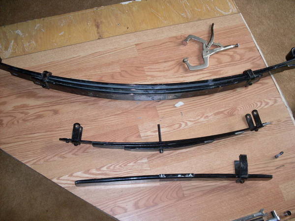

    finally! a pic of how it should be assembled! makes clear sense now!!!

    my aal came with new U bolts i think they are. this is because if the aal making it bigger right?
    99TacoDriver likes this.
  20. Aug 3, 2017 at 9:48 AM
    #340
    EatSleepTacos
    Mar 24, 2015
    #151688
    59,842
    Randy
    West Valley, AZ
    2017 4Runner
    Yeah, becaues the leaf pack is now thicker. I installed a 3 leaf AAL w/o the overload in for a buddy, and his stock U bolts still fit so we just reused them.
