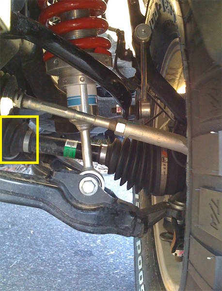

  17. Aug 18, 2017 at 6:44 PM
    #397
    EatSleepTacos
    Mar 24, 2015
    #151688
    59,842
    Randy
    West Valley, AZ
    2017 4Runner
    It's the inner CV boot. It's the part circled in yellow. However, there's an easy fix. See that metal band around it? You can snip that off, slide the boot down an inch or so to separate the fins, then use a hose clamp to retighten and secure it. I need to do that to my truck.
    Either way, I'd get it dropped to the 0 setting.

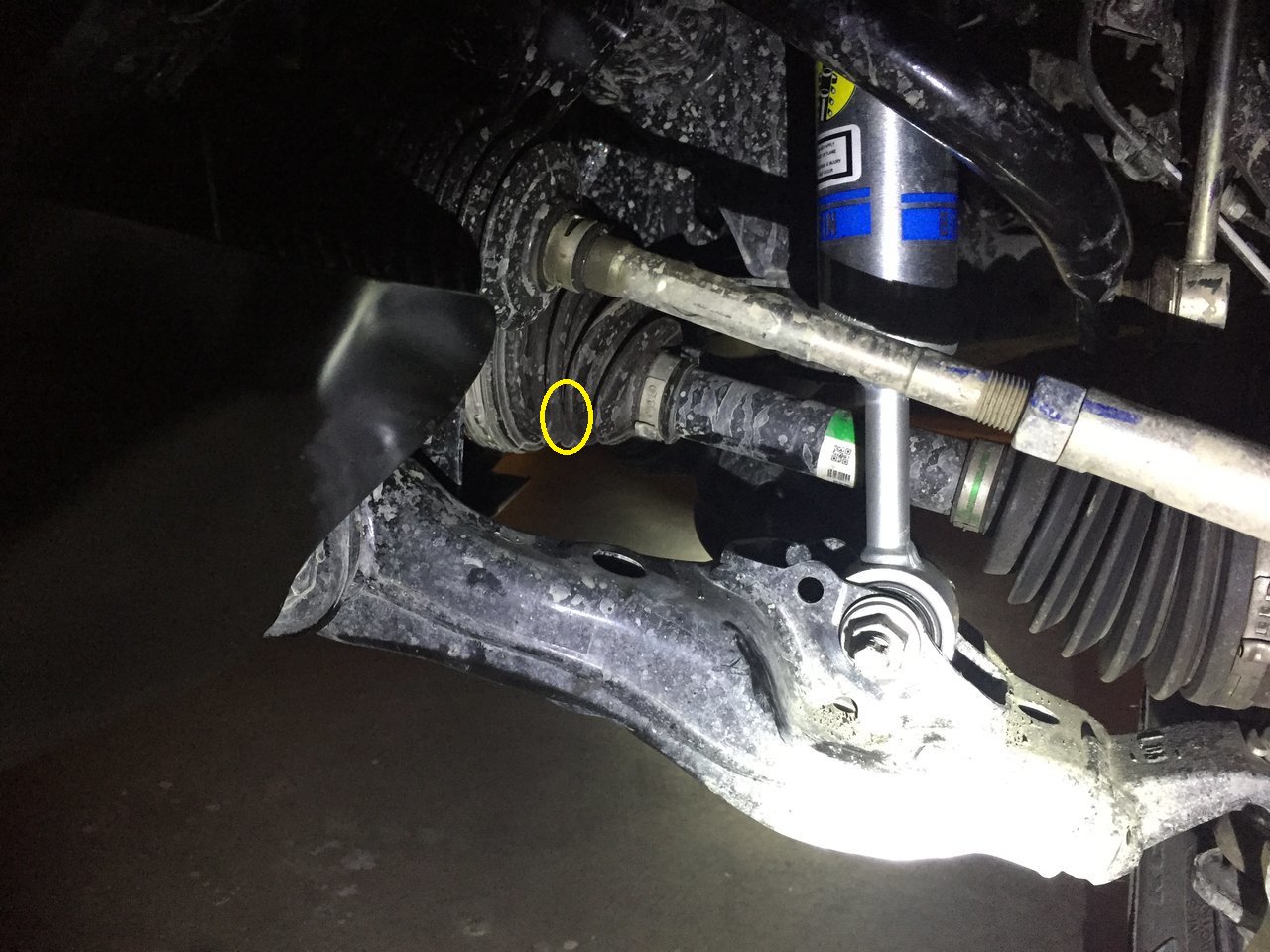

  18. Aug 18, 2017 at 7:04 PM
    #398
    vtac
    vtac Well-Known Member
    Jun 13, 2017
    #221395
    349
    2017 Tacoma TRD OR DCSB
    Does it look affected?
    EatSleepTacos[QUOTED] likes this.
  19. Aug 18, 2017 at 7:06 PM
    #399
    EatSleepTacos
    Mar 24, 2015
    #151688
    59,842
    Randy
    West Valley, AZ
    2017 4Runner
    Yeah, it looks like they're touching right here.
