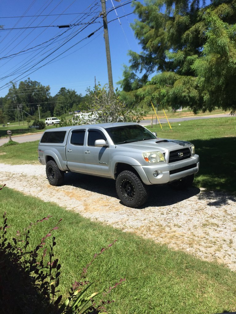

  7. Aug 24, 2017 at 11:34 AM
    #407
    Nimbostratus
    Nimbostratus Well-Known Member
    Jul 12, 2015
    #159333
    749
    Tuscaloosa, AL
    2019 Toyota Tacoma TRD-OFFROAD
    I got the 5100s all the way around, OME 885s, and toytec add a leaf put on this morning along with some 285/70/17 ko2s. Thanks for the help guys and advise guys. IMG_3280.jpg
  8. Aug 24, 2017 at 11:35 AM
    #408
    CamShaft033
    CamShaft033 Well-Known Member
    Mar 29, 2017
    #214762
    238
    Cameron
    Chattanooga TN
    2012 DCSB TRD Sport
    OME 887s, JBA uca, Dakars, Fox Shocks, 285/70/17 Nittos, Dual Flowmaster, ARE Camper Shell w Yakima Rack, CVT Tent, AVID Rear Bumper Guard w LED Pods, 52" Lightbar, Sportsman Seat Covers, WeatherTech Floor mats
    Any rub? I was tempted to go 887s with 285s, but I'll get 885s if it will work.
  9. Aug 24, 2017 at 11:37 AM
    #409
    Nimbostratus
    Jul 12, 2015
    #159333
    749
    Tuscaloosa, AL
    No rubbing at all at full lock up or downhill. No mods other than the mud flaps are off and the method standard wheels.
