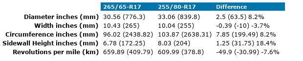

    What is the biggest tire I can run with 5100/885/LR UCA? I really want to stay out of CMC or pinch weld hammering territory. I don't really want to trim anything. 07 dclb trd sport 17"rim. Anybody running 265/70/17 with this setup? Can I see pictures? I'm worried that they would look small with 2.5" lift. Awesome thread!!!

    I have pics of this exact set-up, minus the UCA. Not horribly small, but when I made the jump to 285s I was a lot happier.

    Great looking truck dude! Those are 31.6" tires rigtht? I believe you mentioned in a different thread that you had to do all kinds of trimming including CMC to fit your 285' correct? Do you think you could have gotten away without trimming if you went with LR UCA and played with the adjustable caster little bit? I saw a utube vid of a guy doing it but not sure if it worked for off-roading,he was just turning his wheels on a parking lot.

    Yeah! I did the CMC and hammered the pinch weld before I even mounted them, because I didn't want to mess up my new tires. I may have gotten away without it, but I'll never know for sure. As far as playing with caster, maybe. If you decide to go that route, just be prepared that a CMC MAY be a possibility. Have you ever considered 255/580r17? That's what I'm running and love it.

    I did considered them, u got pics? Would I need CMC for those?

    If you run them with stock wheels, then nope! I have them on my truck right now, and just trimmed a tiny bit of plastic.
    You can also look at my avatar for a good idea.

    Hell yeah, glad I can help! Another perk I forgot to mention is that 255s are way cheaper. Mine were $185 shipped whereas the 285 variation is like $80 more per tire. Downside is small selection.

    Looks like they don't make Duratracs in that size and I really want Duratracs since I drive on the snow about 7 months a year. I did find 255/75/17 Duratracs for $138 a piece so we might have a winner!
