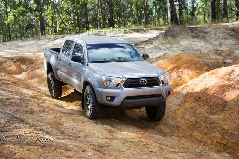

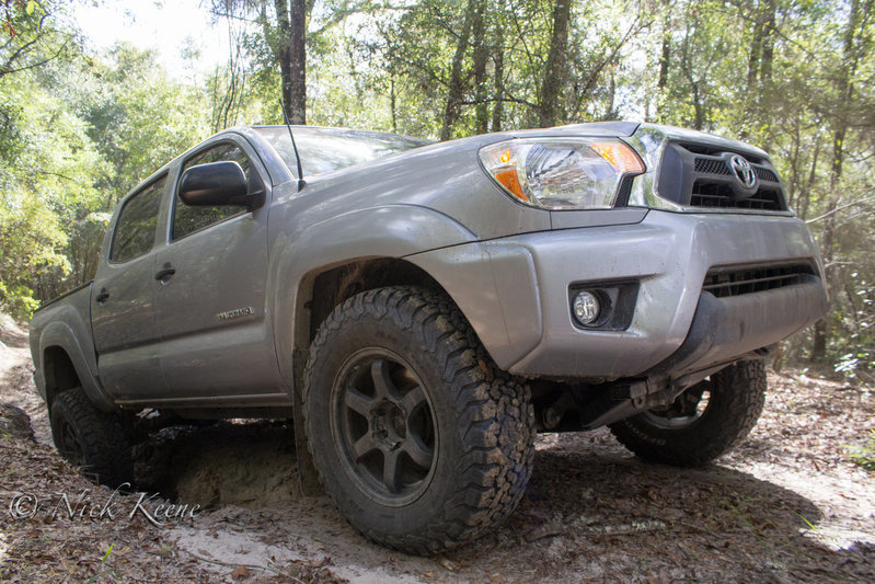

    14' DCSB offroadsport-sold =2005 T4R V8
    Bilstien 5100@ 0, OME 885(+10 mm drivers side spacer for taco lean, 5mm passenger), b110 rears w/ allpro standard leaf pack, wheelers ubolt flip, superbump bump stops, extended brake lines steal braided(front and rear), Dick Cepek extreme country 305/65/17 tires on FN six shooters=17x8, street tires are 285/75/16 duratrac w/FN countersteer type X= 16x8, a healthy cab mount chop, SPC LR UCA's, TC cam tab gussets, Wet okole seat covers, husky x-act fit floor liners, SOS aluminum front skid, SOS mid skid, SOS sliders (bolt on), ECGS bushing for needle bearing, uniden PRO520XL cb. BAMF tailgate antenna mount, 4' firestick, A.R.E. Z series camper top, Factory roof rack, Pioneer avh-5800x head unit. Front and rear anytime cameras, Rear diff. Breather relocate. 42" highlift. Tow straps/All-PRO snatch strap, tow hitch w/D-ring, traction pads, Tacoma bed mat, Rago Fab ditch light brackets with jap special light pods
    Here is a did bit of info for you, lift does not make a tire fit unless your talking 4+ inches and you don't wheel your truck, even people fitting 35s have to do the same amount of trimming due to the wheel stuffing into the wheel well when soaking up bumps or articulating. Even aftermarket springs and shocks still compress as much as the factory ones do when under load, this pick is when i was on 265/70/17 on 885s not even at full compression just for reference downloadfile-8.jpg downloadfile-7.jpgAnd at normal height
    Only pics I have left on 265s
    Catfish21 likes this.
