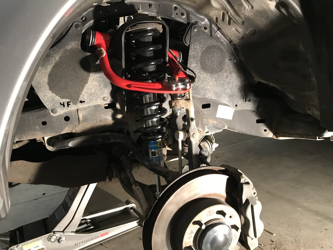

    Received my 5100/885/Deaver aal Kit from HeadStrong Off-Road this week and installed it tonight. I definitely regret not getting the new top mounts preinstalled from HS. Along with them I got the JBA High Caster UCAs because I prefer the non adjustable arms. I have no measurements just pictures but I’m thoroughly pleased with the setup!

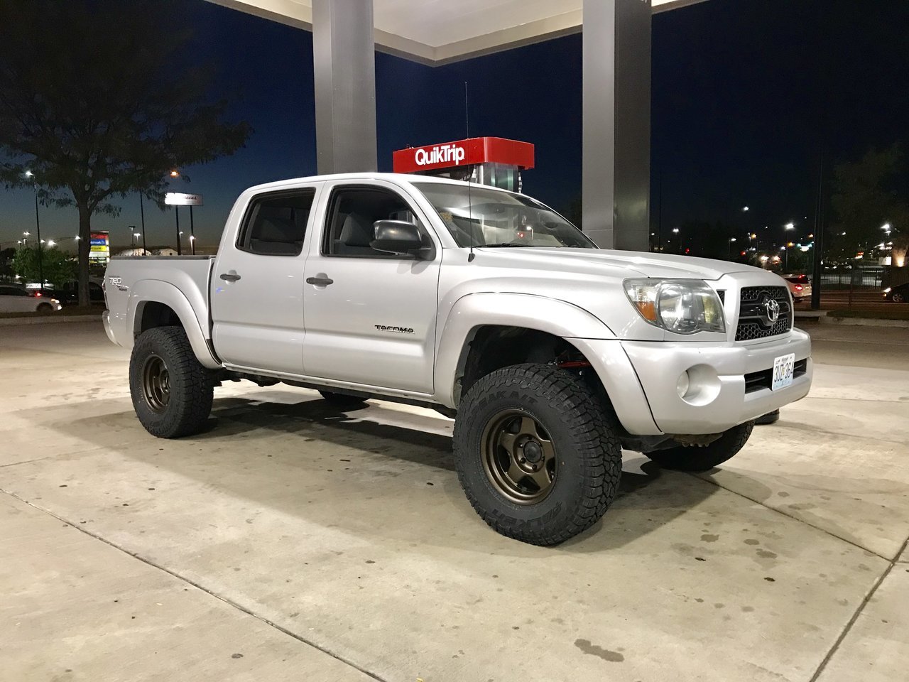

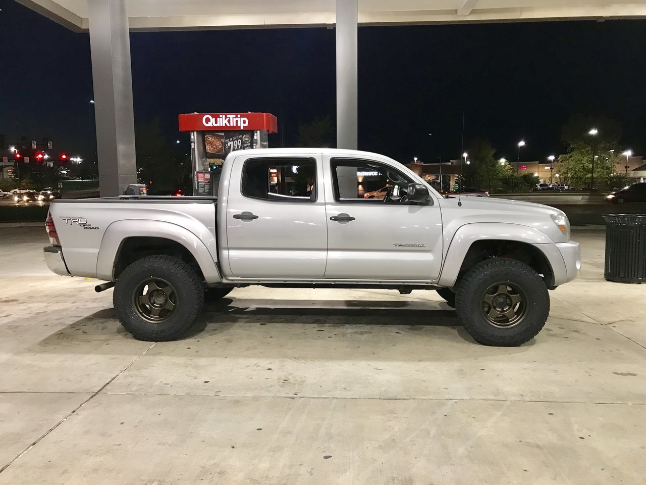

    5E40156D-EC26-4183-9158-5CBD1C770F5A.jpg E93DC69E-D08B-4929-A62B-29181532F36C.jpg Installed my wheels and tires tonight
    16x8 3.5bs
    285/75/16 Wildpeak AT3W
