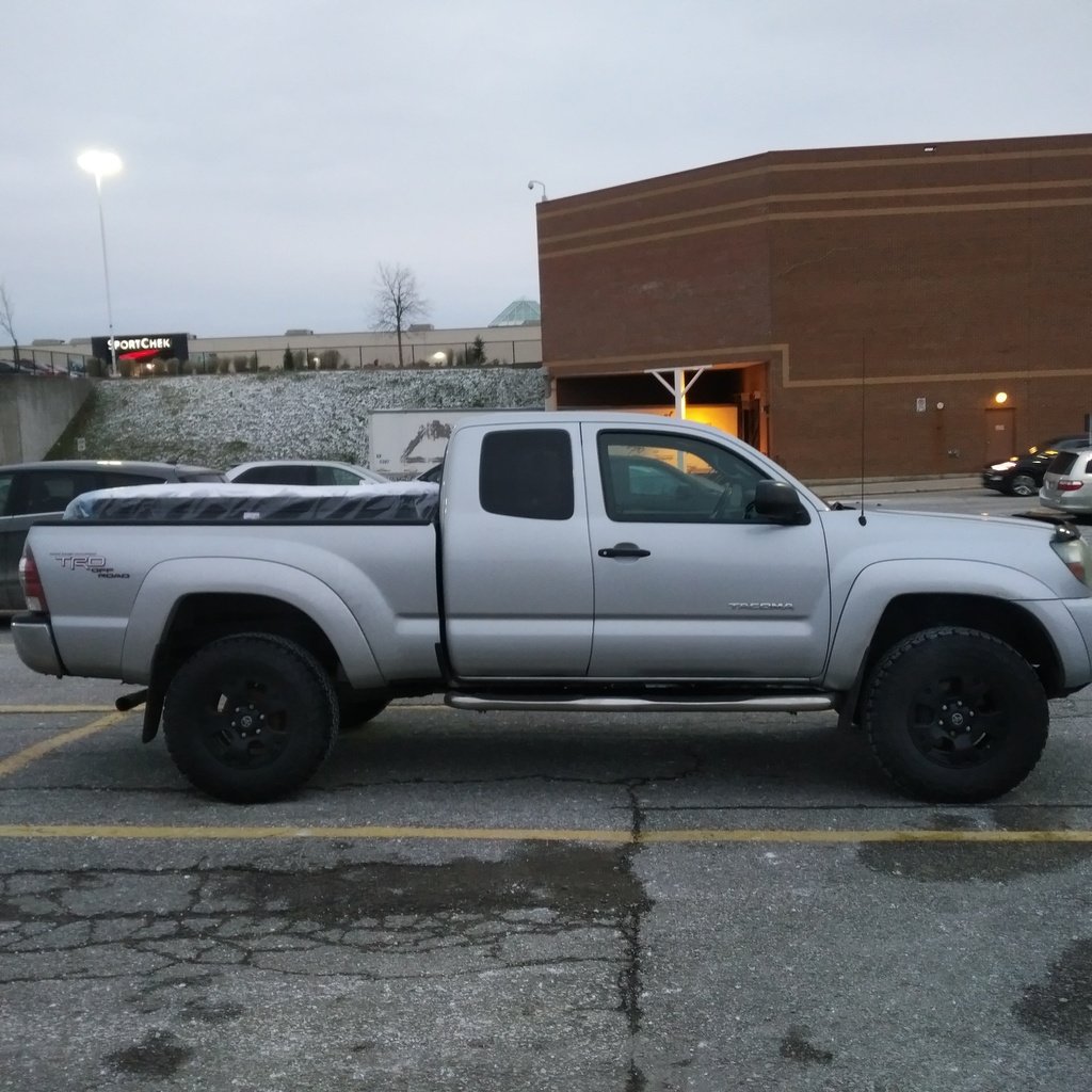

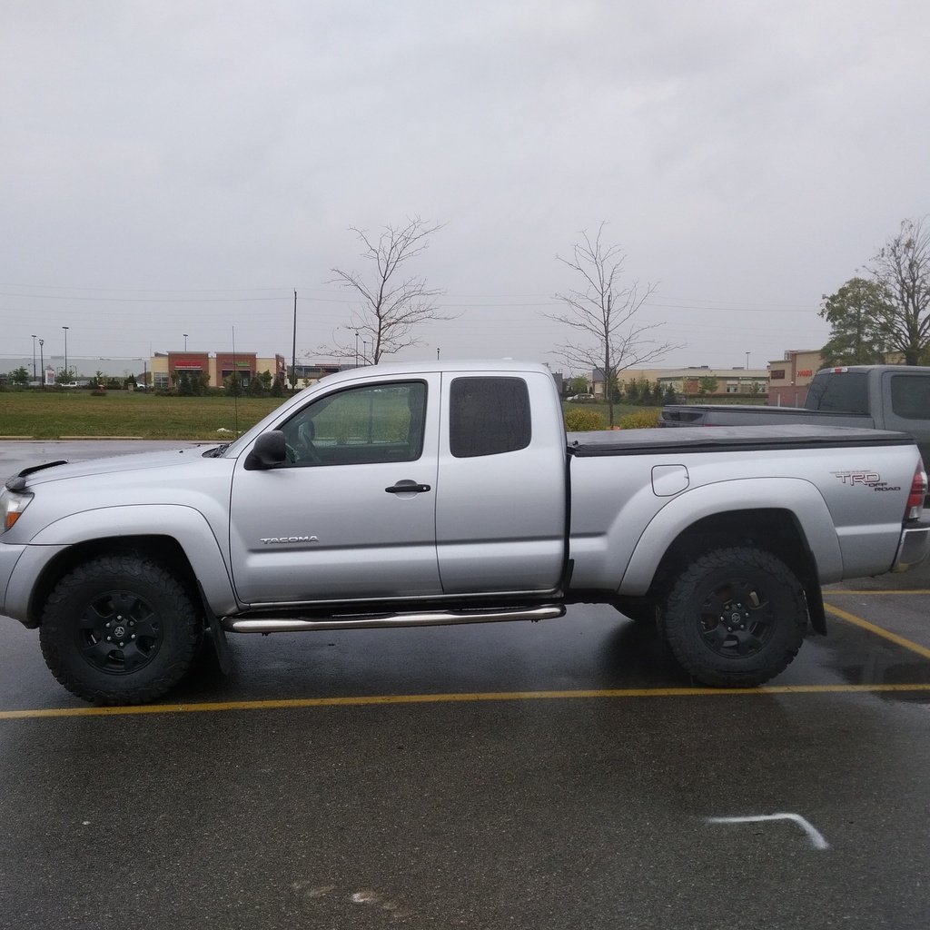

  4. Nov 30, 2017 at 9:12 AM
    #564
    HipHead
    HipHead Well-Known Member
    Sep 23, 2011
    #64003
    78
    Jeff
    Gilford, Ontario
    09 Access Cab V6 4L 6 Speed TRD Off Road
    Weathertech bug deflector, Uguard side step, tri-fold tonneau cover, Weathertech floor mats
    OME 885
    Bilsteins 5100 X 4
    TC UCA
    Rear springs - heavy duty
    39" front and back
    Before
    After

    Did you have any issues with the dust covers on your tc ucas? When I got mine, the dust covers were off and ripped when I tried to put them on. Or did you get uniball? Brw truck looks great

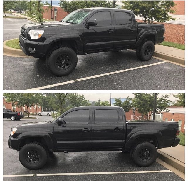

    This is what I originally started with, just the 5100s upfront set at 1.75 and it must be the lines of the truck, but it looked a bit nose high to me. I ended up putting 1” blocks in the rear and it looked completely level, when I measured though, the rear was .5” higher than the front which I was happy with. Go measure from the center of your wheel to the bottom of your fender on all 4 corners. That will give you an idea where 1.74” more will put you in reference to the rear. Make sure you do it on level ground. Also, it will tell you if you have taco lean or not. Some trucks have it, some don’t. If you don’t and you re use your stock coils, you won’t have it when you level it. The stock coils are driver side and passenger side specific to make up for it so when you do level it, don’t mix them up if you end up using the stock coils. I didn’t notice my lean until I swapped my stock coils for ome ones and had to get a spacer to fix it. Hope this helps. I’ll see if I can track down a pic of mine with the blocks and 1.75” up front. Sorry no pics of just the 1.75” up front.

    The top pic and my sig pic are of my truck with the 5100s set at 1.75” and a 1” block in the rear.

    Thanks. There are dust covers but not at the top where grease fitting is located at bearing. I will try to get a picture. Not uniball.
