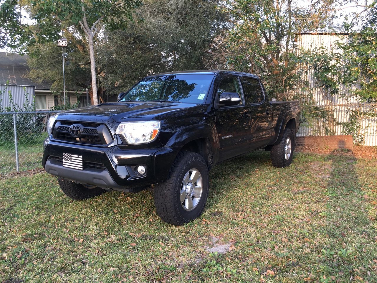

    NC
    2019 TRD Sport 4x4 DCLB
    That looks really good and subtle. What tires are you running?

    Spiker
    Louisiana
    2014 Tacoma TRD Sport DCLB
    255/80/17 Cooper stt maxx
