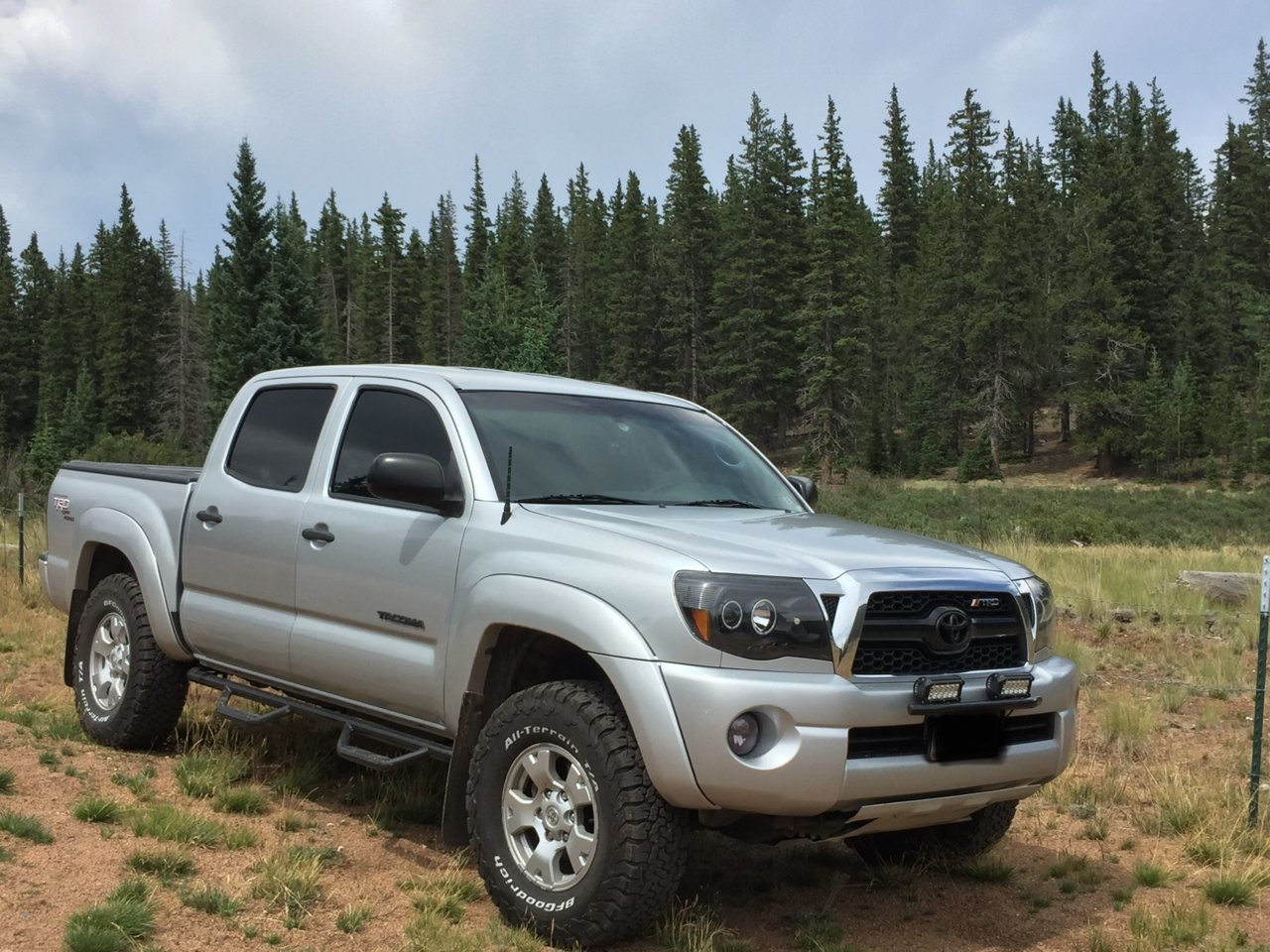

    Looked through a lot of this thread and have a 2010 DCSB. Have 5100s at 1.75 stock coils and TSB leaf in back. So definitely liking the 885 idea with 1/4 taco lean spacer.
    Rear seems to be about .25-.5” higher right now. What would y’all recommend for the rear?
    Also, thoughts on 1/2 spacer on driver and 1/4 on passenger with 885s? Think I’d need a UCA upgrade?
