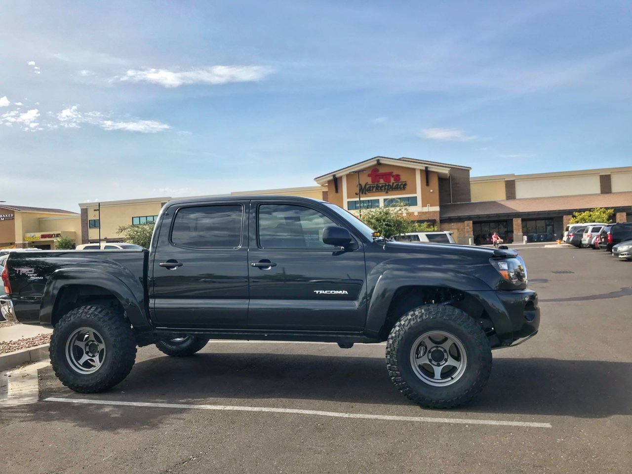

    https://www.tacomaworld.com/threads/singletrack’s-‘dad-shred-build-thread’-i’m-just-doing-it-for-the-kids.619250/ Sos offroad sliders (kickout + filler) Sos offroad full belly skids (steel) Sos offroad front recovery point Sos offroad concepts HC rear bumper with bedside kickout tubes Marlin Crawler LCA frame brace kit Trail Gear rear diff cover Bilstein 5100 + OME 885 Total Chaos UCA BILSTEIN b110 OME Dakar standard pack Wheelers Ubolt flip kit Wheelers Superbump f/r Wheelers SS extended brake lines FN five star 16x8 -25 Milestar Patagonia MT 315/75r16 Custom projector retrofit (acme super h1 + morimoto 4300k) Baja Designs S2 sport ditch pods on CBI ditch pod mounts Amazon AMAK rock lights CMC CB radio hardmount
    Yup. 885 + 5100’s set to 0 lift and a single 1/4” poly strut top spacer on drivers side only gives a perfect lift IMO. UCA very likely not needed but I did some anyway because my UBJ were looking tired and I wanted to dial in my castor to clear the beefy tires and aggressive -25mm wheels. The ride quality of the 5100 + 885 is fantastic on and off road.

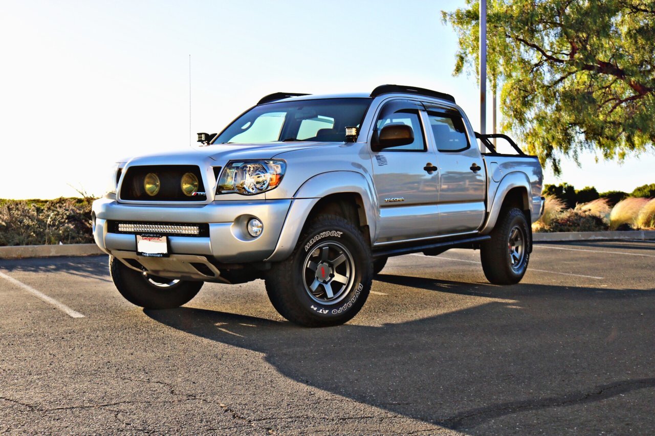

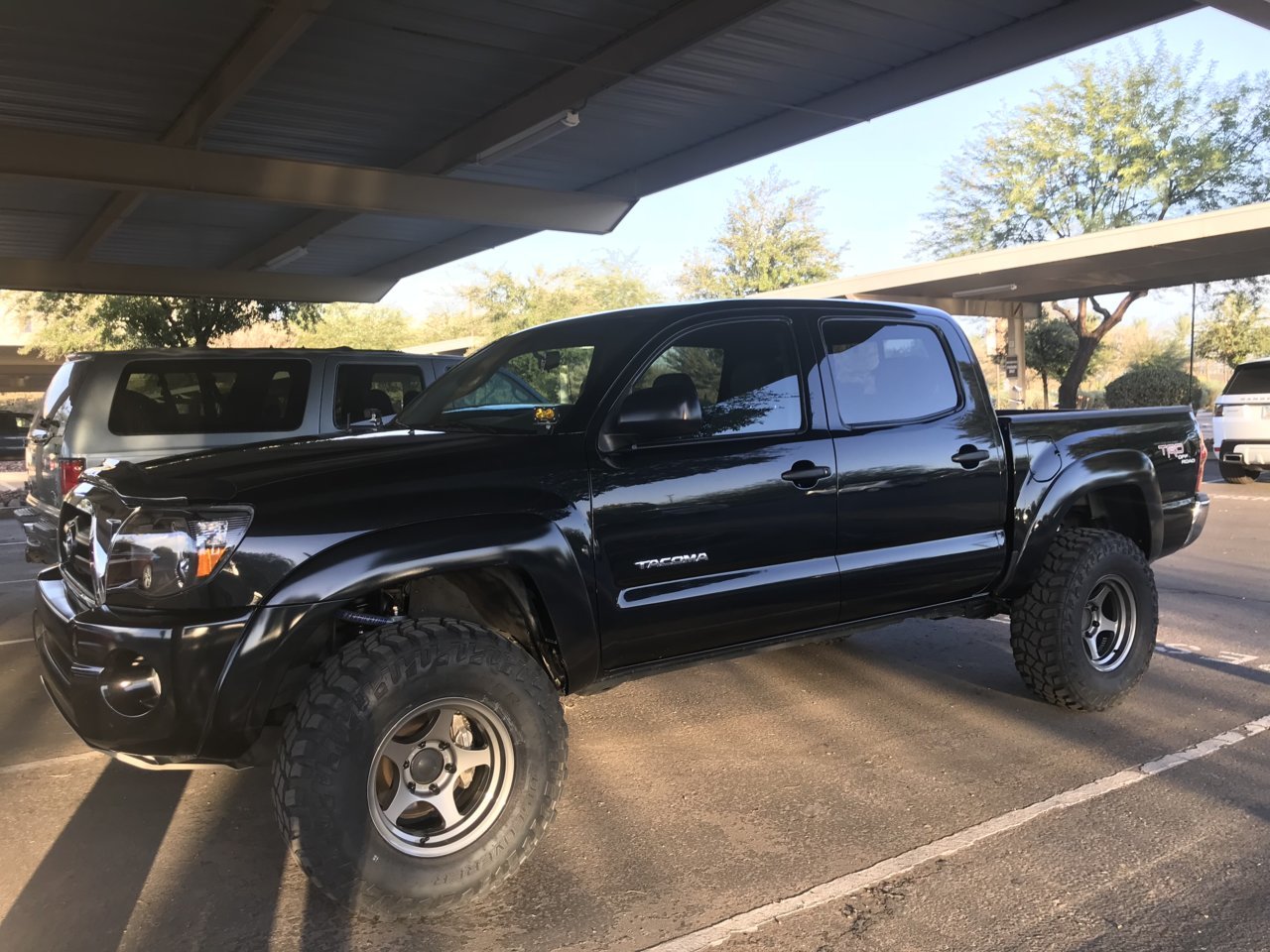

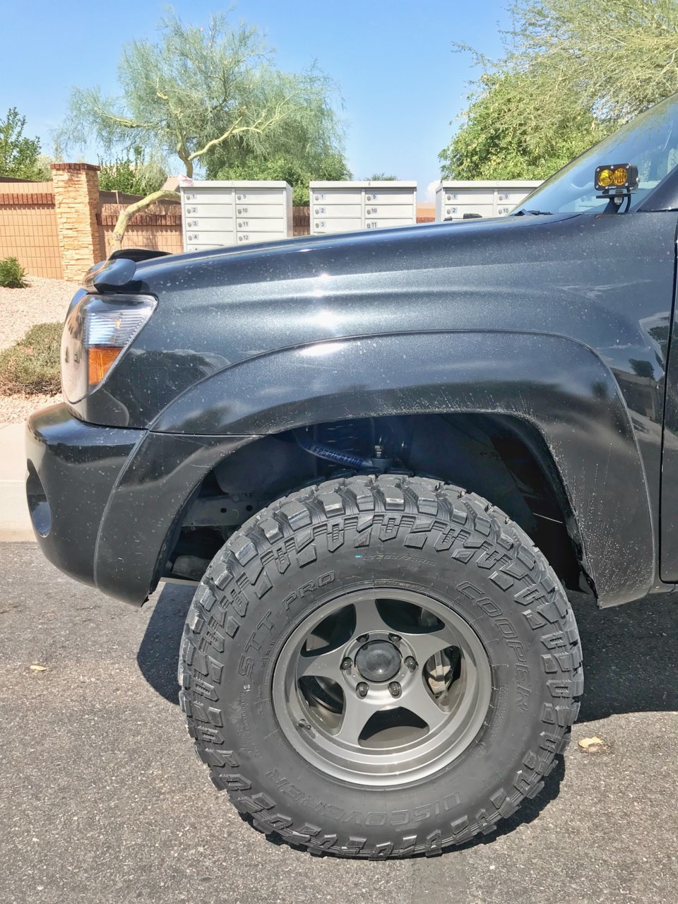

    Sounds like I’m set then!!! 885 with 1/4 driver. Done. I like the way your rig looks though, got a closer picture?
    Dude. Looks fantastic. Good work.
    But. How you gonna let the jeeps lead the pack eh? Lol

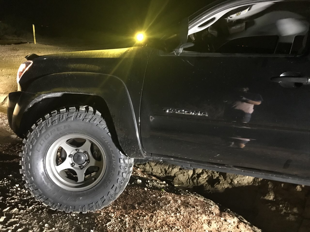

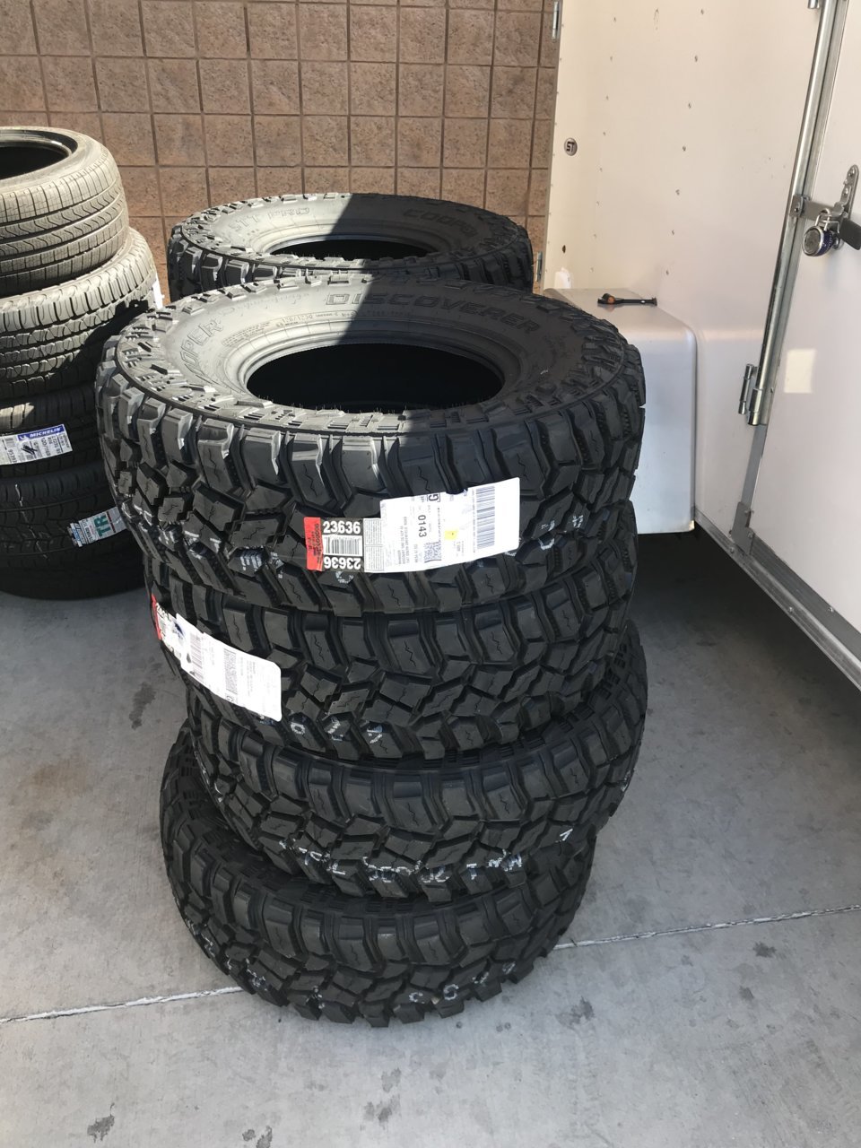

    Are those cooper MTPs? I feel like I should know because I'm currently running MTPs.....

    Thanks.

    What a beaut. Gotta get me the roof racks someday, love that look. Thanks for the help!

    Negative. They’re cooper STT Pro’s and I love them very much!

    Gotcha! I thought they had a different tread pattern. Similar to the mtp which is why I asked.

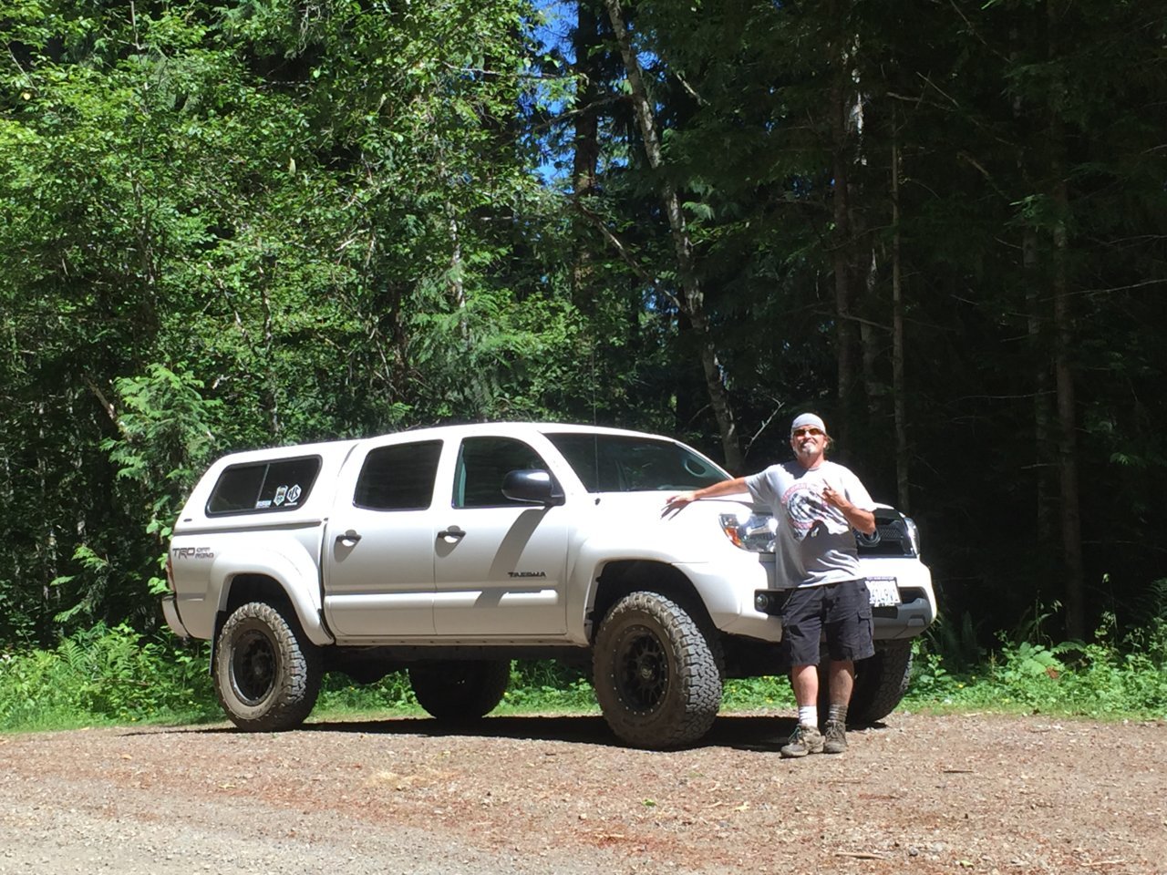

    I did a BMC and put ICON Alphas on and BFG 285/70/17's. No rubbing,no issues.

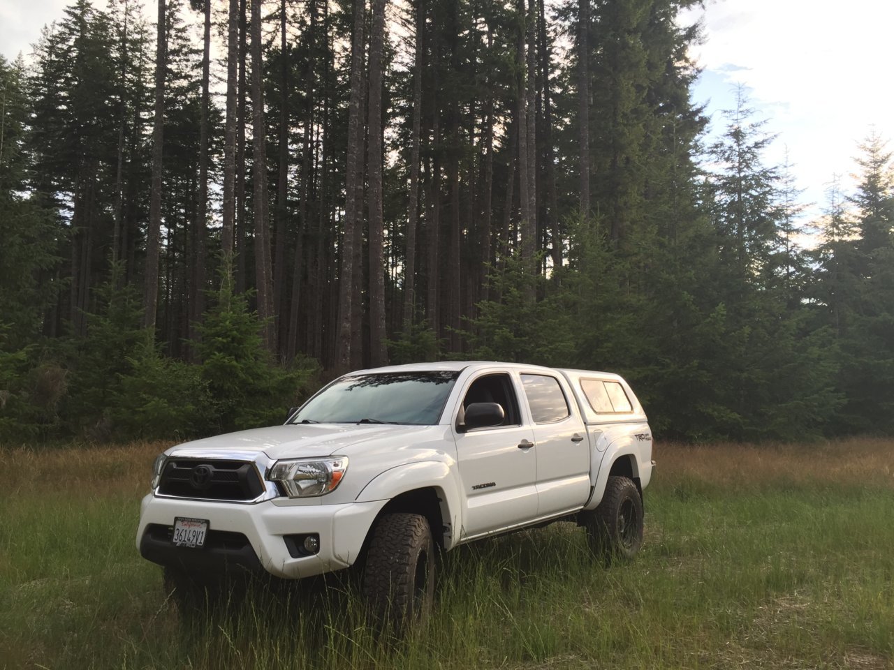

    Anyone running 285/75/16 BFG KO2 with the Bilstein 5100/885OME w/an add a leaf?
    If so, can you post a pic please, I'd really appreciate it!
    My rig is currently running these tires on stock suspension but the previous owner apparently was lazy with the rotations- 2 are cupped 2 are worn on the outside a bit. I would really like to keep this size so I can use the best of the four as my spare. My concern is whether this size will look "proper" with this lift.

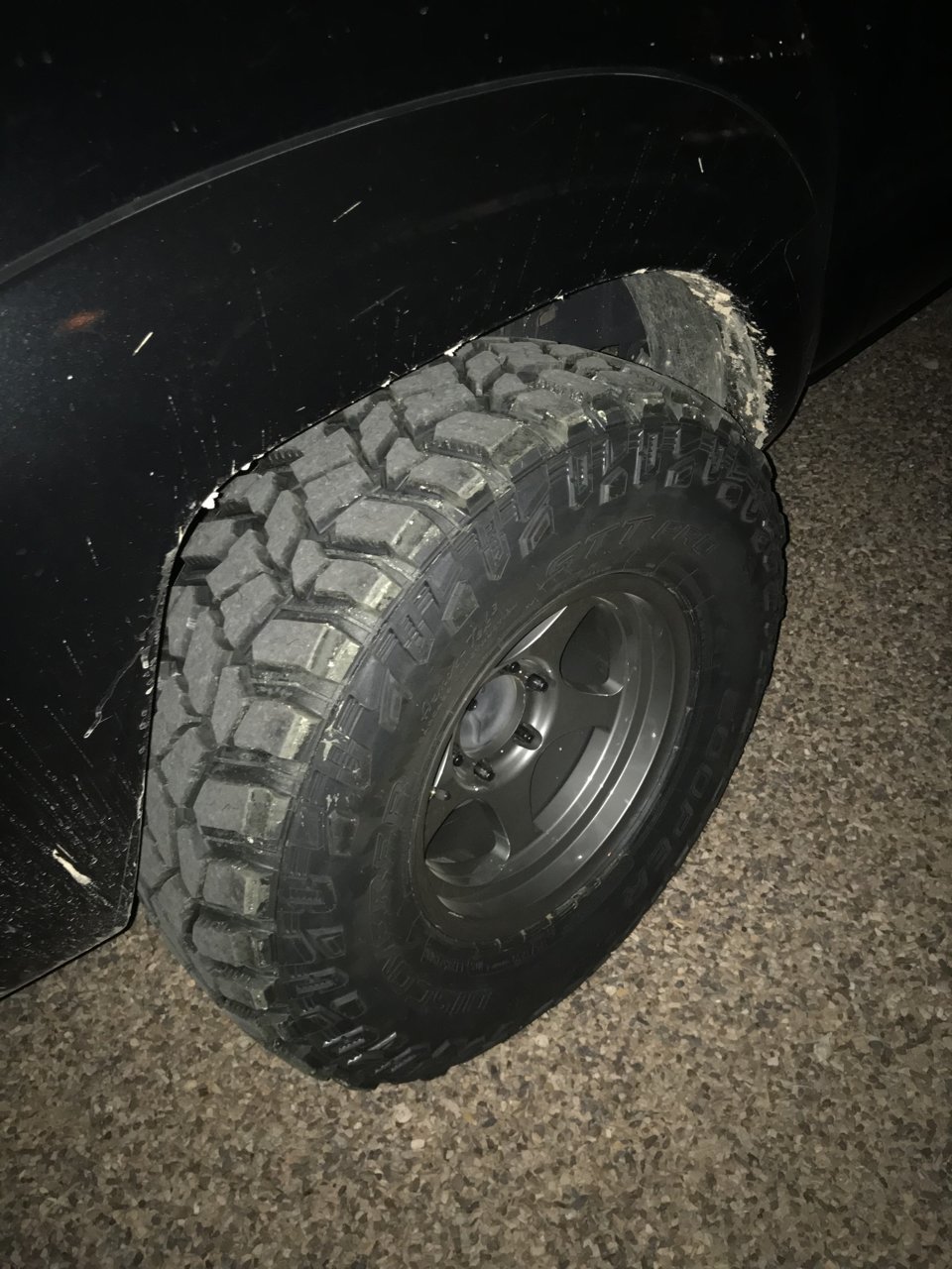

    These are 285/75r16 Cooper MTPs, but close enough. This with the 885/5100 and an AAL
    14231186_10157346425145092_8662295848883_86e8db8a69dbf28e9c44fd633f7b09d7a93b1f96.jpg

    Thanks! Nice rig!
