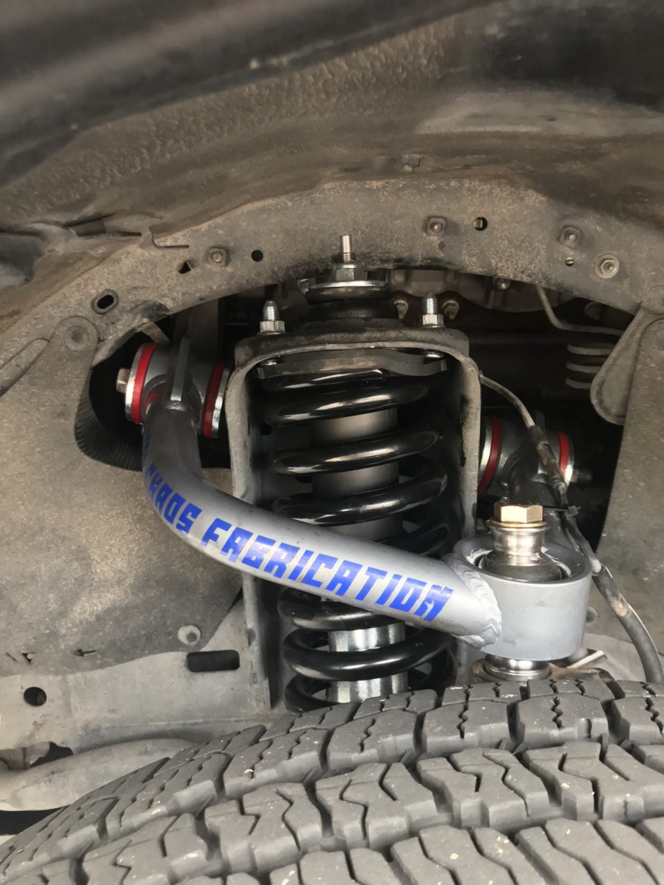

    https://www.tacomaworld.com/threads/singletrack’s-‘dad-shred-build-thread’-i’m-just-doing-it-for-the-kids.619250/ Sos offroad sliders (kickout + filler) Sos offroad full belly skids (steel) Sos offroad front recovery point Sos offroad concepts HC rear bumper with bedside kickout tubes Marlin Crawler LCA frame brace kit Trail Gear rear diff cover Bilstein 5100 + OME 885 Total Chaos UCA BILSTEIN b110 OME Dakar standard pack Wheelers Ubolt flip kit Wheelers Superbump f/r Wheelers SS extended brake lines FN five star 16x8 -25 Milestar Patagonia MT 315/75r16 Custom projector retrofit (acme super h1 + morimoto 4300k) Baja Designs S2 sport ditch pods on CBI ditch pod mounts Amazon AMAK rock lights CMC CB radio hardmount
    If you are so keen on travel and down travel, remove your sway bar. I guarantee you your front suspension with 885/5100 and total chaos without a swaybar will give you plenty of “droop”. In fact.. possibly more droop than a guy who has $1500 extended travel KING coiloversWITH his swaybar still attached. As mentioned, mid travel or extended travel is an extra .5 inches. Long travel is where you gain extra inches and it’s a very very very costly endeavor.
