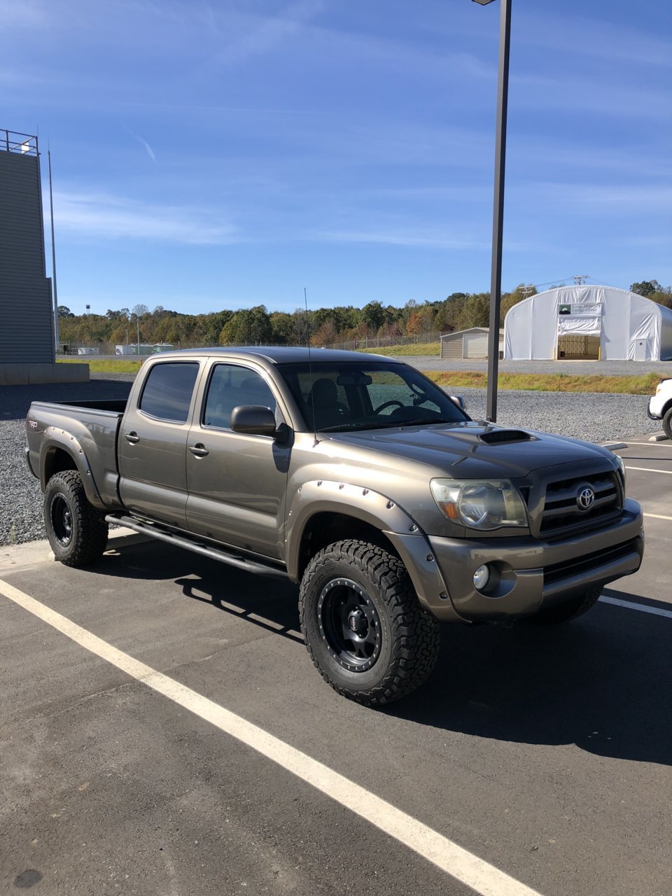

    So I finally got around to installing 885s and 5100s on the truck. I was replacing about a 3” spacer lift with what I believe to be the factory shocks with about 150,000 miles on them. Install went great and truck looks great, but now my 285s rub where they did not before. I believe it is on the very edge of the front and back of the wheel wells. Could it be due to my bushwhacker flares? Just a side by side comparison, it looks like they might possibly take up a little more room in the well than a factory flare would. Can anyone verify this?

    Did you do the classic 33's and plus trimming to body mount, pinch weld, and plastics?

    I bought the truck with 285s and a spacer lift on the factory shocks. It rode like shit but I dealt with it until I got the 885s and bilsteins. I never had a rubbing issue with the spacers, even off road. Now I rub just backing out of a parking spot. I believe I’ve narrowed it down to only rubbing on the flares, so I’m hoping maybe a switch back to the factory style flares might help. I understand I’ll probably still have to trim some, but just going by the rub marks on the bushwackers I don’t believe I’ll be able to trim where the rubbing is occurring on them.

    You know something crazy? I too bought my truck with 285/65/18’s on 18x9 0 offset awful wheels & a spacer lift. The truck did not have a CMC or aggressive trimming. I went to a 285/75/16 on a 16x8 -25 and I have more rubbing than you can imagine. Every wheeling trip I end up chewing up my tires because I have more to trim. And my CMC is HELLA aggressive and beveled. I realize my -25 offset is what’s the most aggressive but I couldn’t believe that my truck had no rubbing on 285/65/18 and spacer and then after I did ALL real suspension and TC UCA the rubbing was awful and worse but I know my wheels and tires are to blame

    Figure out where it’s rubbing, grab a knife with a fresh razor blade, and go to town. Shouldn’t have to trim much.

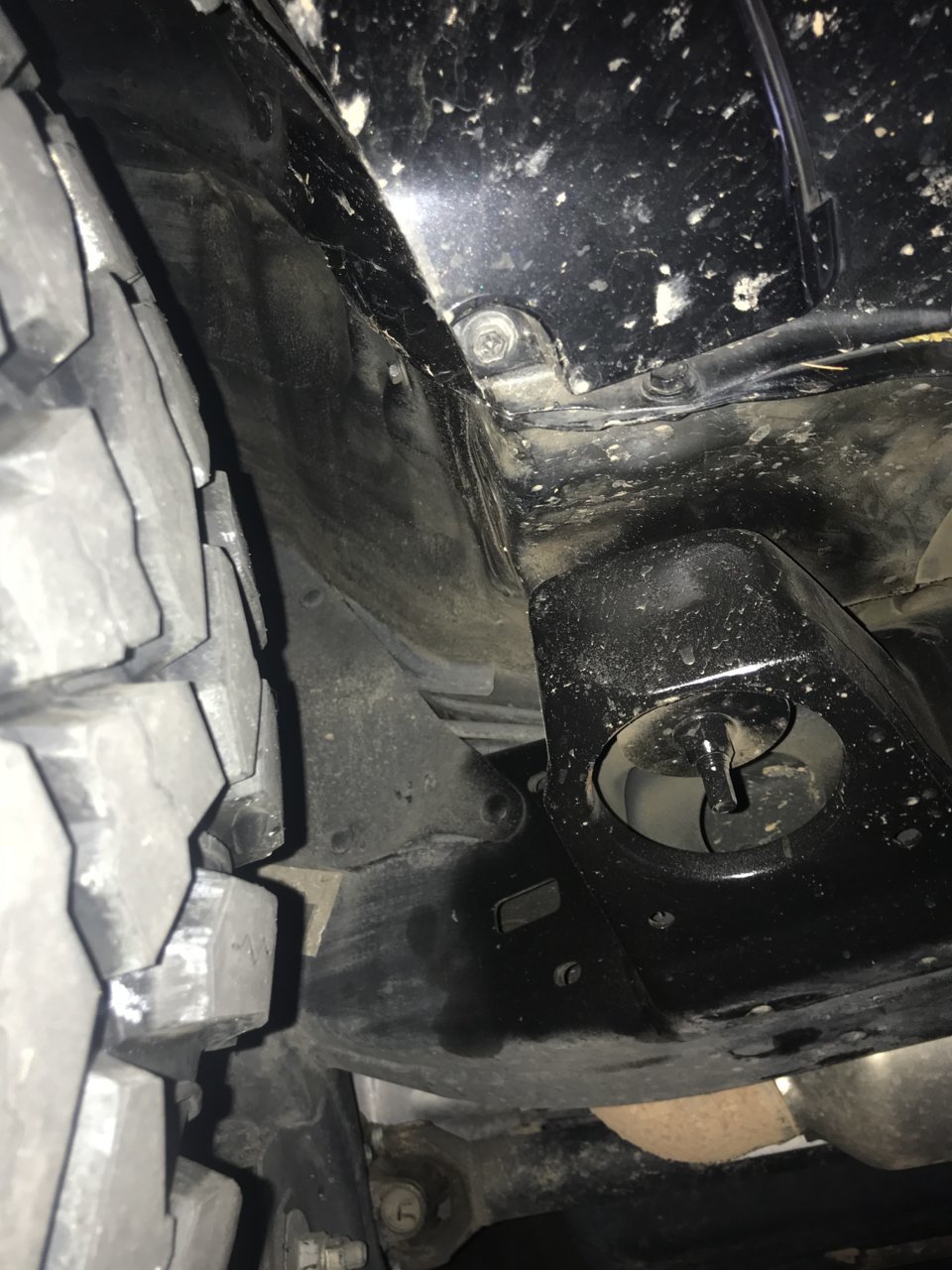

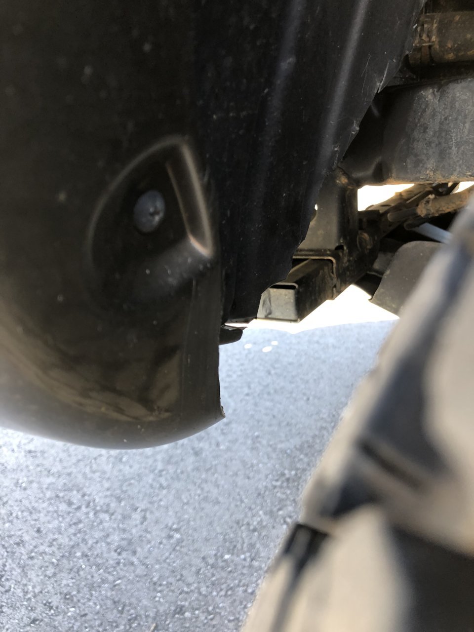

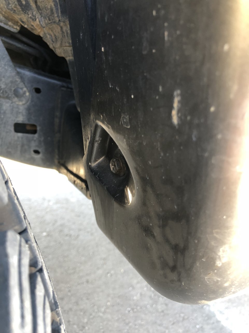

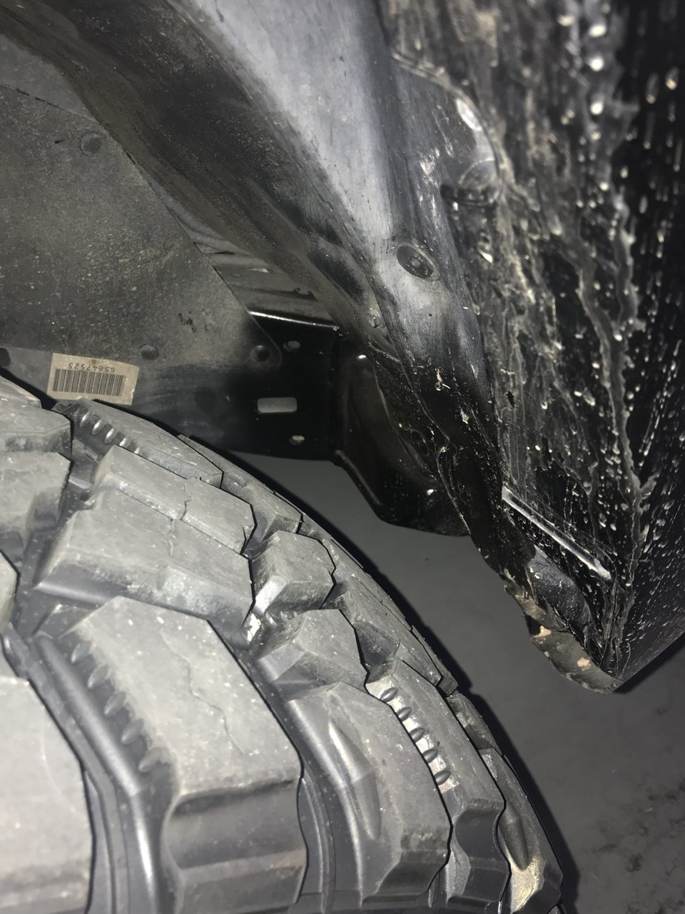

    There are definite similarities here lol. I will say that my wheels do not have quite as an aggressive offset. I haven’t got to take my truck off road yet, but I’m sure it’s going to be bad.
    Good news is I don’t think that I’m going to have to trim as much as I first thought. I snapped these pictures earlier of the areas I am experiencing the rubbing. I believe I’ll be able to at least take care of the issues I’m having on black top.
    It might be tough to see, but there are rub marks below each bottom mounting bolt.

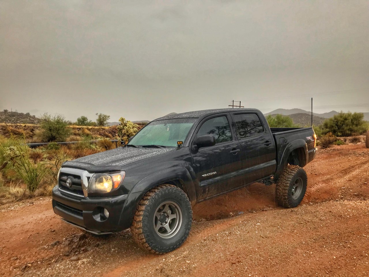

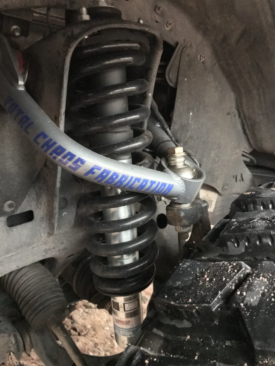

    Here’s mine and it’s sill a work in progress
