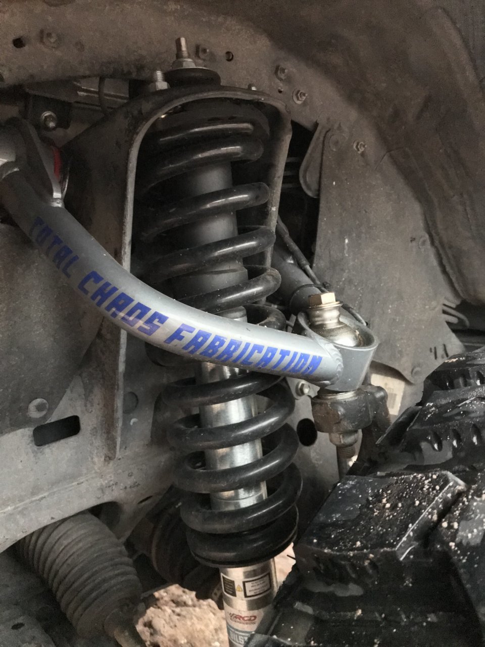

    I did not have that issue with my setup running TC UCA but I currently have my swaybar removed. At full droop, my UCA will hit the coil. Only happens at like 2mph anyway hahah

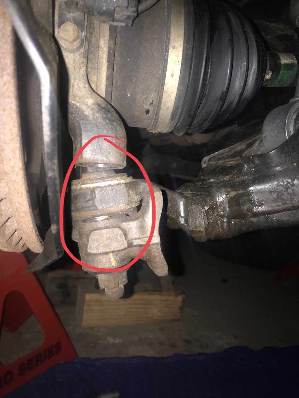

    Did anyone have any issues bolting the LCA back to the steering knuckle after the shocks were in? Using the bottle jack and not closing the distance before it starts to come off the stands. Coil compressor...?D7BFB6A4-405E-445B-A42F-A4AFAEA27F8C.jpg

    I usually stuff my floor jack under the LCA and go up until the holes line up.
