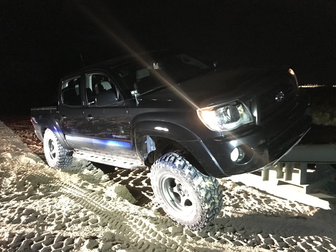

    they are 5100 billys with OME 888 and a half inch spacer on top. the rear are 5160s with 2in AAL and 2 inch drop brake lines. Sorry its been a bit I have been at work.

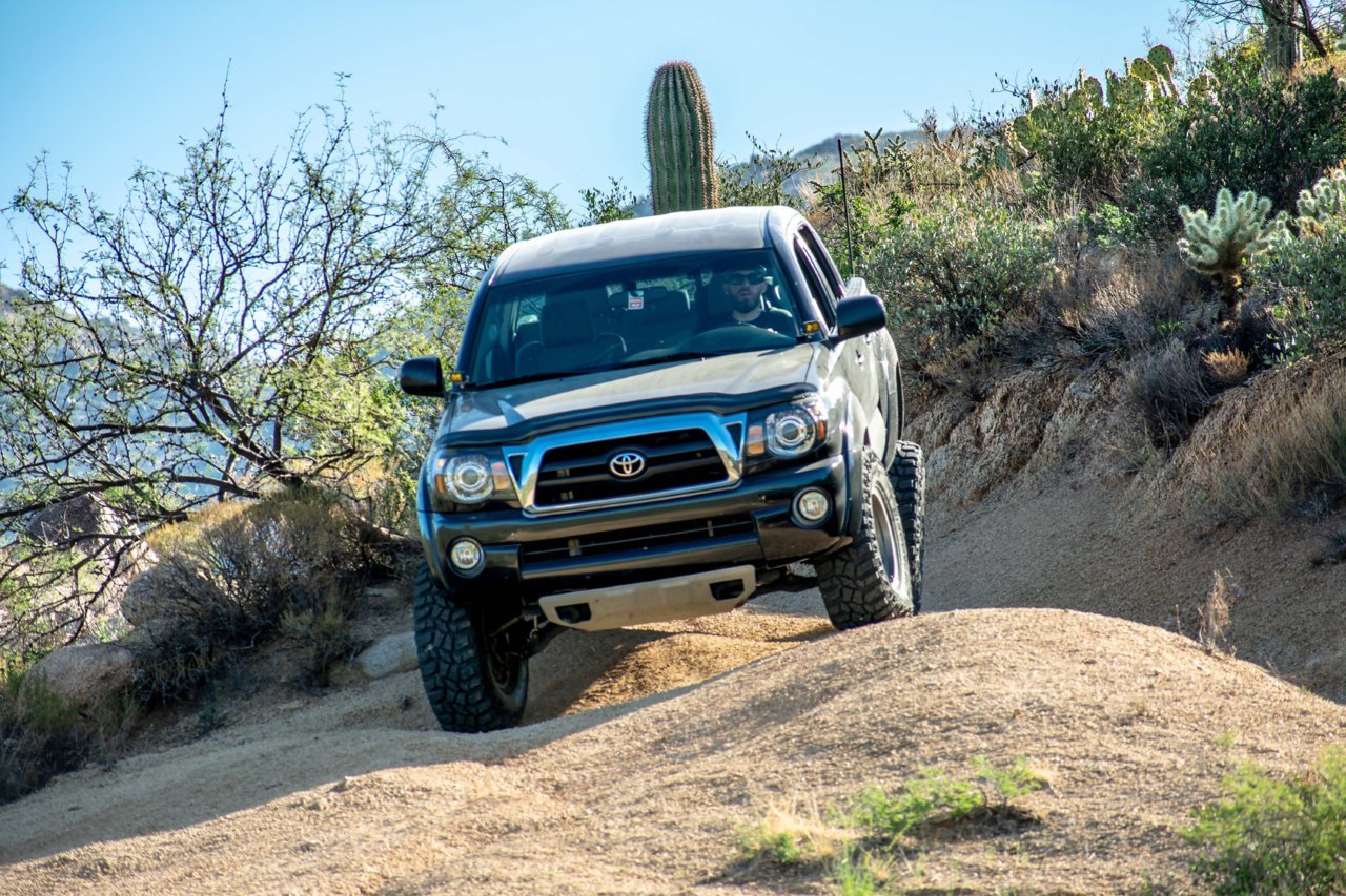

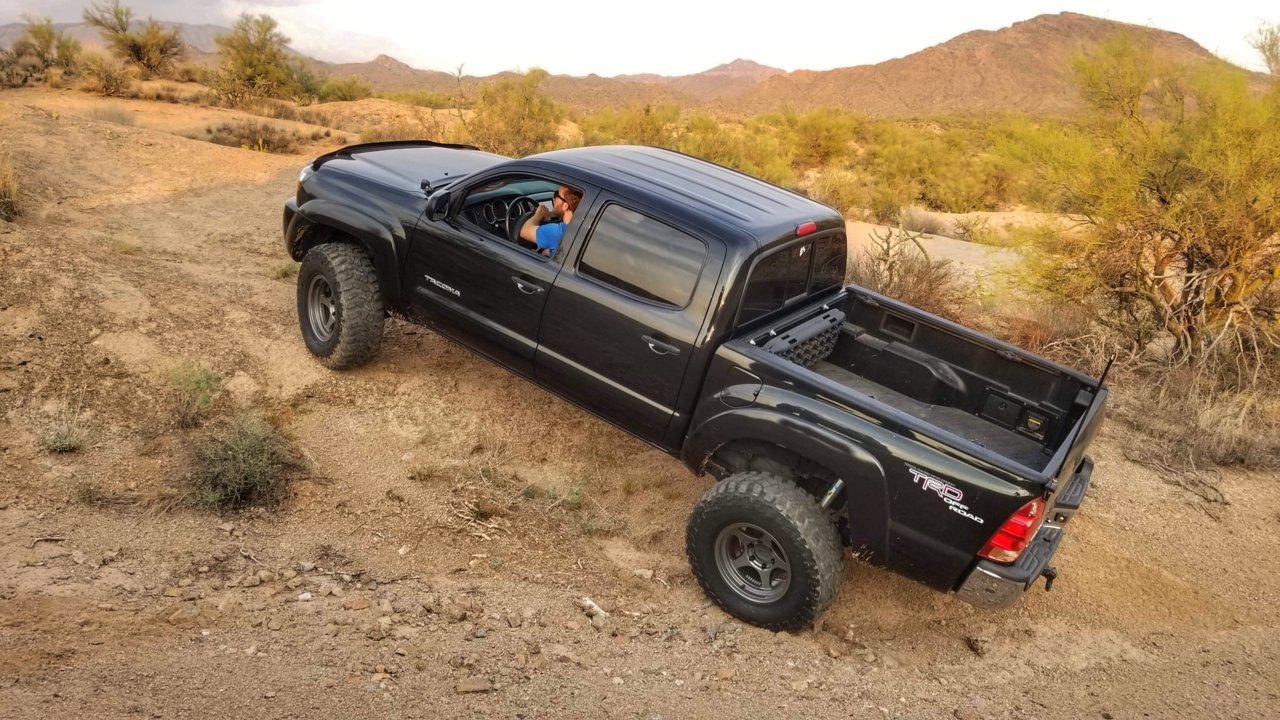

    Bilstein 5100 + OME 885 Total Chaos UCA BILSTEIN 5125 extended OME Dakar standard pack Sos offroad sliders (kickout + filler) Wheelers Ubolt flip kit Wheelers Superbump f/r Wheelers SS extended brake lines FN five star 16x8 -25 COOPER STT PRO 285/75/16 Custom projector retrofit (acme super h1 + morimoto 4300k) Baja Designs S2 sport ditch pods on CBI ditch pod mounts CMC CB radio hardmount

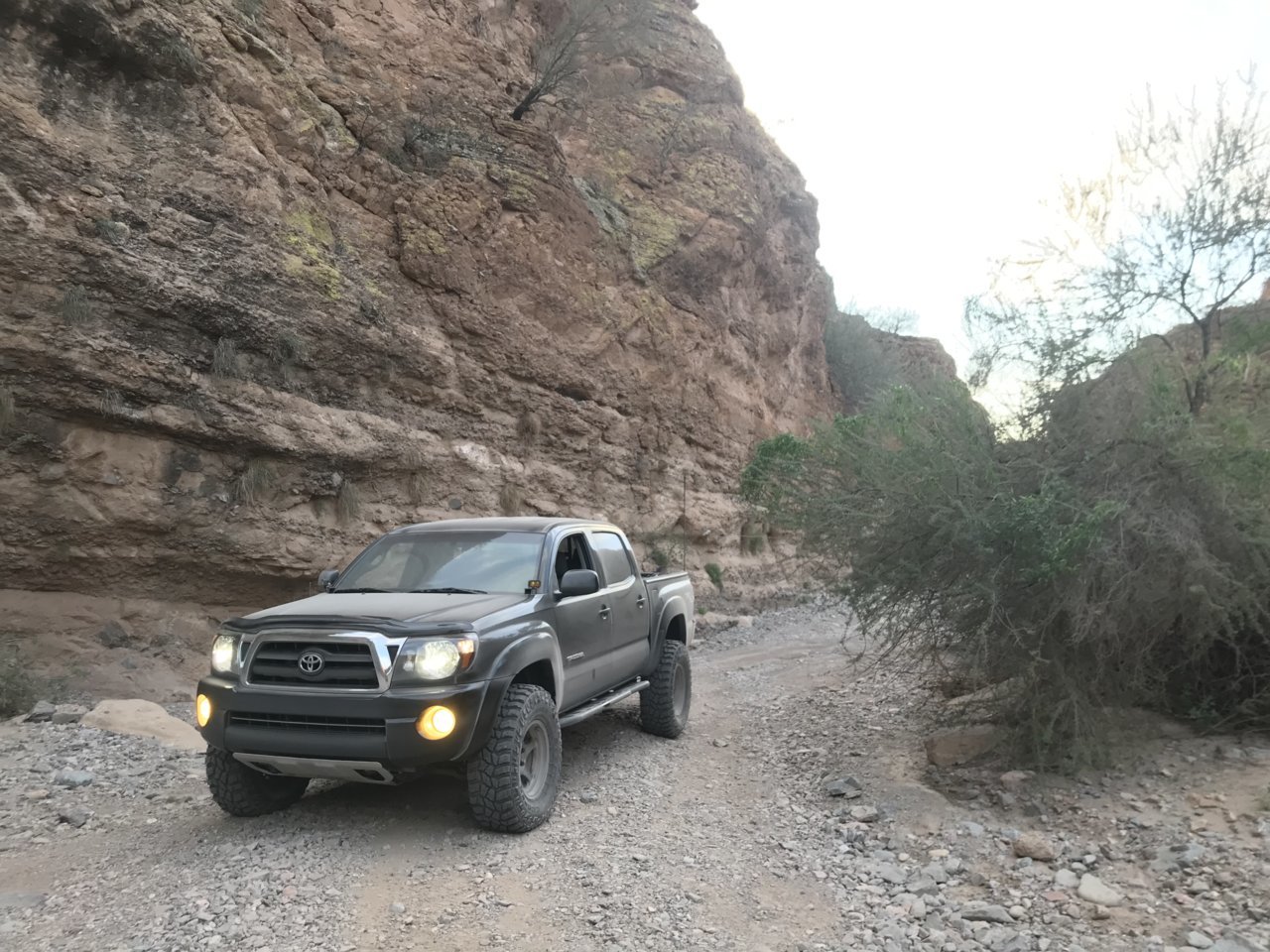

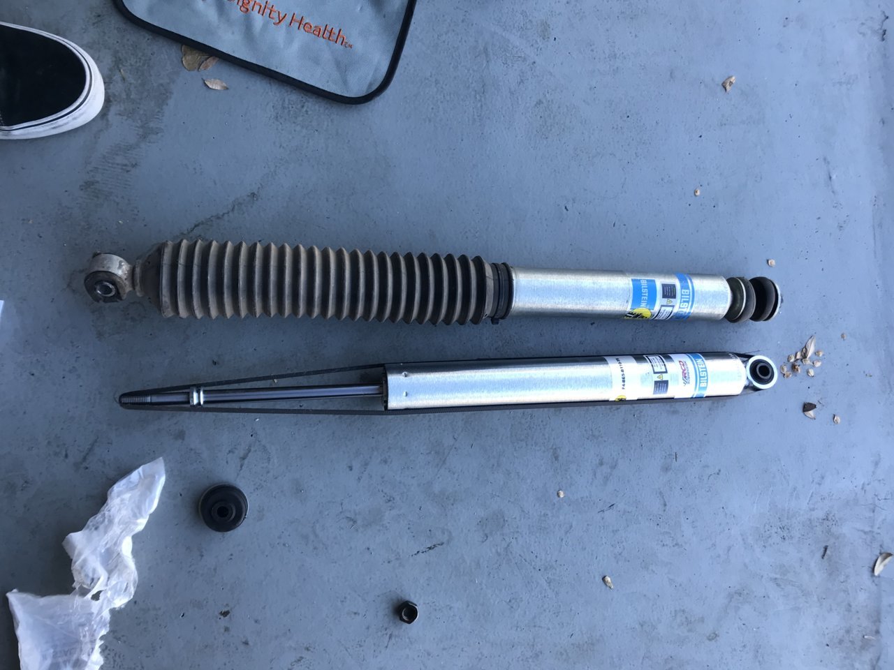

    Right on. Sounds like some very well thought out upgrades! I actually just swapped out my 5125’s for b110. The b110 is 3 inches longer than the 5125 and is actually about the longest bolt in factory shock replacement you can buy. Loving them so far but I haven’t had the opportunity to stretch them out. They actually do seem a little smoother on and off road already. That’s probably all mental but I do think they are.

    Update: my 885+5100 combo has been rocking steady and strong. Loving this setup especially without the swaybar.

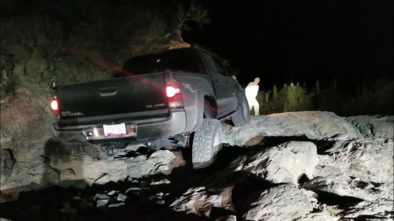

    Incredibly capable. Thank you! I barely lift a tire off the ground anymore & I can’t wait to see how planted this is with the much longer b110 shocks in. I haven’t taken them out for a shakedown yet.

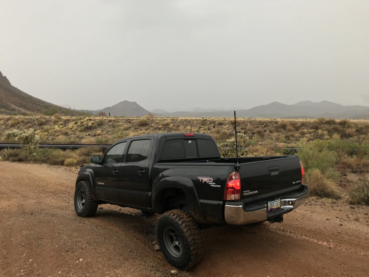

    Rear is a Dakar standard duty pack with 5125’s (just swapped out for b110). No swaybar, yes VERY aggressive CMC. 16x8 -25 offset wheels on 285/75/16 STT PROs

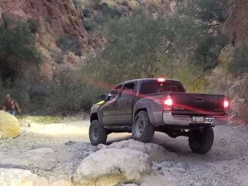

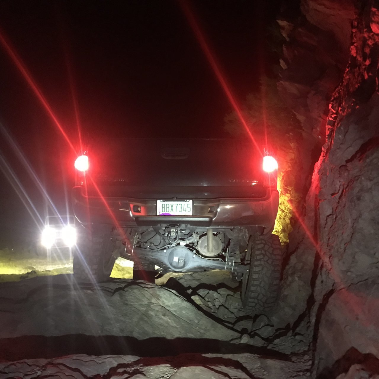

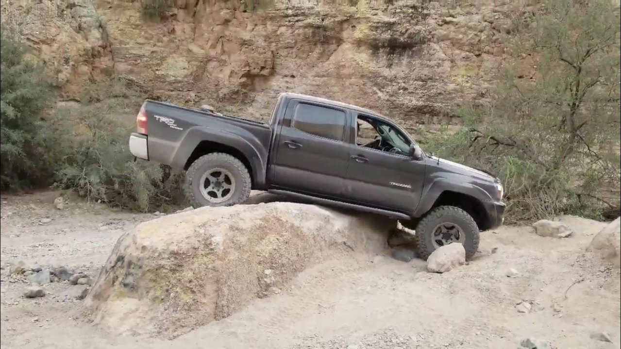

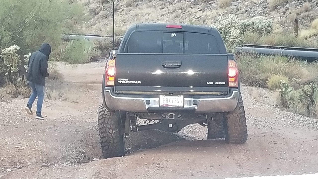

    Couple more shots of 885+5100 stretched out without a swaybar.

    It’s time to fork out the cash and ditch my AAL and 5100’s for dakars and b110’s. After seeing your setup I’m running the exact same specs for wheels, tires, and lift up front. Your flex is insane

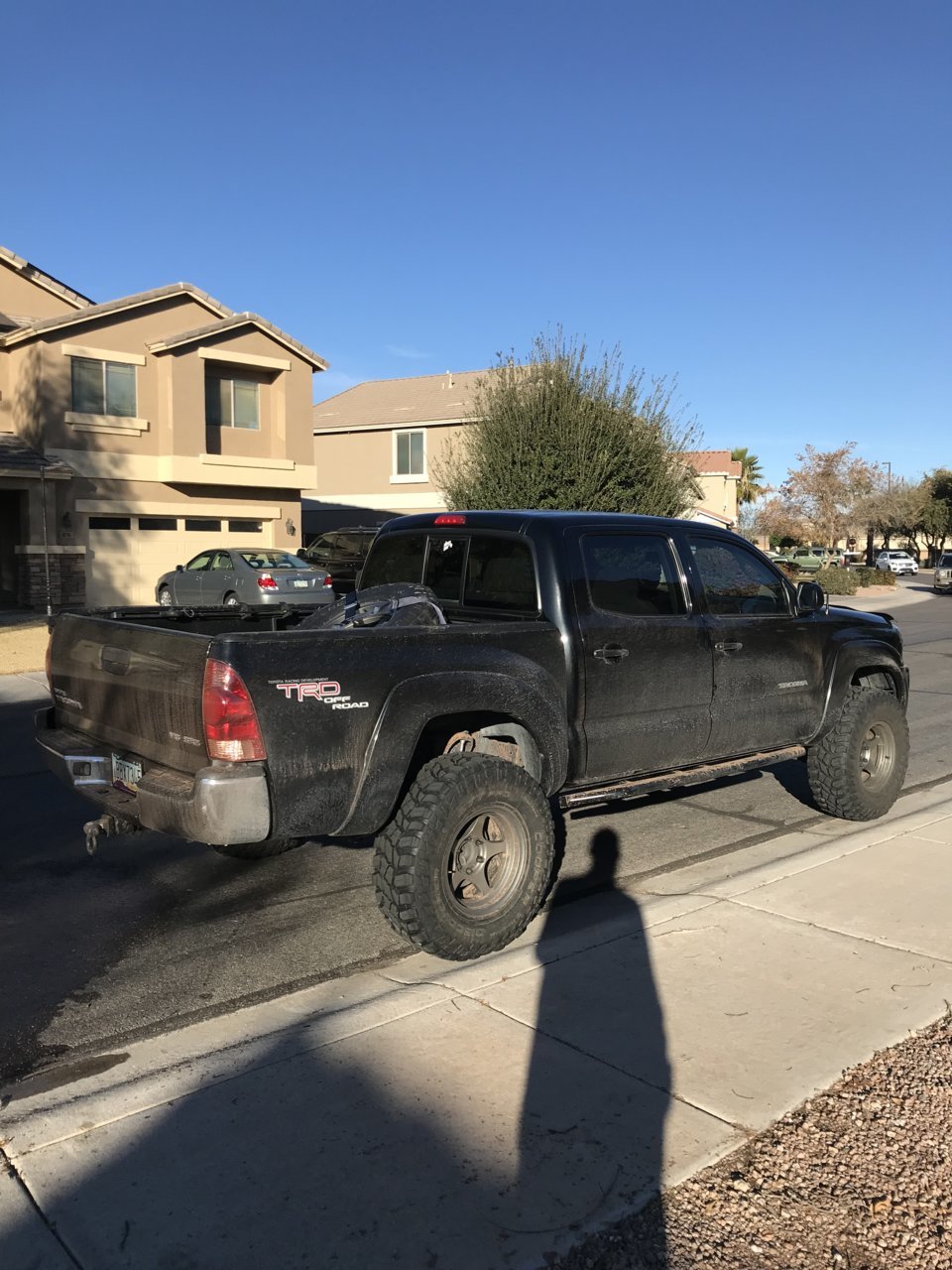

    It even impressed my buddy with a JKUR

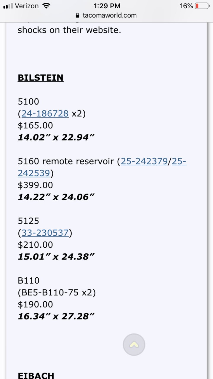

    What are the advantages of running b110's instead of 5100's?

    A LOT more travel.

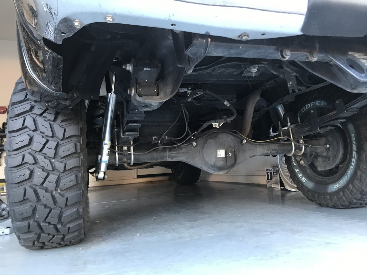

    Over 4 more inches of travel if you choose the b110 over the 5100. So much travel in fact, you need to have at least 2.5”-3” of rear lift, extended brake lines and likely better than stock bump stops to safely and effectively run them. Worth it.
    https://www.tacomaworld.com/threads/2nd-gen-rear-shock-options-with-lengths.584583/
