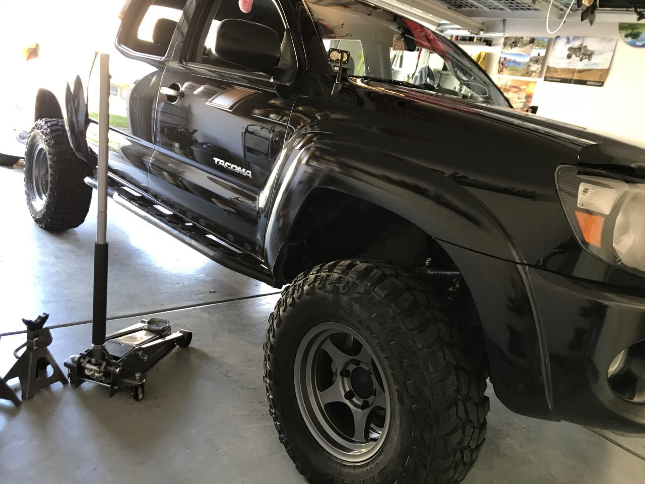

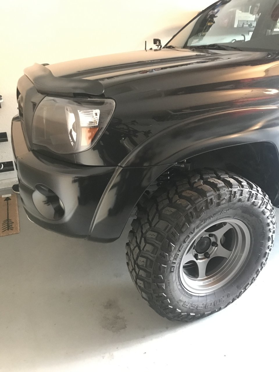

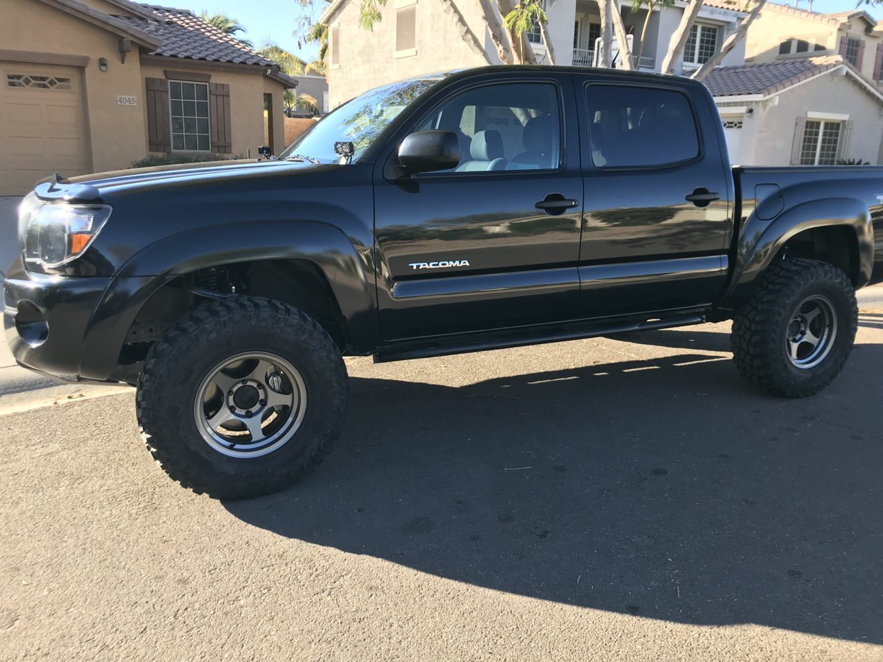

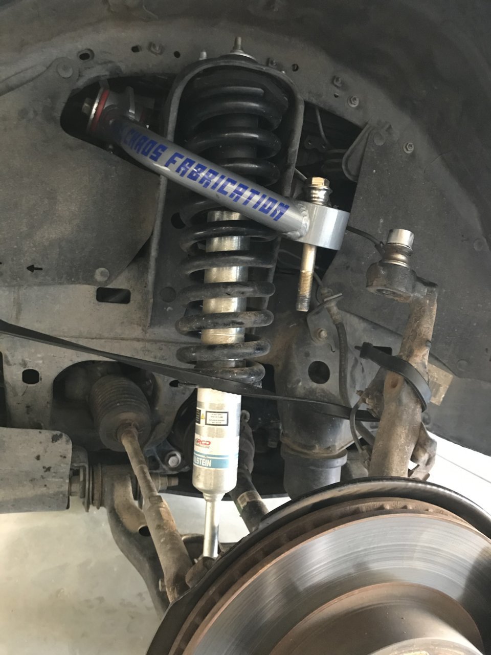

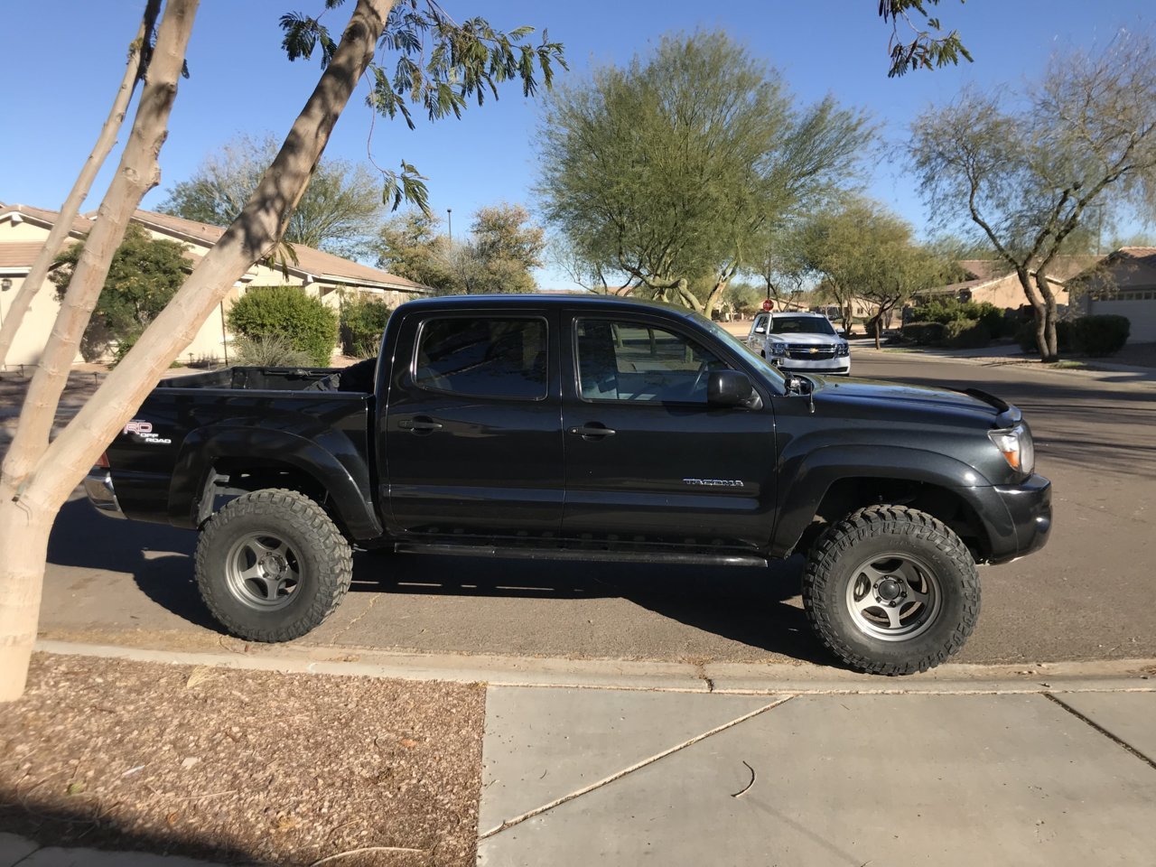

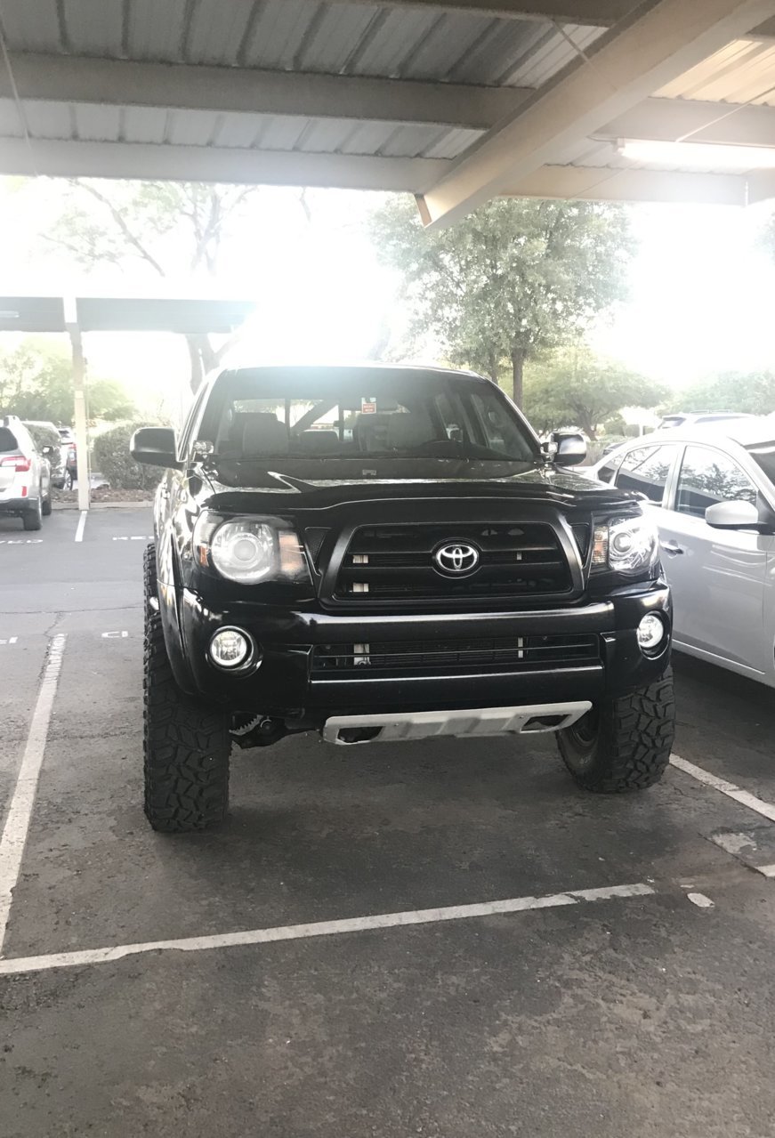

    So I added a polyurethane 0.5 inch strut top spacer on top of both front coilovers (5100 + 885) and I’m so much happier with the front end height now. I felt for so long that i was barely at 2.5” front lift but now I’m at a good solid 3” front lift to pair with my rear 2.75/3” lift and to help accommodate some heavy steel skids that are coming.
    Note* drivers side i kept the .25” strut top spacer in addition to the .5” strut top spacer to help fight the lean. Truck drives great. No noticeable negative changes with on road driving and I got a fresh alignment too. This was only doable because I got extended top studs when I had wheeers build my coilovers last year for this potential reason.
    Again, I just wasn’t happy with the front height for some time, and considering I want to slightly raise the rear height with some archive garage hammer hangers and also put some heavy skids up front, I wanted to help lift it a hair. All below pics are after adding the .5” strut top spacer.

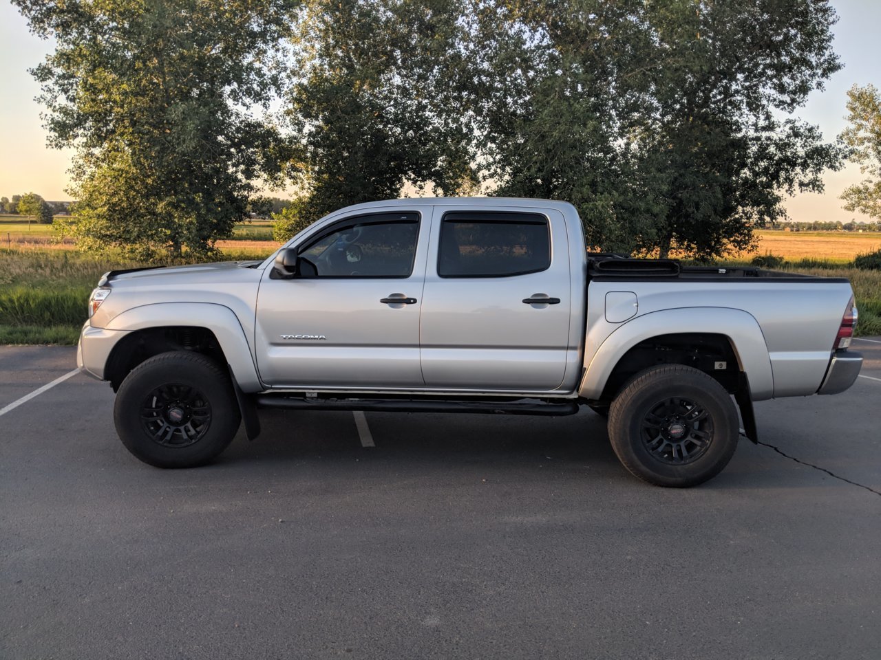

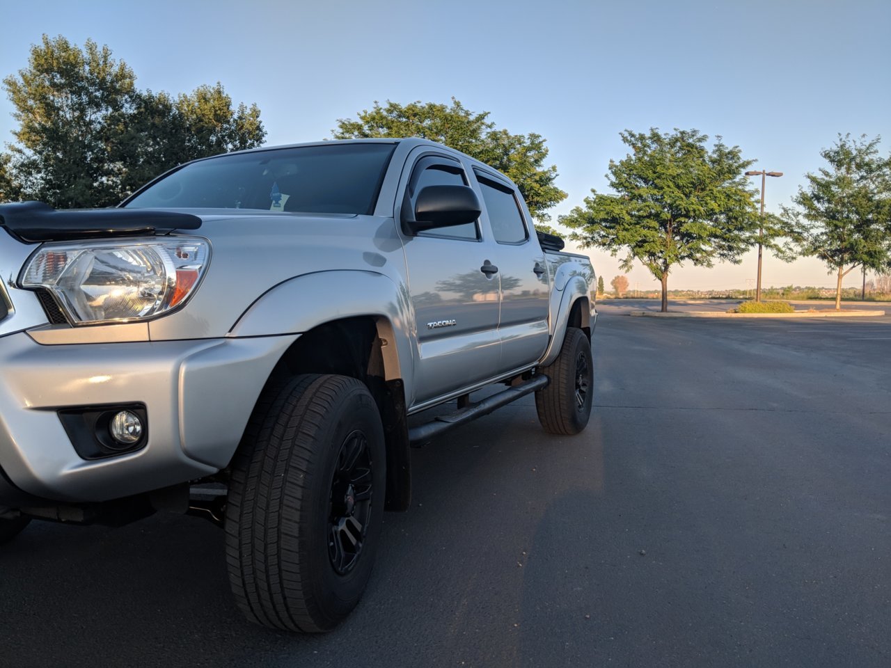

    I just did the 5100 with 885 coils only got 2 inches took rear leafs out they were to high so now 36 1/2 all the way around. Also have 1/4 spacer on Driver’s for taco lean. Double cab 4.0, probably going to pull front coils and go bigger after front skids are done. Has anyone else only go 2” on 885’s Zero setting?

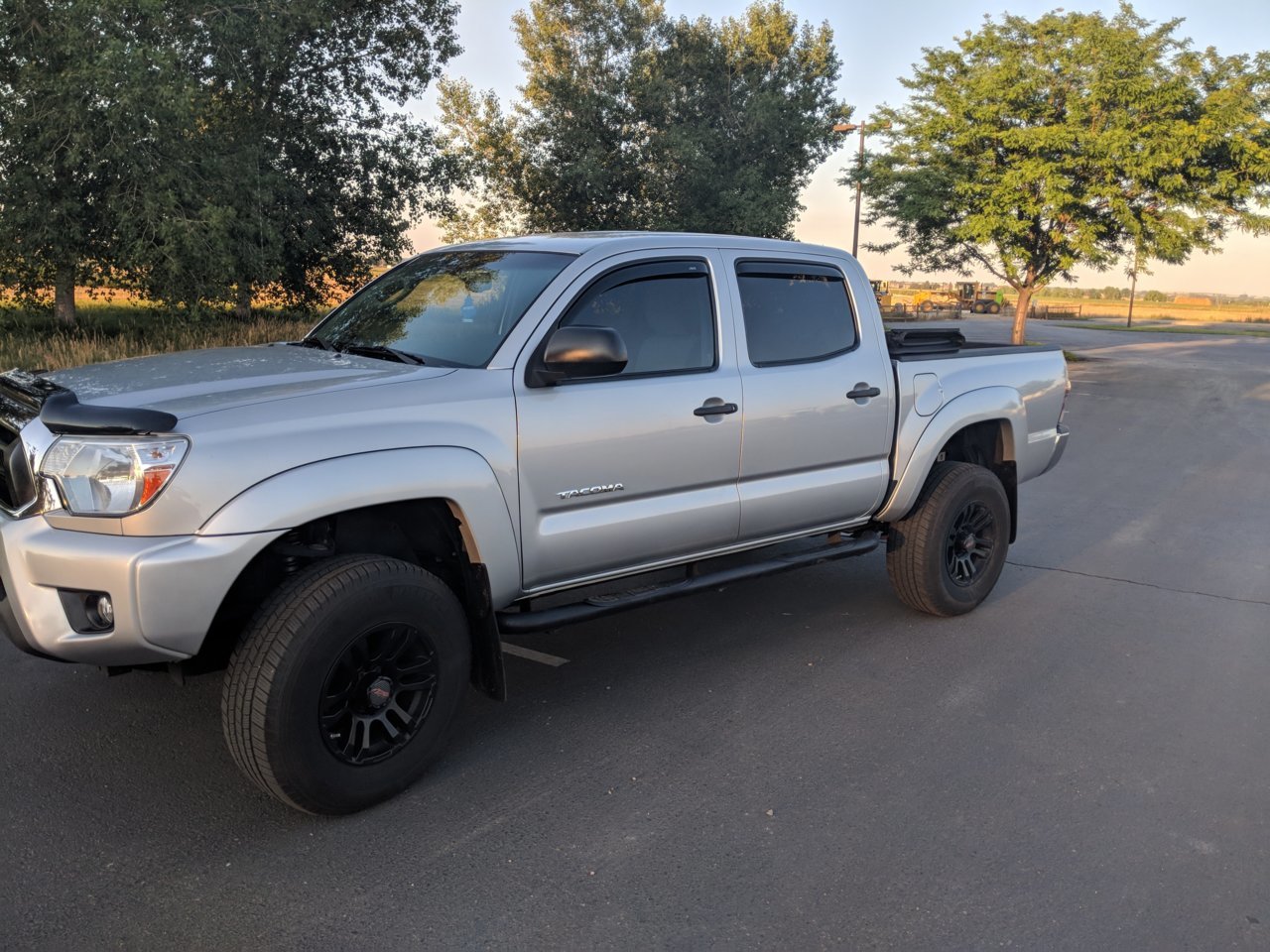

    I'm sitting at approximately 2 inches with 885 on Billstien 5100s. I'm running a bullbar with no winch (for now). So my question is when I get around to putting a winch on should I stay with my 5100s with the 886 coils that I probably already need or should I get some OME shocks?
    I really like how it handles now will is be similar with 886 coils on 5100s?
    The only other concern I have is that both my rear 5100s are leaking. Is this because my dakaD springs are more than welcome they can handle? Should I change my rear shocks or just waranwar my current shocks on the rear?
    I know that's a lot of questions I'm hoping that someone has some insight into this. That's what TW is about afrterall.
