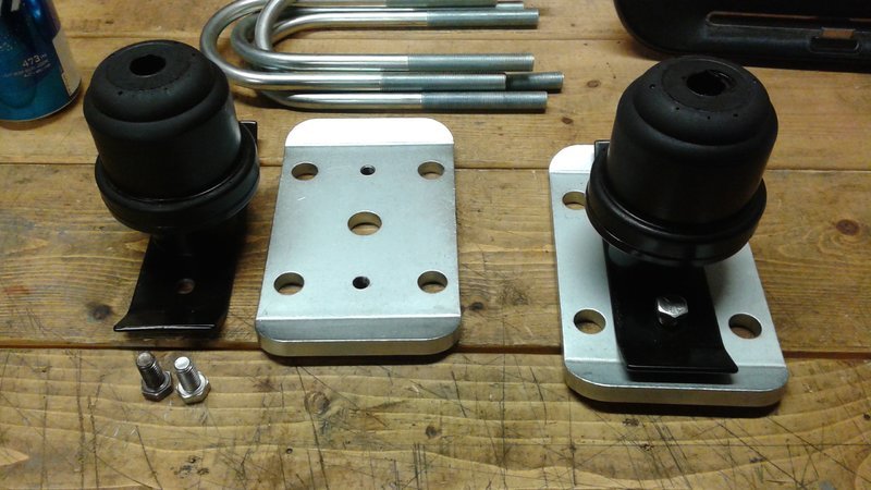

    I use Wheelers "Superbumps". They offer bumps that fit stock front location. Rears are available with a bracket that adapts to the top plate of the flip kits....Drill and tap 2 holes and bolt 'em on. Simple and much more effective than stock bumps.

    Yeah I have superbumps up front. In the rear I have inverted daystars chopped to the proper height. I harnessed my internal @EatSleepTacos cheap ass and only spent $14 on my rear bumpstop solution and it is effective.

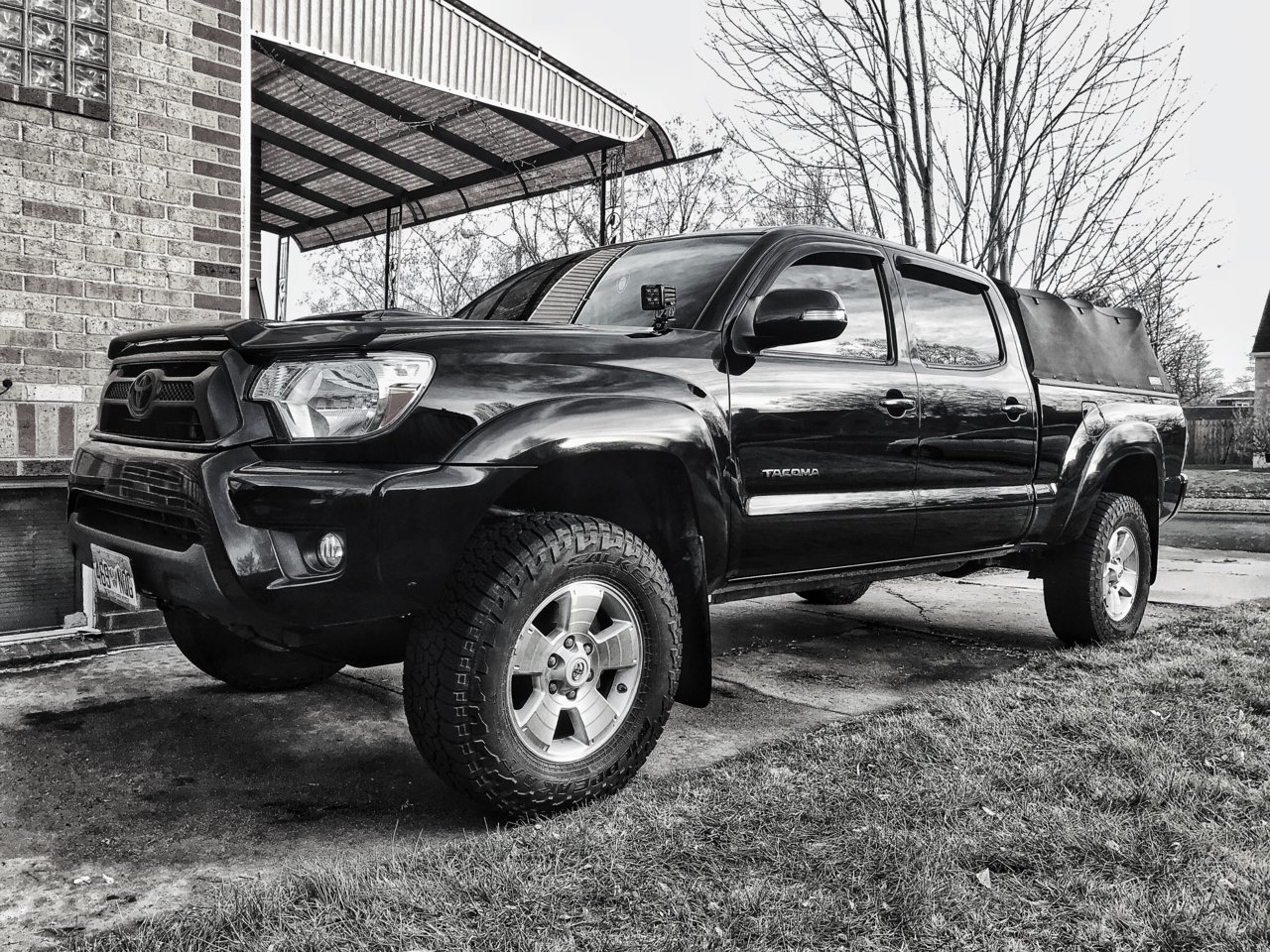

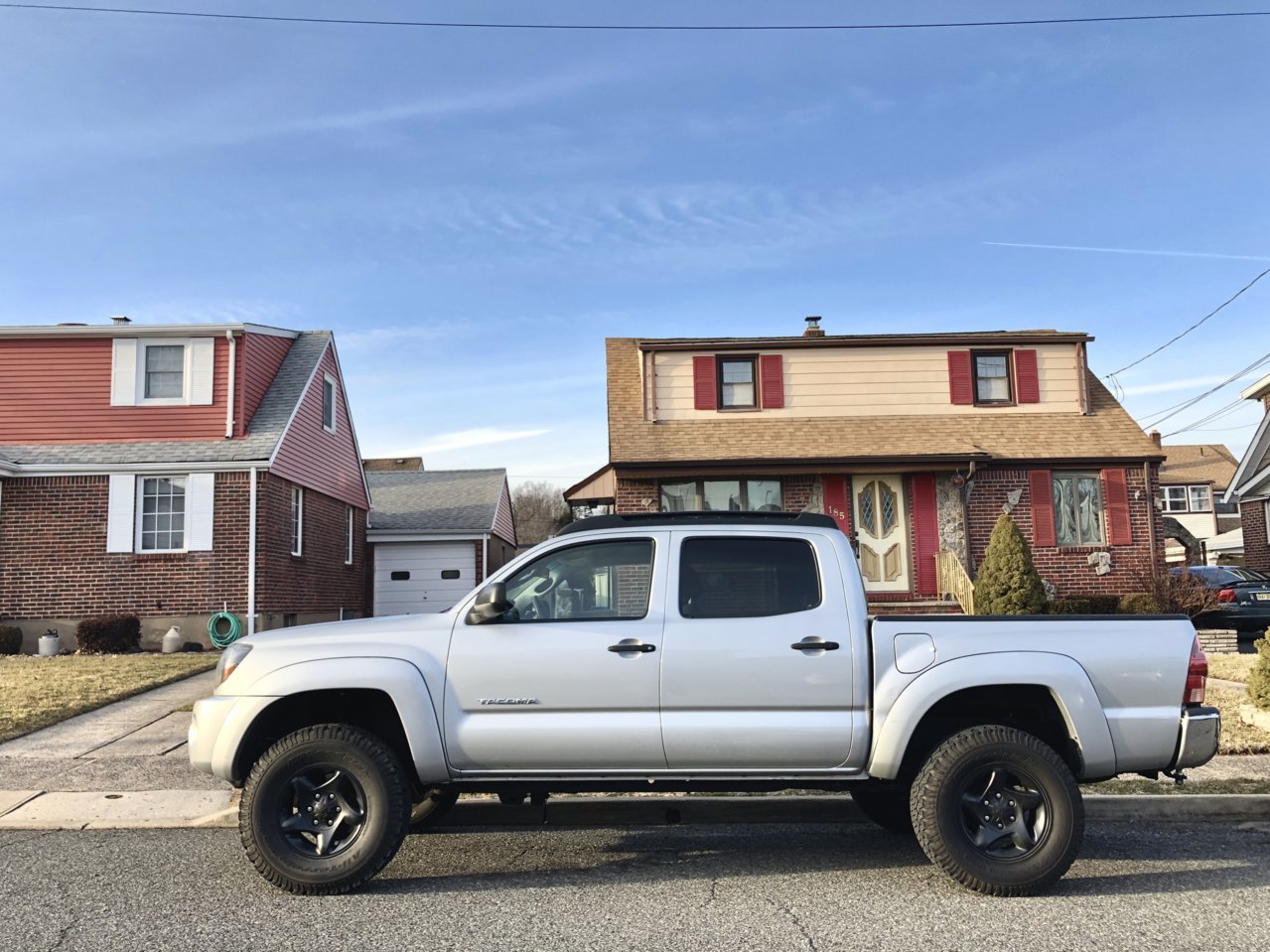

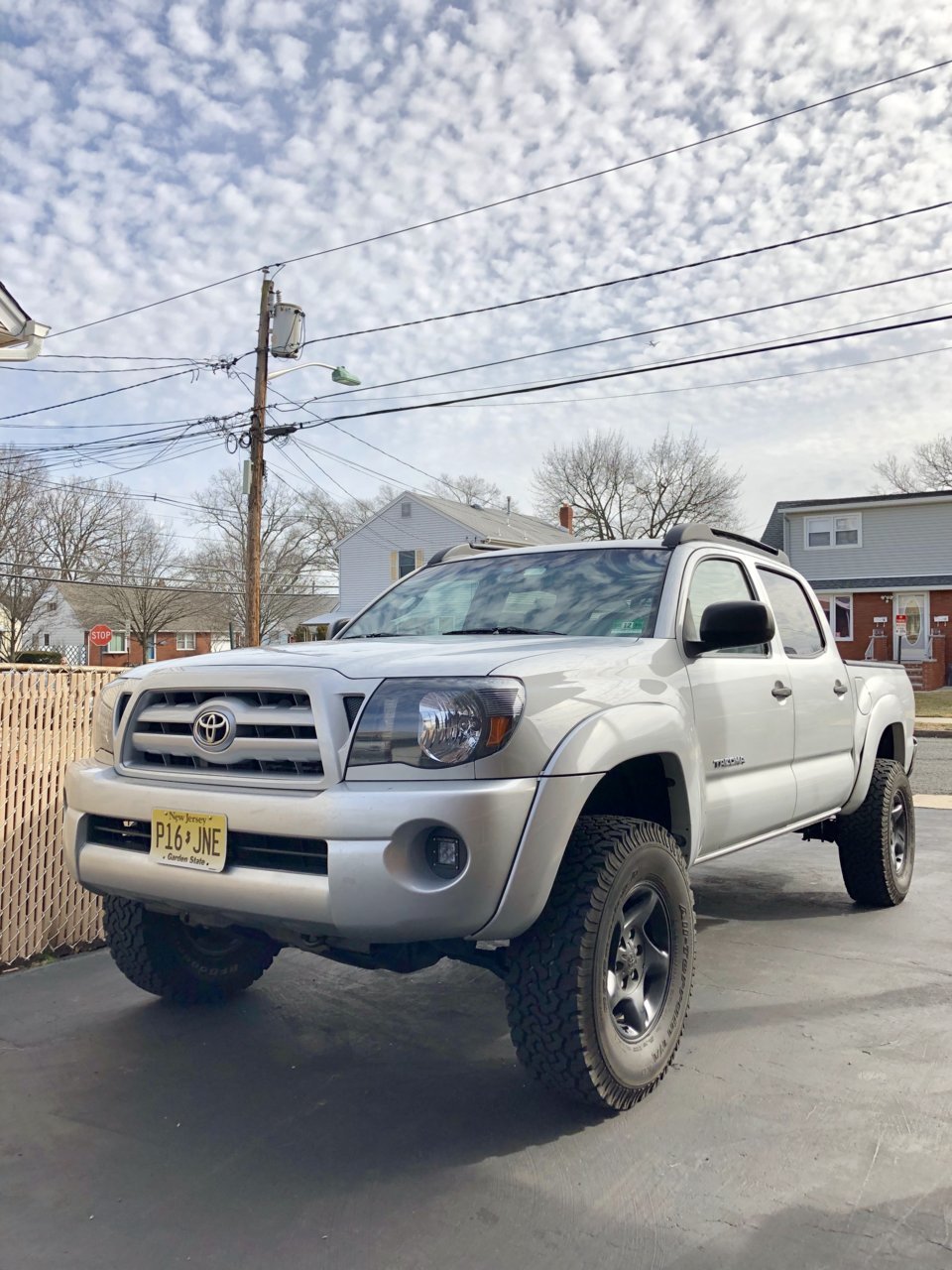

    Finally got my 5100’s, 885 coils and Icon 3-leaf progressive leaf pack installed. Very pleased with this combo and thank you to everyone that posted in this thread, made my decision very easy and definitely worth it.

    Nice stance, what size tires?

    2020 Tacoma DCSB Cement Grey
    Thank you and the tires are 265/75/16 BFG KO’s. Also have 1.25” spidertrax spacers that help make it look a little more aggressive with the 1st gen tundra wheels.

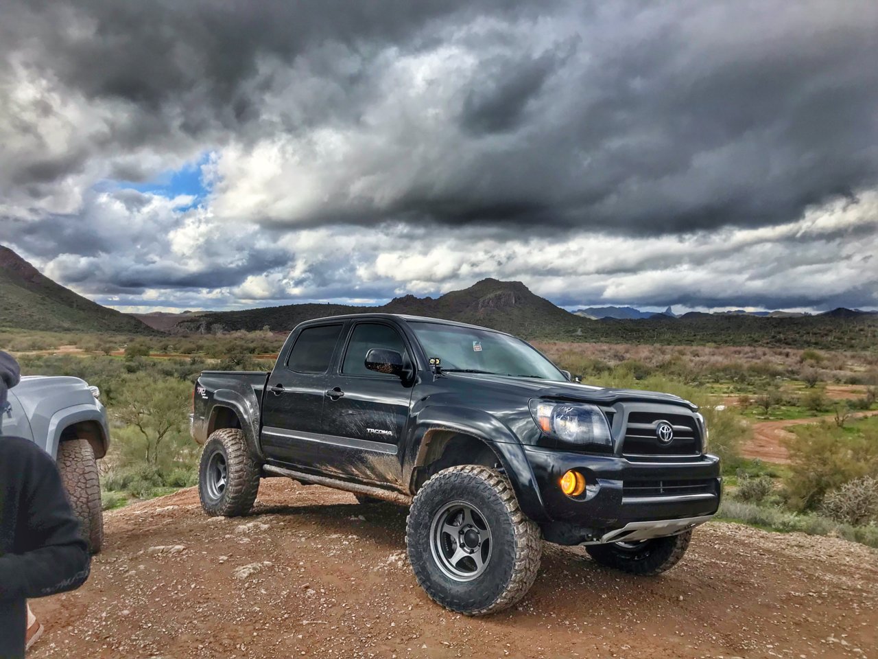

    Update - more wheeling with my 885/5100 setup! Still loving it. No regrets, no issues. Drivers side has a .75” and passenger has a .5” strut top spacer.

    What did you use to lift the rear? Love how yours sits.

    any reason for the passenger spacer as well?
    my kit came with the just a driver side spacer i bought from headstrong off-road. haven’t read anything about people putting one on the passenger side.

    I added a small strut top spacer above both sides (NOT A LIFT SPACER) adding preload but a small strut top spacer because I wanted a hair more lift up front. Especially because I’m going to put some hammer hangers in the back adding about another .4” lift so I need the front to be a little higher. This was my height before, with just a .25” spacer on the driver side.
