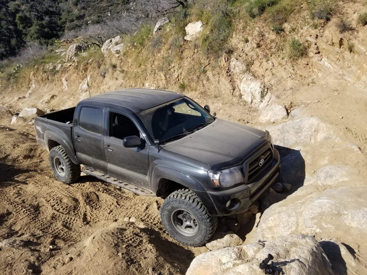

    https://www.tacomaworld.com/threads/singletrack’s-‘dad-shred-build-thread’-i’m-just-doing-it-for-the-kids.619250/ Sos offroad sliders (kickout + filler) Sos offroad full belly skids (steel) Sos offroad front recovery point Sos offroad concepts HC rear bumper with bedside kickout tubes Marlin Crawler LCA frame brace kit Trail Gear rear diff cover Bilstein 5100 + OME 885 Total Chaos UCA BILSTEIN b110 OME Dakar standard pack Wheelers Ubolt flip kit Wheelers Superbump f/r Wheelers SS extended brake lines FN five star 16x8 -25 Milestar Patagonia MT 315/75r16 Custom projector retrofit (acme super h1 + morimoto 4300k) Baja Designs S2 sport ditch pods on CBI ditch pod mounts Amazon AMAK rock lights CMC CB radio hardmount

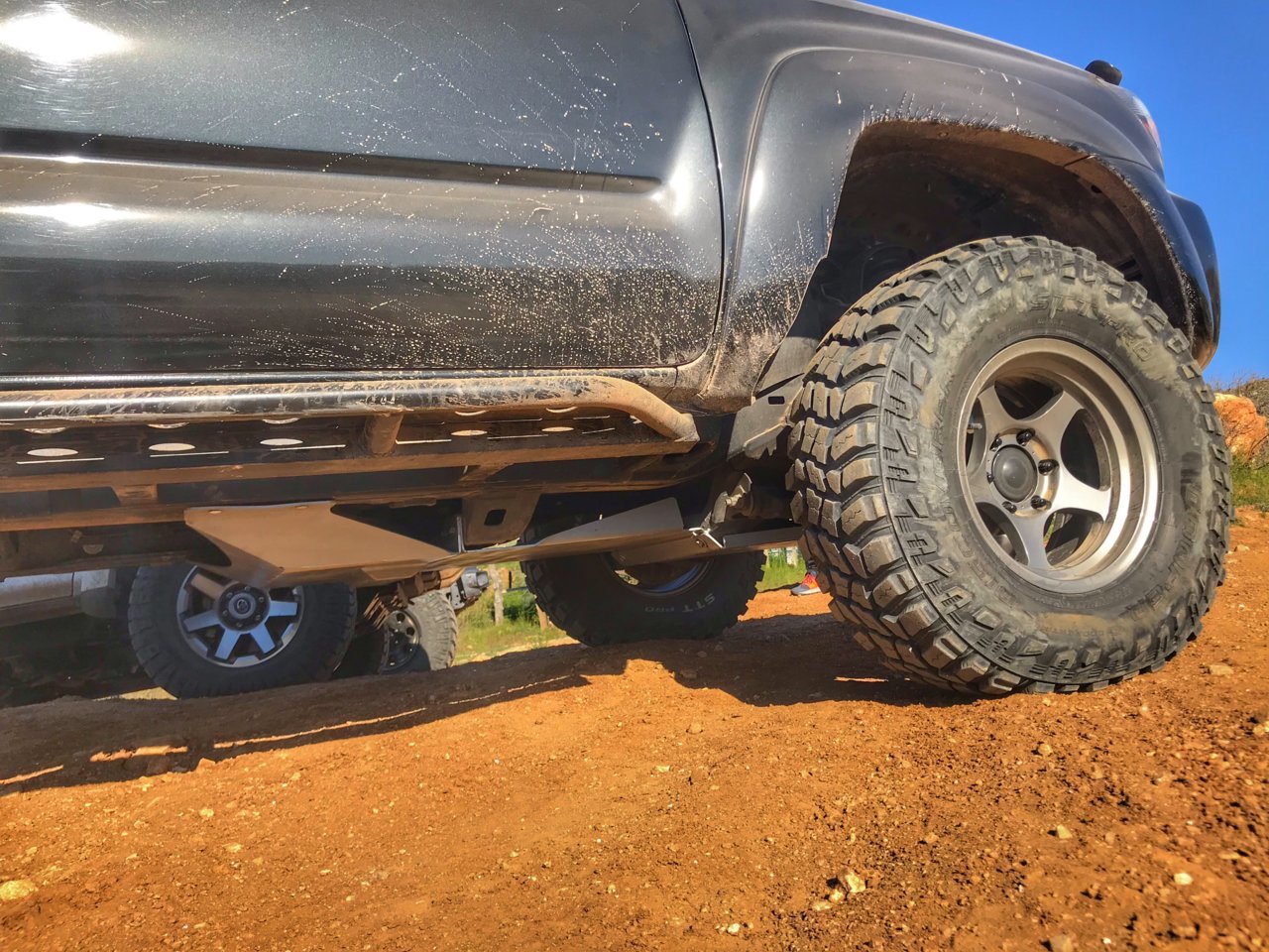

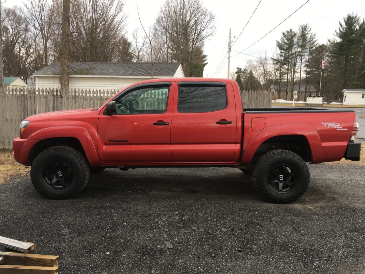

    A few updated pics of my 885 with strut top spacers and Dakar pack I’m back. Such a killer setup for not much money at all.

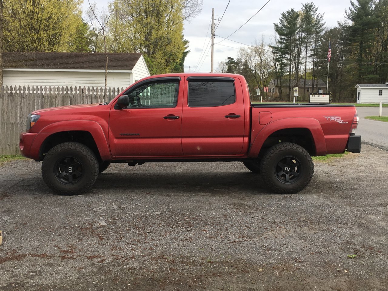

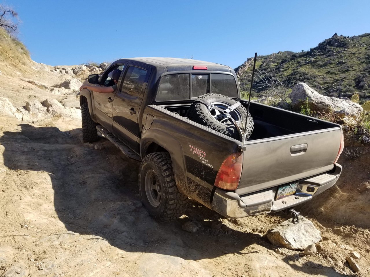

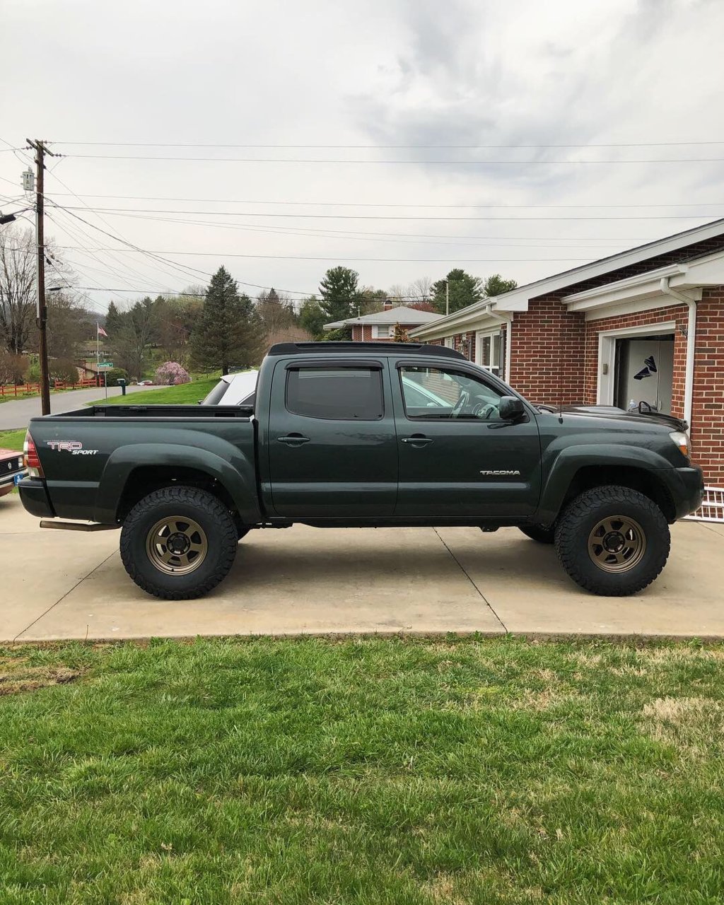

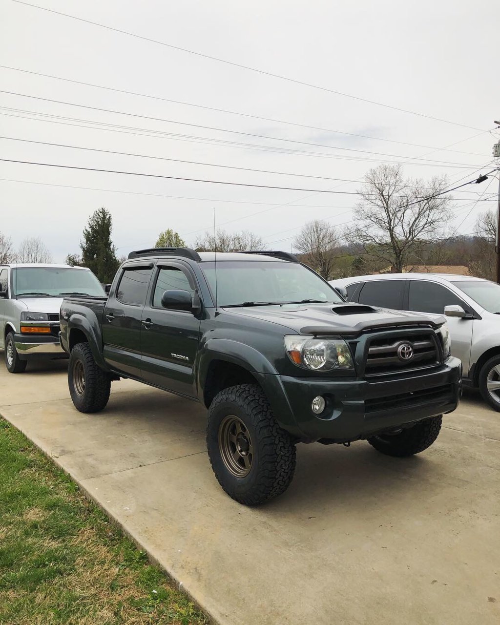

    I finally got my kit installed yesterday! 885 w/ Deaver 2" AAL in the rear for the time being. May eventually upgrade to Dakars in the rear but only time will tell.
    So far super pleased with it!
    EFD7BFC6-16B9-40CB-AAAD-6E2B79864C71.jpg 4240E489-E7A2-495B-8F39-6512F0CBFD0D.jpg

    Looks KILLER with that combo! Those FN wheels on that pyrite mica! Heart eyes

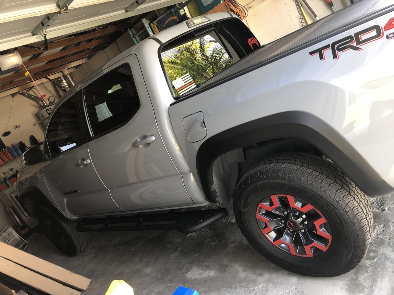

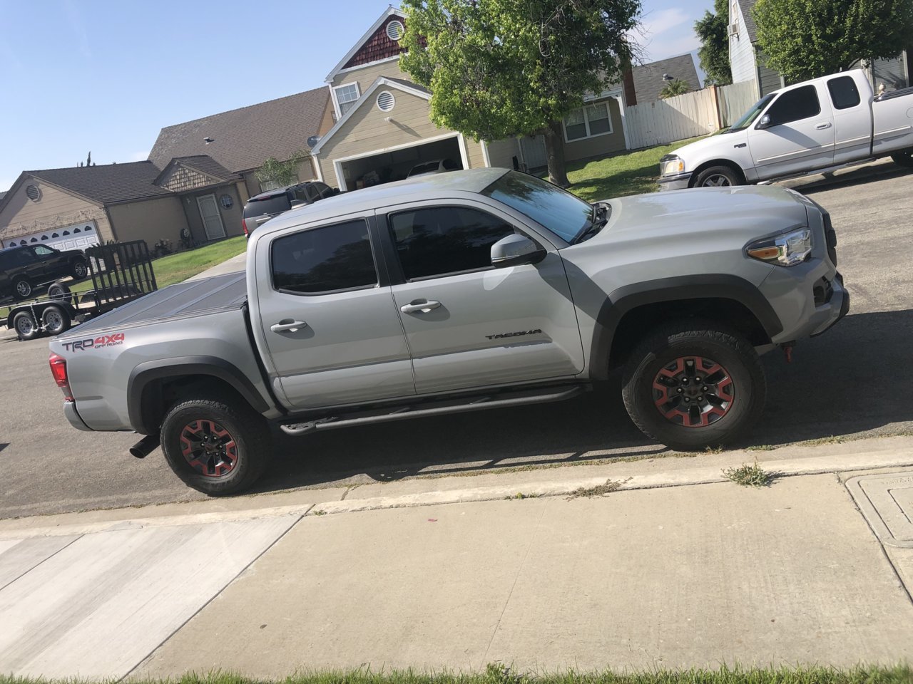

    Installed yesterday! So happy drives so nice.
    Before

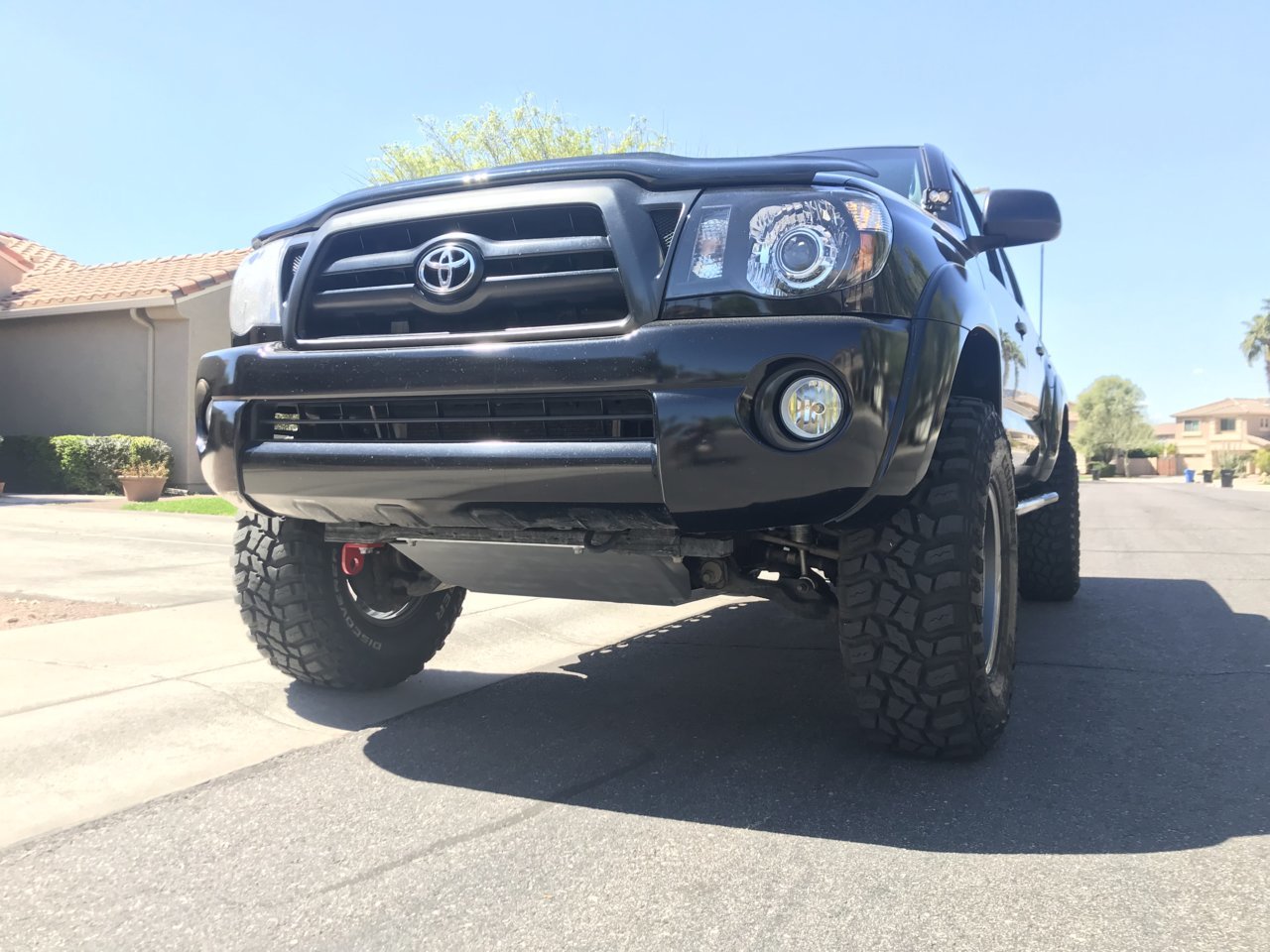

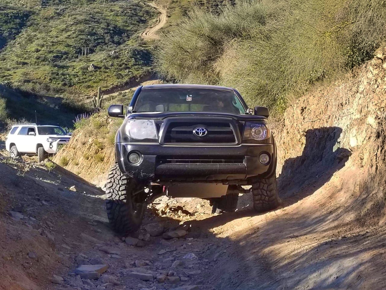

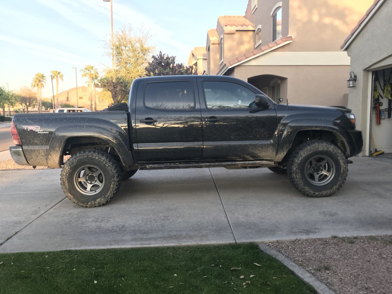

    47522A47-9027-4A41-9C2C-716031927414.jpg 67AE2A2D-1534-46A3-8C6A-30450EF0B9E8.jpg
    Bilstein 5100 front/rear
    888 OME coils
    Icon AAL rear springs
