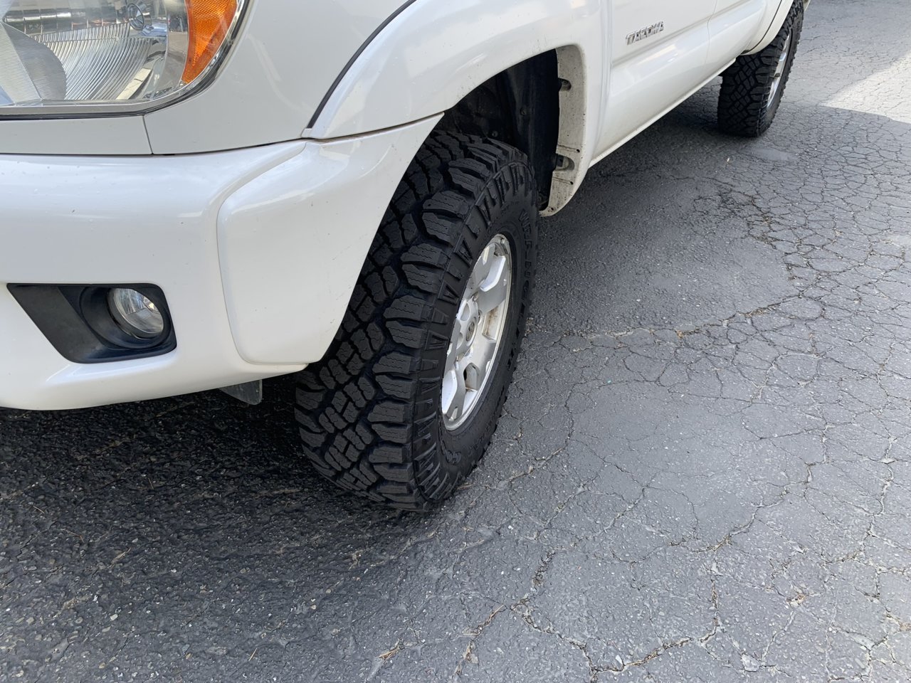

    Got some new tires over the Memorial Day Weekend! Went with Goodyear Wrangler Duratracs in 265/75R16 and I'm pretty satisfied with them. Seem to be quieter than I was anticipating and smoother riding than the Cooper ATPs I had in stock size. Definitely feel heavier though and I'm playing with PSI to see what would be best (currently doing 35psi all around). No balancing issues or alignment issues running stock UCAs. No rubbing at all and stock rims and spacing. Was able to get America's Tire to price match vs. Amazon which was able to save me ~$265 (got each tire for $135 and had America's Tire agree to match Pep Boy installation of $59.95 for all 4), so if anyone is looking at getting a new set, I definitely recommend checking Amazon first then seeing if you can get it price matched. Goodyear is also having a $60 rebate for purchasing 4 Duratracs and America's Tire is offering 0% interest for 6 months and a $50 rebate for answering some survey (think both deals are good through June but check to confirm).

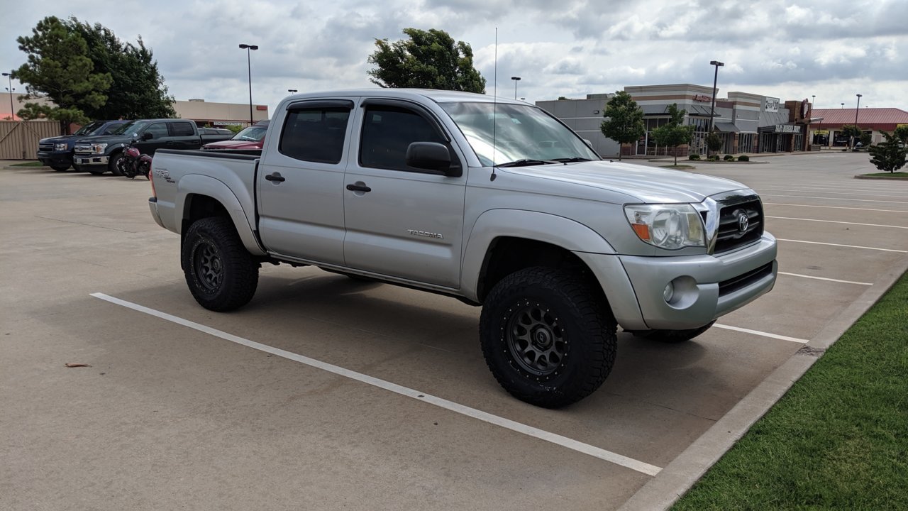

  5. Jun 15, 2019 at 11:47 AM
    #1005
    birry
    birry Well-Known Member
    Oct 5, 2012
    #88370
    604
    Oklahoma City, OK
    2008 4x4 DCSB
    OME 885, Bilstein 5100's, Wheeler's (single) AAL

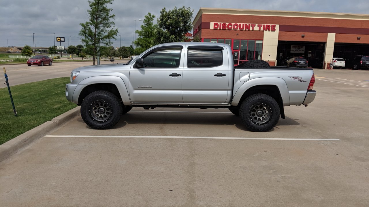

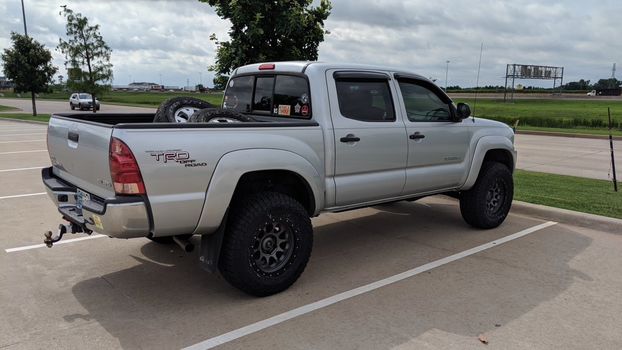

    New setup is (mostly) complete!
    New stuff includes,
    OME 885 coils
    Wheeler's single AAL
    Bilstein 5100's all around
    CV axle bushing (ECGS)
    Replaced LCA bushings on both sides
    Ray 10 (17x8.5)
    Falken Wildpeak AT3W 265/70R17
    Rear axle shims (3 degrees)
    Haven't driven it long enough to have a lot of impressions, but overall some of the rumbles and vibes seem to have subsided. I'll update this post as I gain insight.
    Suspension installed, before wheels/tires:
    After wheels/tires installed:

    Solid setup! Look at the B110s for the rear, they have a ton of travel.

    Just want to follow up after a few days (I'll follow up again after a few weeks) after installing the Wildpeaks and Ray 10's.
    The Wildpeak/Ray 10 combo looks fantastic. But it definitely rides rougher in town than the stock wheels with Cooper AT3's. They both have the same amount of sidewall, so I'm not sure why it would feel so drastically different. I've also noticed a bigtime loss in mpg. I need to give it a couple more tanks of mixed driving to nail it down, but its looking really bad after mostly city driving. I'll report back once I know better numbers.
    UPDATE: Just completed a 2,000+ mile trip to CO. I was mostly on the highway in the mountains, but also did some gravel roads, etc...
    What I've learned so far,
    The Ray 10 / Wildpeak combo is rougher than my stock wheels with Cooper AT3's. It just is. Now.....I did realize that they setup the Wildpeaks with 38psi at Discount Tire, so I dropped that to 32/34 (front/rear). Those few psi make a YUGE difference, but its still rougher than my OG combo.
    Question - would an aftermarket UCA and better caster angles help with the rough ride at all???
    Also, my MPG ranged from 16.5 to 22.5 for the trip. My guess is I averaged somewhere around 18 mpg. It'll be less in a daily driver (in town) scenario.
