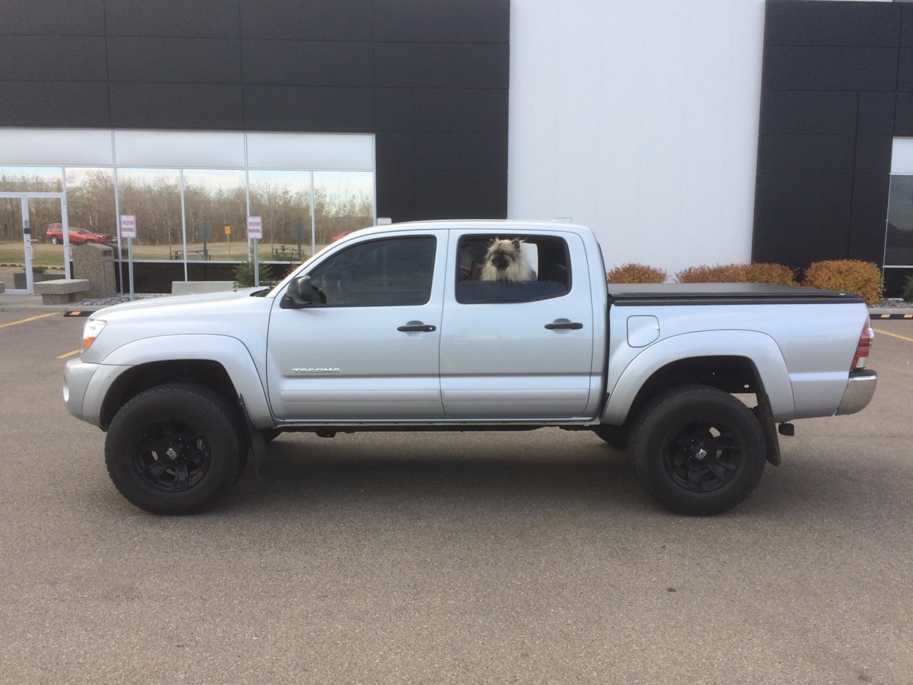

    LOVE IT!!!!!
    NOTE: each picture taken at a different angle. One higher than the other. Both ride heights are equal on all corners.
