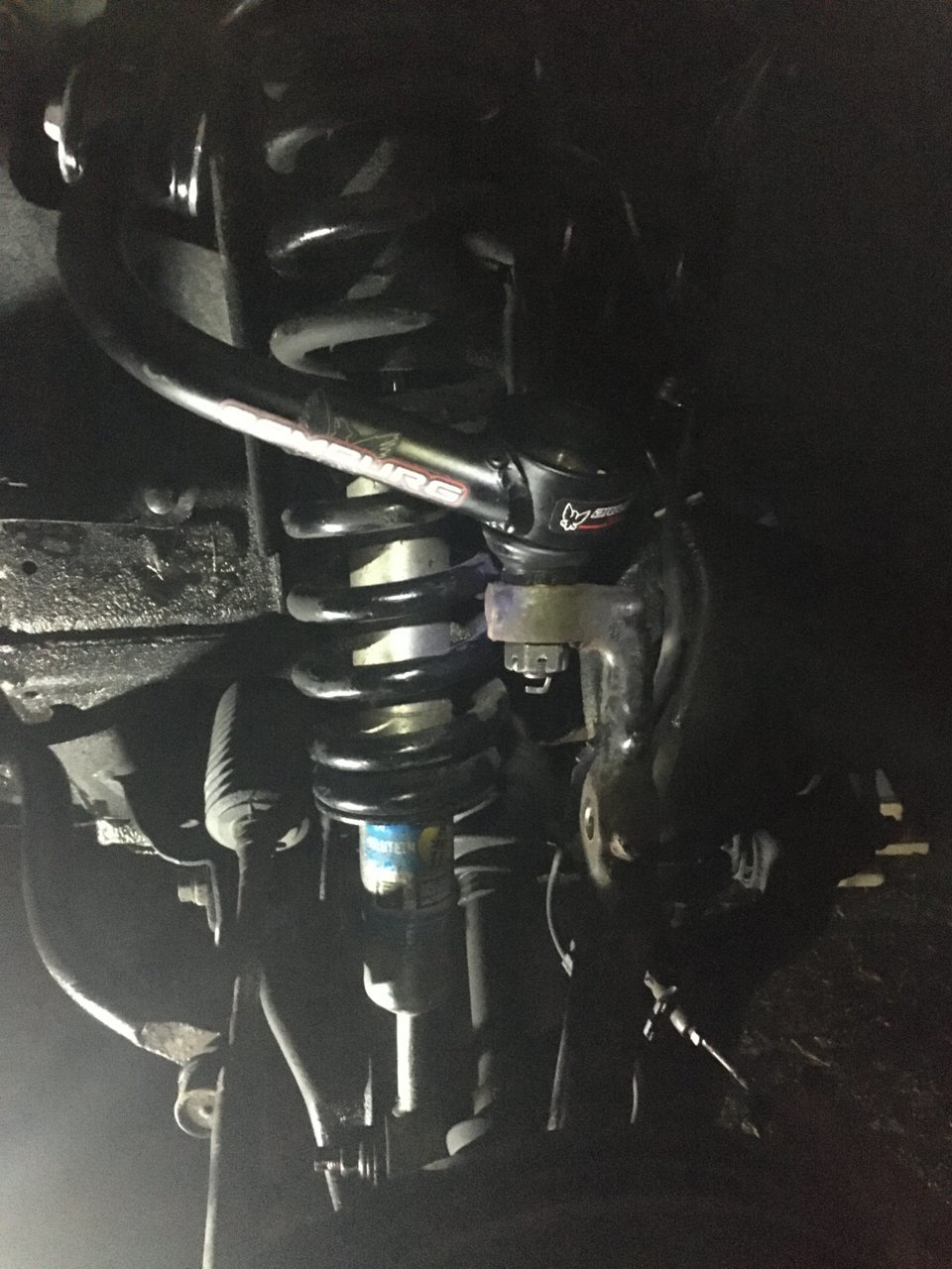

    installed Camburg uca’s last weekend and put in the 5/8 spacer I couldn’t put in with the stock uca’s. I’m sure this has been covered some ware in this thread but when I get it aligned where should the camber be? I wouldn’t think the factory camber would do it, any insight will be much appreciated!

    Camber should be close to 0.

    Ok thanks man!

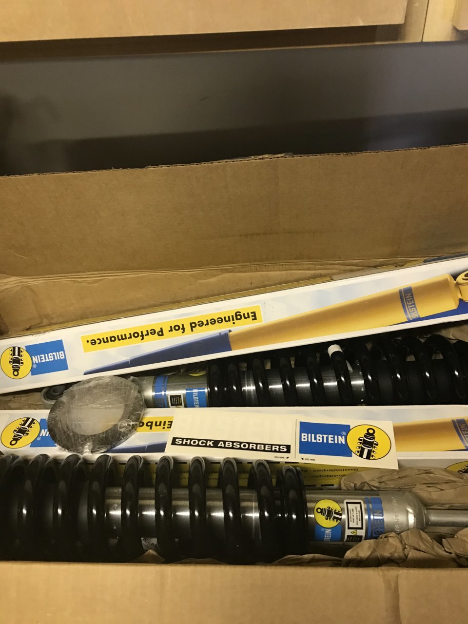

    935AE5EE-6B51-4D0A-AA57-1896357F52E6.jpg Merry Christmas to me. Hopefully have time this weekend to install with Dakkar AAL

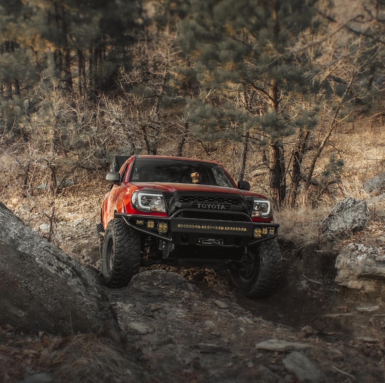

    ok so i have a question
    still haven’t installed my setup. been sitting in the fkn box way too long. plan to in the spring
    here’s my question. C4 Fab is releasing a bumper for the 2nd gens and i am wondering if i could run that bumper with the 885’s? seeing the weight of the bumper. what’s the allowed weight for a bumper with these springs?
    they said
    It will be 125lbs without the bull bar and 138 with the full height bull bar with tube gussets.
    pic of bumper
  8. Jan 3, 2020 at 7:06 AM
    #1148
    MAG GRY TACO15
    MAG GRY TACO15 Well-Known Member
    Sep 5, 2018
    #265273
    5,066
    Alan
    GA
    '15 TRD Off-Road
    Same crap everyone else got
    Don't forget the weight of an added winch also.

    o yeah i know forgot to add that
    i don’t need a winch whatsoever tho that’s the thing but i guess if it’s cut out for one get one or just leave the spot empty

    I think the general consensus is that you run 886's to account for the added weight of armor.

    For crawling not hauling
    Yep, this vvv

    so i asked the company if that truck was lifted and they said its on stock suspension with a spacer.
    so stock springs can handle that bumper and winch but the OME 885 i have to install won’t be able to work with it?

    They'll work. It's just not the ideal setup. I have a couple hundred extra pounds up front running 886s and I have about 2.25" of lift.
    And c4 fab has their offroad priorities all wonky if they're running stock suspension with a spacer.

    yeah i have 5100’s front and back and 885’s brand new in the box. and ever since i saw that bumper which comes out next week i really want it.
    so now i don’t know if i can install the suspension i have. or if i should sell the front shocks/coils and get a different setup that would be more ideal to accommodate that bumper and maybe a winch if needed
