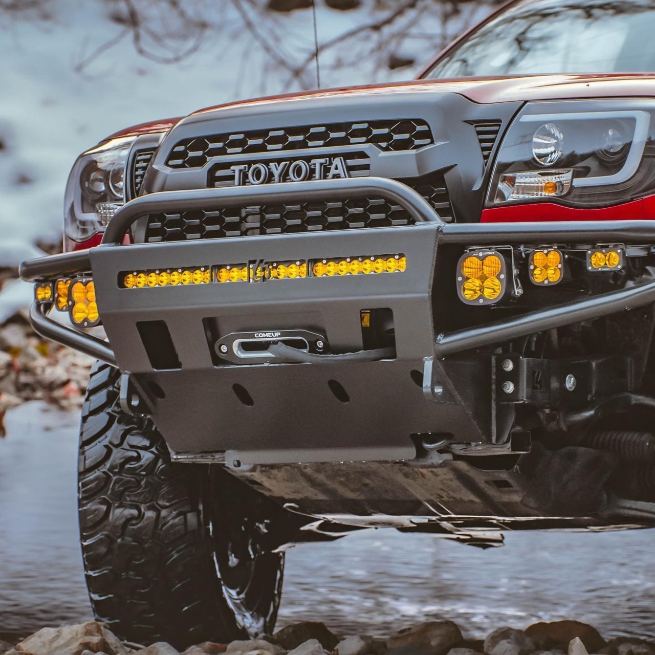

    my suspension is all brand new as it hasn’t been installed yet. but ever since i saw this c4 fab hybrid on new years that gets released tomorrow i have been wanting it pretty badly.
    if i do decide to get it i would need to just buy 886 coils and swap them and than find a buyer for the 885’s
