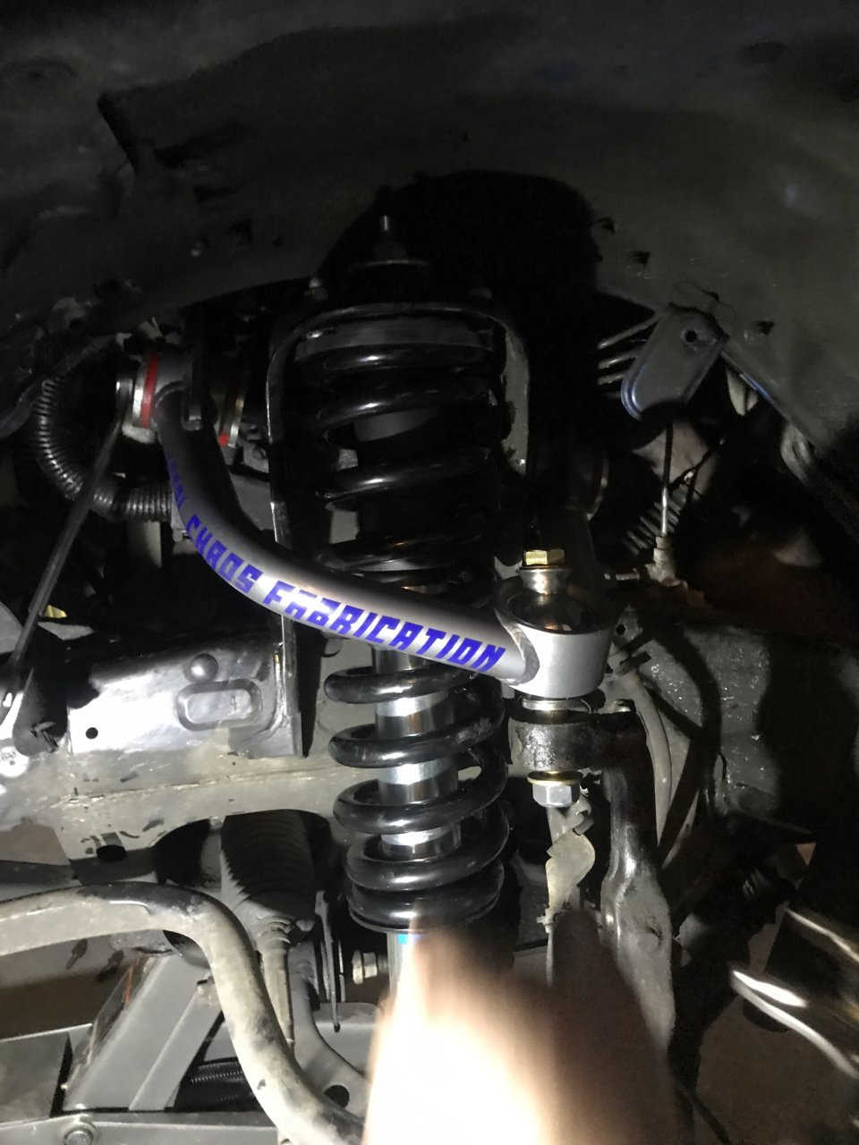

    so planning my lift install this week.
    I know the total chaos UCA’s have fittings for greasing the uni ball and all that.
    Seeing how mine have been sitting in the box brand new for the last 3.5 years i don’t have to do anything special to them do i?
    Do you grease the uni all after you install?
    or just install straight out the box and re grease after a certain amount of time?

    Starting install on my lift tomorrow. Can’t wait about time been waiting wayyy too long to do this
    my friend is finally giving me the help i have been needing to get it done

  19. Feb 13, 2020 at 2:48 PM
    #1199
    TRD2010SpeedwayBlue
    TRD2010SpeedwayBlue Well-Known Member
    Sep 12, 2015
    #164039
    1,814
    Brandon
    2010 Speedway Blue TRD Offroad
    lift installed!!
