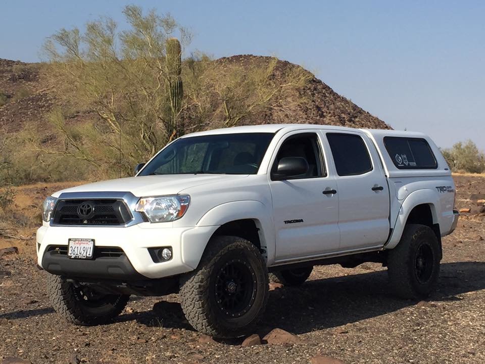

    Hi 92,
    I think the 885's would be a good choice for you, it would lift your front end up 2 1/2 inches. The ride is great. I have OME Dakar CS047R Leaf Packs in the back. These lift my back end 3" and support my shell and gear great. Leaf packs would support your bikes and other gear as well and ride great. I suggest leaf packs instead of AAL's in your case.
    I had AAL's and it sagged to much for me.

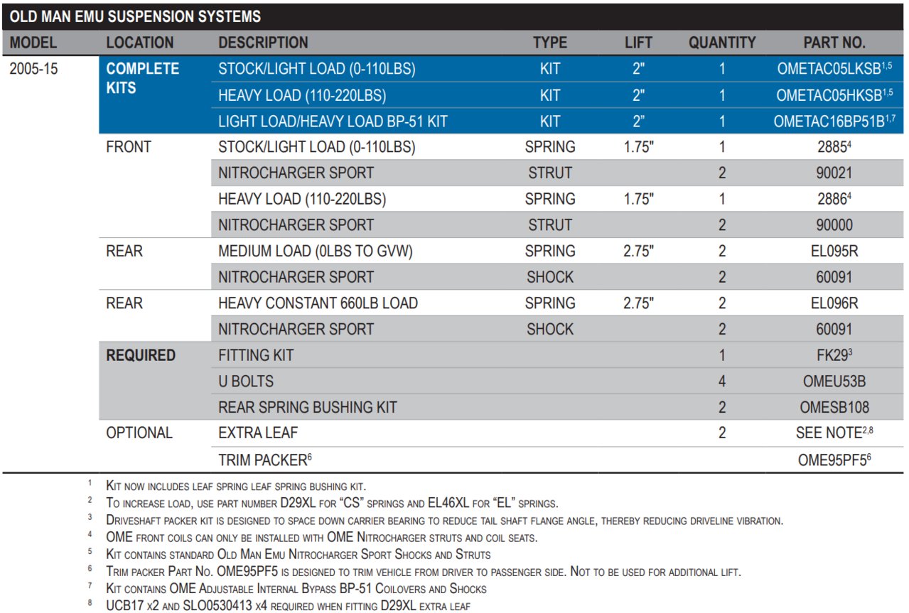

    Does anyone have insight as to why the OME 885's are now only recommended with Nitrochargers?

    Hi MFrantz, I did a lot of research when I was looking for the lift I wanted and saw this also. I went off of others that used Bilsteins with OME springs and they all said they fit perfect and liked the ride better than someone that had the Nitrochargers. They both are OME products and I am sure marketed in this way.

    Most aftermarket manufacturers shy away from recommending/supporting/warrantying their stuff when used with other manufacturer's parts. Definitely to drive sales of their own stuff but also technical reasons (impossible to support all the potential combinations out there). IIRC Bilstein doesn't even warranty use of 5100s with any spring other than stock toyota springs. But they will also invalidate the warranty for "off-road driving", so its not worth much anyway to keep things on your truck "warranty compliant," IMO.

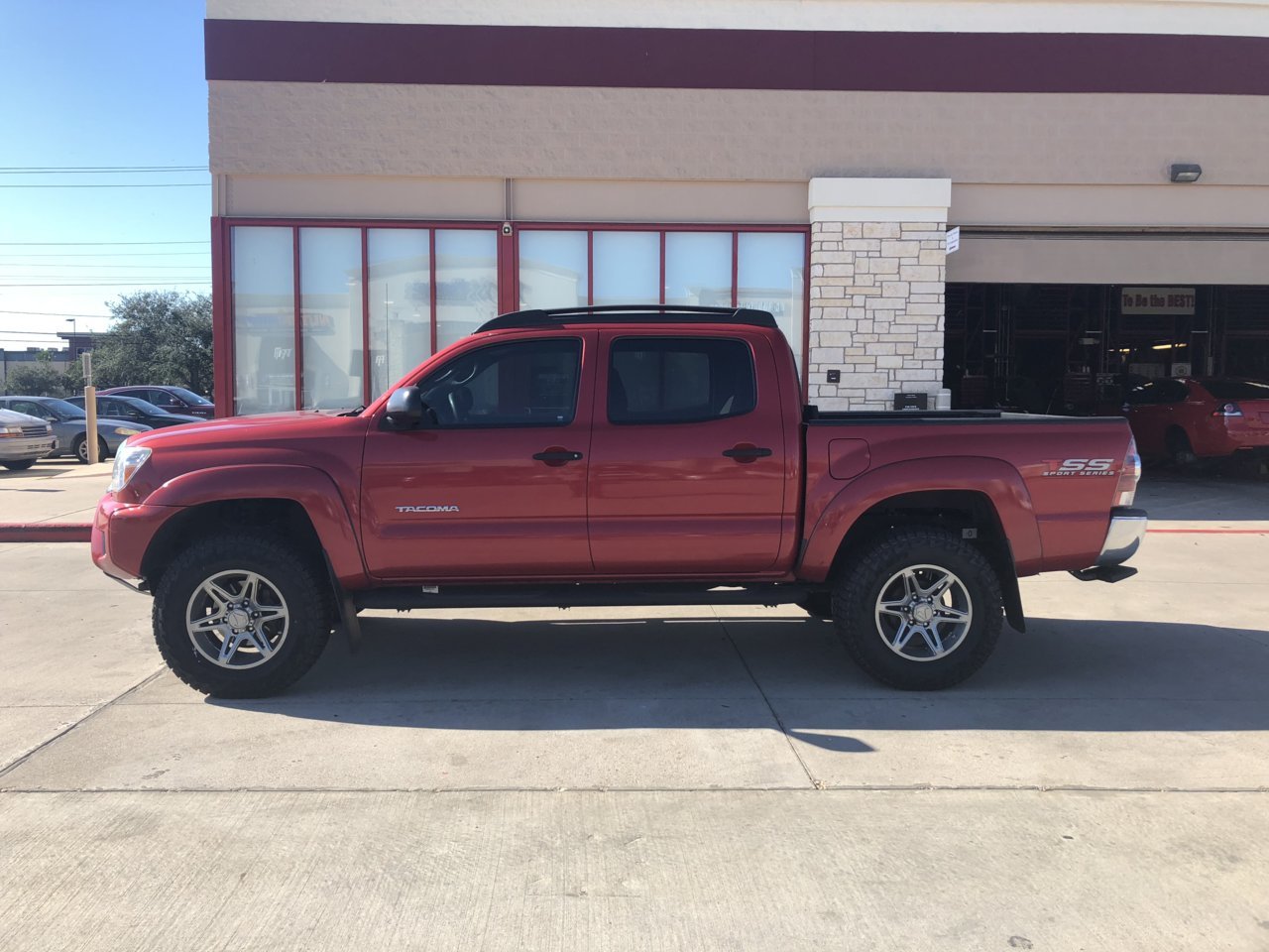

    Beginner setup. Bilstein 5100s, black rhino wheels
    hi!! What are you running on the back for suspension? I’m doing the same for the front of my Tacoma but am unsure what to do for the back. Yours looks great!
