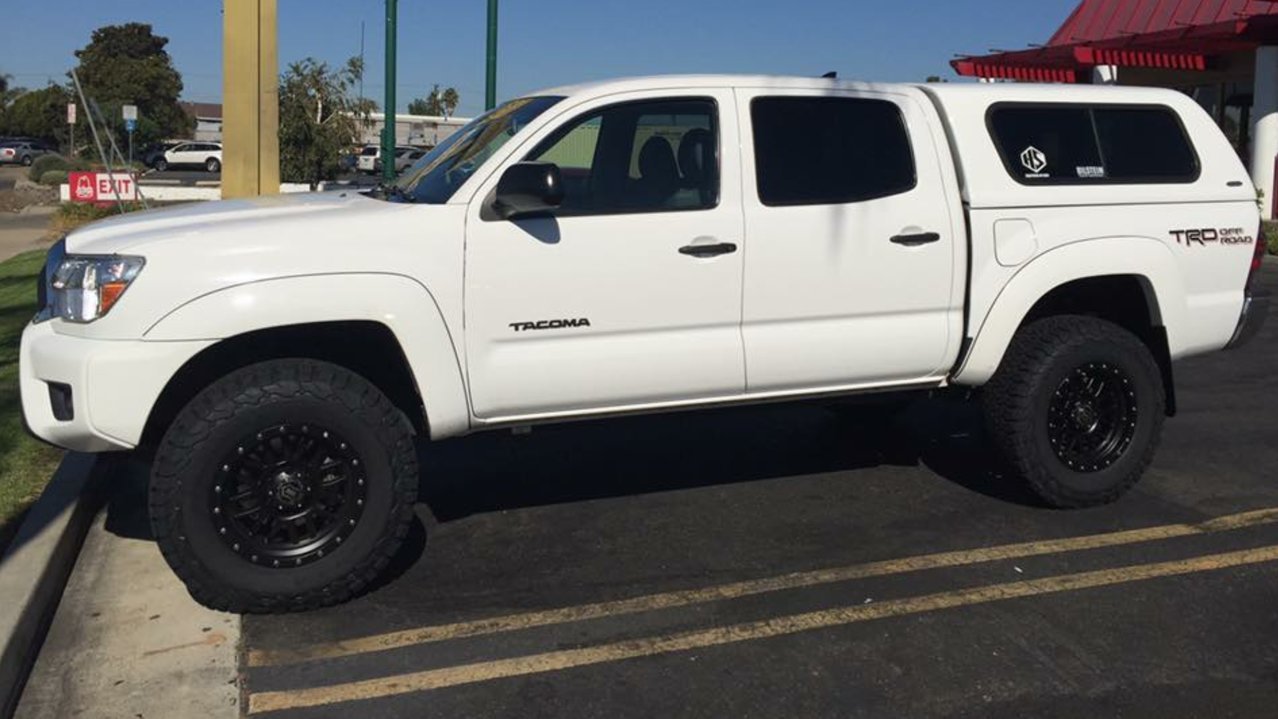

    Ok y’all so i’m needing your help.
    I will be in need of tires soon. I currently have 265/70/17 Ko2’s and seeing i’m lifted now with the 5100’s and 885’s with an AAL in the rear i wanted to get bigger tires.
    Will i be fine with 285/70’s? or will i have a lot of rubbing. i’ve been reading so much i’m getting a headache and want to know what the deal would be if i got 285’s. I’m thinking about getting C rated ko2’s but my other possible options are toyo open country AT3 or the Falken Wildpeak’s. but i’m not really sure what i want yet. Out of the 3 i really like how aggressive the side wall to the ko2’s are. and i have about 49k miles on the current pair i have which is pretty good!

    Hi Brandon,
    You could put 285's on your rig although.
    You would need to trim some of the plastic away from your front lower fenders and I recommend a BMC " Body Mount Chop" so you do not rub your tires on the BM's.
    I have 285 70 17's and did these things and it rides great with no rubbing when flexed.

    Yea that’s where i’m finding some info and some gray area. Some say you have to do a cab mount chop others say you can get away without and have had no issues.
    Can you post some more pics of the truck if you don’t mind?

    Brandon, I guess it would depend on if you go off road or not. It you go off road and flex your truck and do not want the rubbing and or cutting your tires I recommend it. You will see the pinch welds that need to be flattened as well. If you stay on the street then maybe you can get away with it. It looks like you do go off road and once you get those bigger more expensive tires you will want to.. :)
