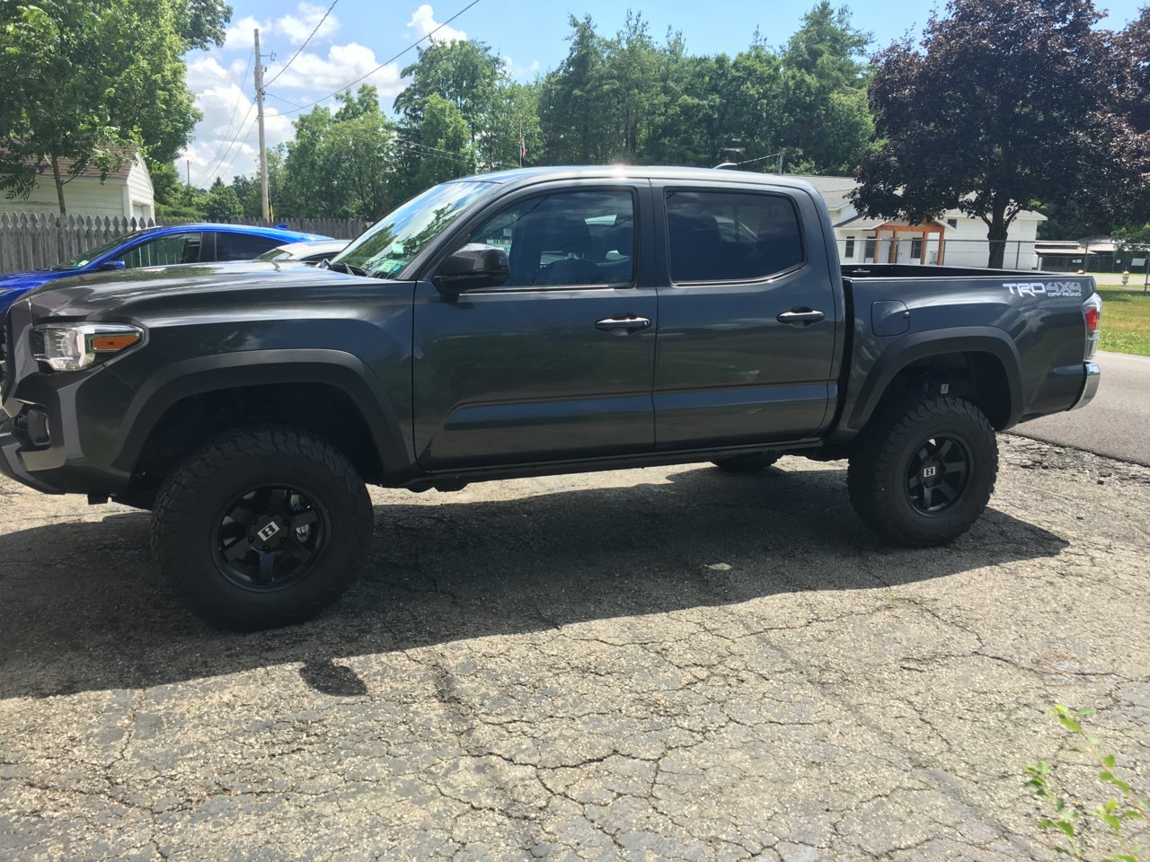

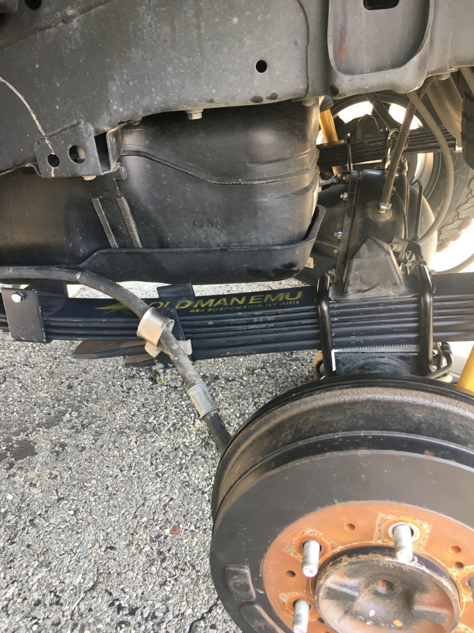

    2020 TRD Off Road
    Did my lift this weekend! Love it so far.881B3A41-0520-4314-A248-5A73FC89C398.jpgD99806DD-673A-404F-8555-A79586F43021.jpg 6E3034CC-664C-4D3A-8112-127EB7E7A5EB.jpg
