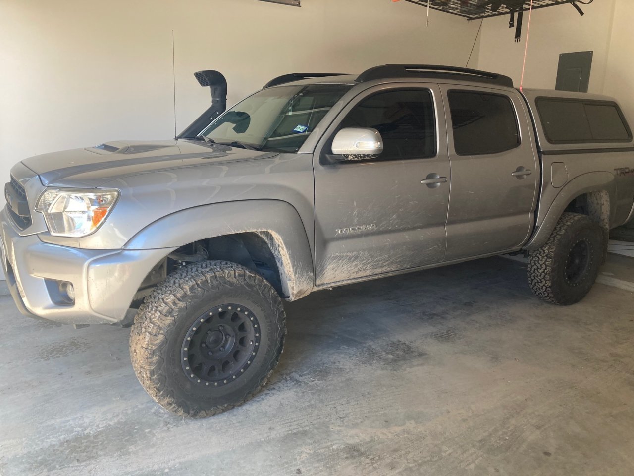

    FJ to Taco
    FJ to Taco Well-Known Member
    Mar 10, 2015
    #150578
    551
    Tony
    Lacey, Wa
    2015 DCSB 4x4 TRD Off Road,Snugtop Rebel
    Bilstein 5100's all around, OME 885's and OME Dakar CS047R Leaf Packs. Snugtop Rebel, pet screens,front slider drop down window. WeatherTech mats. Interior LEDS
    Hi Richard, If you did a 2 1/2 in lift and did a BMC and triming it would clear. if you don't do the BMC and trimming it is going to rub and on thos new tires. If your really not going to off road you may not want to spend the money.
    It will look and ride with 885's and 5100's and AAL's. Then I'd put a beefier tire on it. Maybe KO2's 275's
    Let us know what you decide

    Hey Tony, Thanks for your help! I figured that a BMC and trim would be needed in order to clear a 285. And I originally was looking into 275 KO2s as well but thought an E rated tire might be overkill since it would basically only see pavement and possibly snow. You do have a good point though as I am only really going for the aesthetics rather than actually utility, so I might have to rethink if I want to spend the money on a full lift, wheels, and tires. Will definitely update whenever I pull the trigger and upgrade everything from stock.
    Your truck looks awesome by the way!

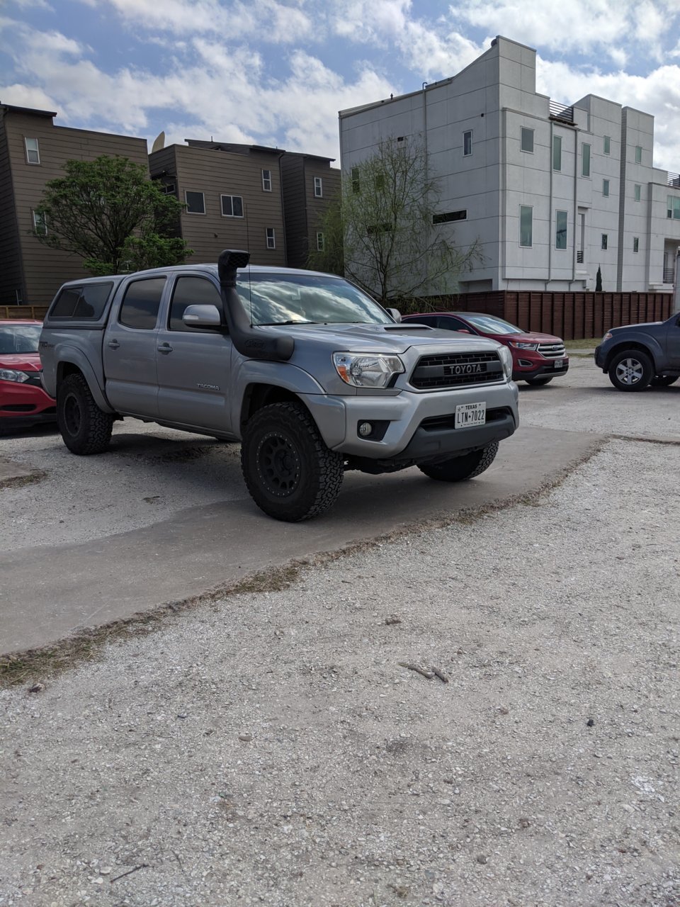

    I really used this thread to make my decision with 5100's and OME 885's w/ deaver AAL and couldn't be happier with the results, so I thought I'd share some information on my results.
    I'm currently running 265/75/r16 KO2's and after the lift, they kind of look small. Might need to go with bigger tires :eek:, but not until I use up the tread on my current tires, or maybe they need to settle a bit.
    I personally feel a significant upgrade in ride quality from stock. I also got my suspension installed at Duggy's Garage in Houston which I cannot recommend enough. They are so awesome. On my first truck, I had it done by a guy who did it for dirt cheap, and I paid the repercussions of that. I'm sure I could've done this current installation myself if I really wanted to from the vast knowledge I've gained from this website, but I really preferred professional and quality work from the PTSD I got from my previous lift experience.
    I really enjoy trying to find bargain deals on parts on this website, so this is kind of the route I decided to go. Maybe if someone else is interested in going this route, it might help them too!
    - $200 Bilstein 5100's front/rear -- I purchased from another TW member with less than 10k miles on them
    - $100 Leaf Pack (From a 2018 OR Tacoma) - Originally, I thought about going with OME MD Dakar's because my current stock leaf packs were shot, but I decided to purchase used leaf packs from a 2018 OR with less than 5k miles from a TW member.
    - $325 COMBO (OME 885's/Deaver AAL/1/4" Spacer) - From Headstrong Offroad. Great knowledgeable people there who explained every stupid question I had.
    - $925 Suspension Installation - Done at duggy's garage. Go there if you're local! They are real quality work and wont try to sell you any extra bullcrap. Just for example, I tried calling two other shops for estimates, and they tried to get me to purchase new UCA's, hardware, accessories, etc. I told duggy's what I had, and they said that will work and that's that.
    BEFORE
    AFTER
    Scrat, FJ to Taco and gabbo2112 like this.

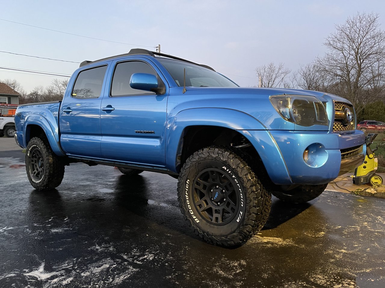

    Finally got my 285’s in! Need to get em installed. Don’t have a cab mount chop done or anything else like that honestly think i’ll be fine with just regular driving. what do you guys think?

    285/70’s installed!
