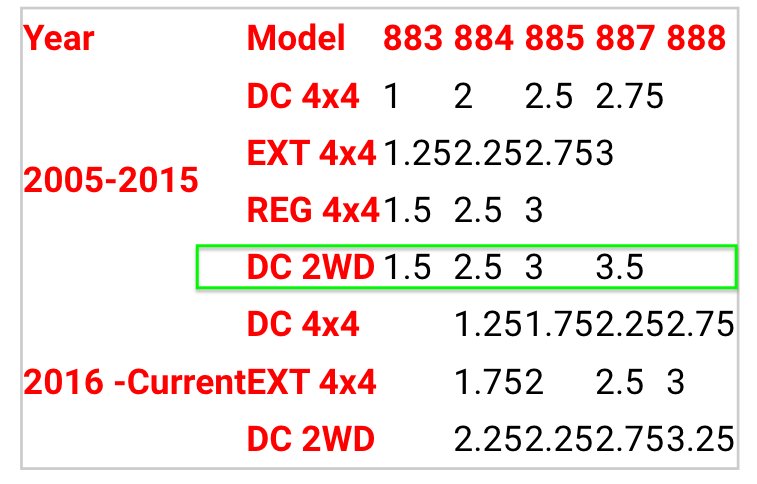

    Hey guys have a quick question bout this setup. I have a 2008 DC TRD SPORT 2WD. I was looking at buying the 5100 setup with OME 885 coils but noticed that with my setup being a 2 wheel drive, non 4wd, that it would expect a 3" lift rather than a 2.5". I run stock sport wheels/tire size now and will prob be going with new wheels/tires but wondering if I should maybe consider the OME 884 coils since they offer a 2.5" lift rather than the 3.0" even though the setup i'm looking at includes a multi leaf AAL and Dirt King UCA's. any help appreciated... thanks guys as always! The salesman was great and told me the 885's are their popular choice. seems like they have great deals goin on now... link to setup below.
