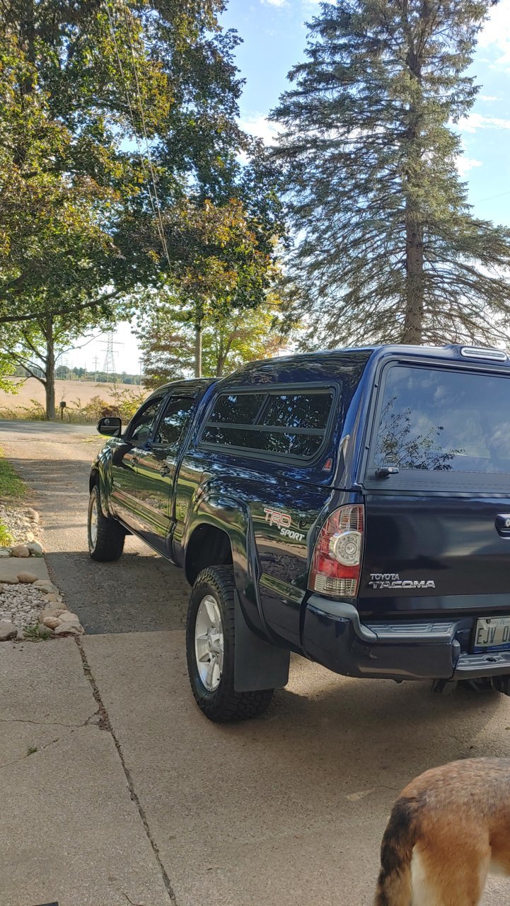

    I have a similar journey, with more steps over the last 4-5 years, except I don't have much extra weight.
    First I had 3/4" spacers above the top hat for 1-1/2" lift,
    then I switched to 5100's on 0 w/885 coils for 2" lift,
    then 5100's on 2nd groove w/885's for 2-1/2"-3" lift (I like to take the suspension apart, and I have a lifetime alignment),
    then 5100's back to 0 with 885's plus 3/4" spacers for 3-1/2" lift,
    then 5100 at 0 w/885's plus 1/2" spacers for 3" lift,
    then back down to 5100's on 0 w/885's.
    Now i'm changing to Fox 2.5's, and i've decided I prefer less lift, a lower center of gravity, and a little rake.
    My DCLB frame is still about 4" above stock height, so it doesn't look like a limo anymore, but 2" of it is from bigger tires and 2" more from suspension lift.

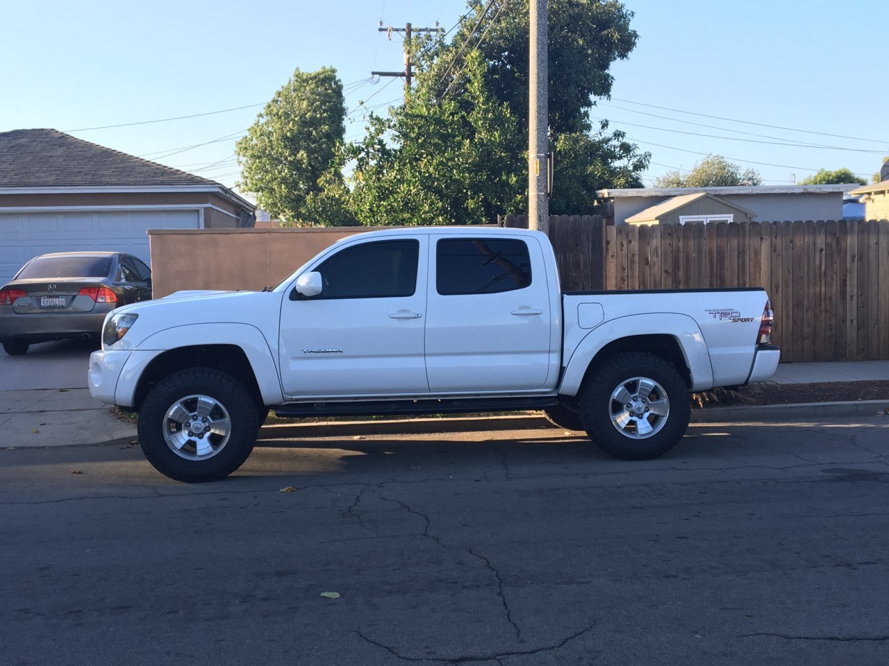

    just gonna throw these pics in here.
    ome 885 on bilstein 5100 with 1/4' spacer, deaver aal. stock goodyear 265/70r16

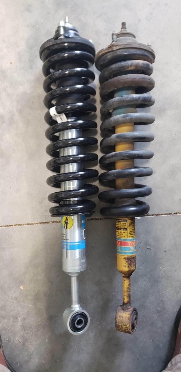

    I am in the middle of this swap. Does this look right? Same like the same length. 885 plus 5100. Thanks for the help.20210514_183851.jpg

    Got them in. They just look like the same length.

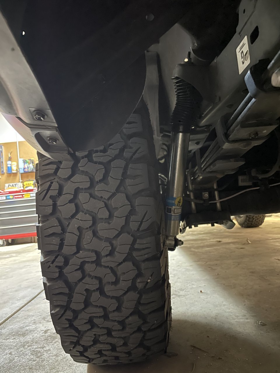

  12. Oct 26, 2021 at 10:19 PM
    #1332
    dbwalker
    dbwalker Active Member
    Aug 30, 2021
    #375715
    42
    Devin
    northern CA
    2021 tacoma trd off road
    lots and lots, never ending mods
    so two weeks and 500 miles ago I put in my new kit 5100s with OME 885s "1/4 driver side spacer" Icon AALs with 1/2" spacers and 2 degree shims on the back "ditched the overload springs" now that its settled I did measurements again center of hub to edge of fender well and I wound up with 1" lift in the back and only 1/2" lift in the front, got the stuff from Headstrong, anyone have any idea's? truck rides and feels great but dam I would have expected to get at least an inch in the front after settling

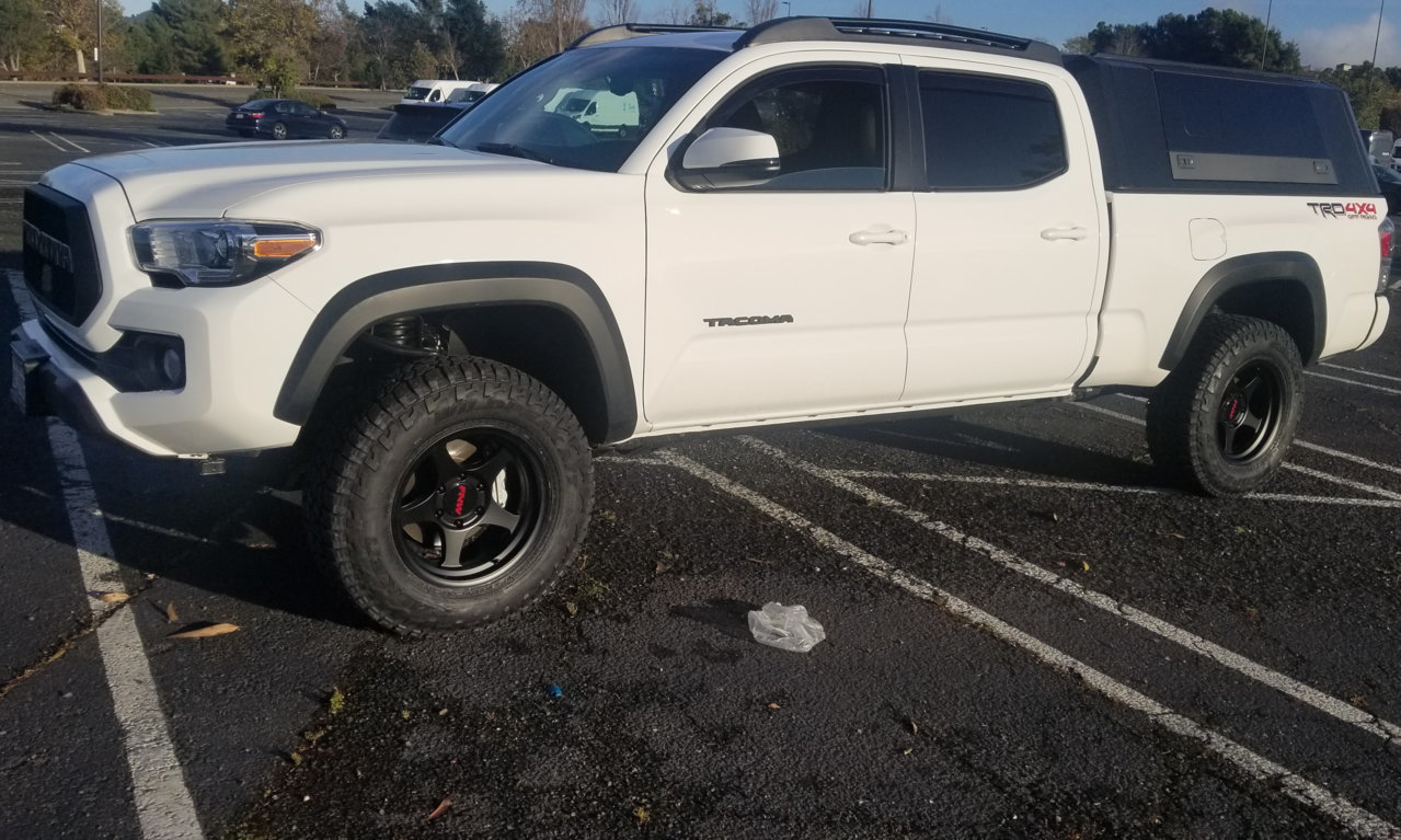

  13. Jan 17, 2022 at 3:48 AM
    #1333
    TRD2010SpeedwayBlue
    TRD2010SpeedwayBlue Well-Known Member
    Sep 12, 2015
    #164039
    1,814
    Brandon
    2010 Speedway Blue TRD Offroad
    Needing an alignment as it’s been a few years.
    My steering wheel is like off centered to the left when driving straight.

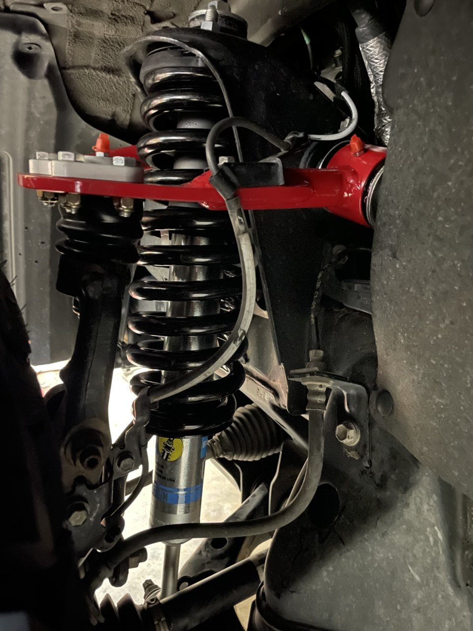

    Bringing it to toyota to have a tech i know do it. So i’m wondering what desired alignment specs should be so i know what to tell him to aim for.
    My suspension set up is 5100’s ome 885 total chaos uca’s 285/70/17 ko2’s with trdpro 4runner wheels
    gabbo2112 likes this.
  14. Jan 17, 2022 at 3:52 AM
    #1334
    trktwo
    trktwo Nagger
    Feb 21, 2012
    #73282
    288
    tommy
    biloxi
    2015 MGM DCLB TRD Sport 4x4
    your truck looks pretty tall. I'd bet you got more than 1" out of that. but wtf do I know?

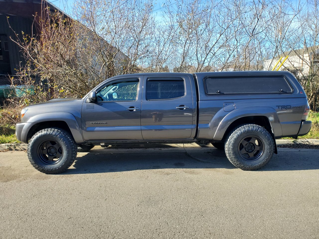

    On my way! 885 on Bilstien 5100, aal in rear. from headstrong

  16. Jan 21, 2022 at 5:32 PM
    #1336
    dbwalker
    Aug 30, 2021
    #375715
    42
    Devin
    northern CA
    I park next to a stock TRD exactly like mine almost daily at work, my coworker told me he is waiting to see how mine turns out before he buys anything as our trucks are almost identical in height even though I did all that stuff, I Fd up ordering the 885s as those are best for 2nd gen Tacomas, I should have gotten 886s for my setup, doesn't matter much now as my Eibach 2.0 coil overs just arrived today

  18. Jan 25, 2022 at 7:32 AM
    #1338
    dbwalker
    Aug 30, 2021
    #375715
    42
    Devin
    northern CA
    nope just 1" in the back and only 1/2 in the front is all I got out of it, the back came out just as I expected with 1" lift the front I fkd up by getting 885s as I should have gotten 886s for 3rd gen, have Eibach pro 2.0s on it now and set them so the truck is almost perfectly level, currently the truck is sitting right at the height I wanted but the Eibachs are quite a but stiffer then what I've gotten use to with those 885s, I'm adding an SSO bumper and winch when it shows up so I'm hoping that added weight will smooth it out a bit, may just take a week or two to settle

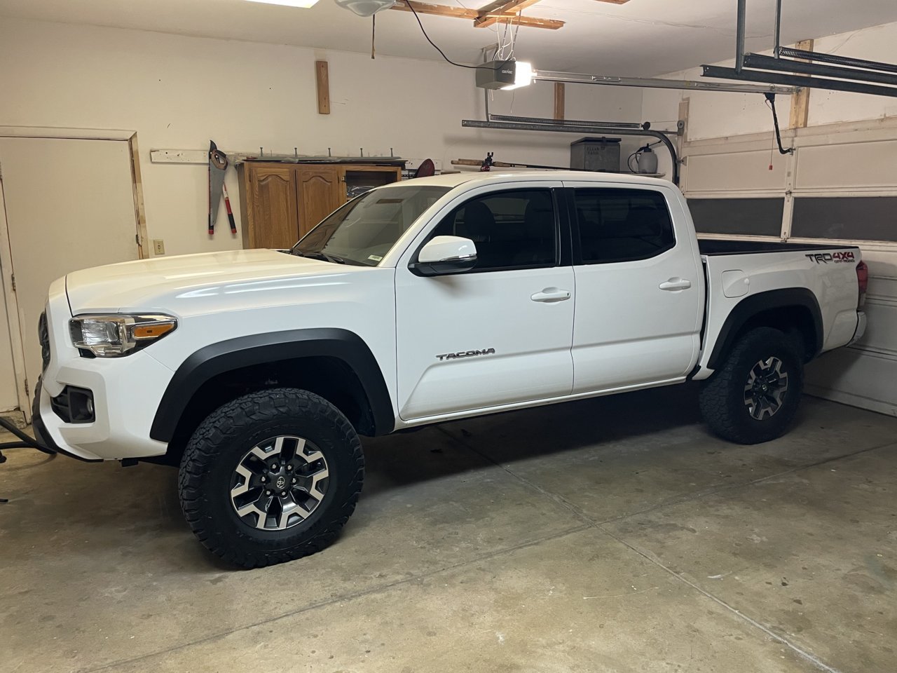

  20. Mar 21, 2022 at 7:27 PM
    #1340
    Benjaminfrankss
    Benjaminfrankss Member
    May 10, 2021
    #365324
    11
    Benjamin
    2019 Tacoma trd off road
    Borla exhaust, leveling kit, s&b intake

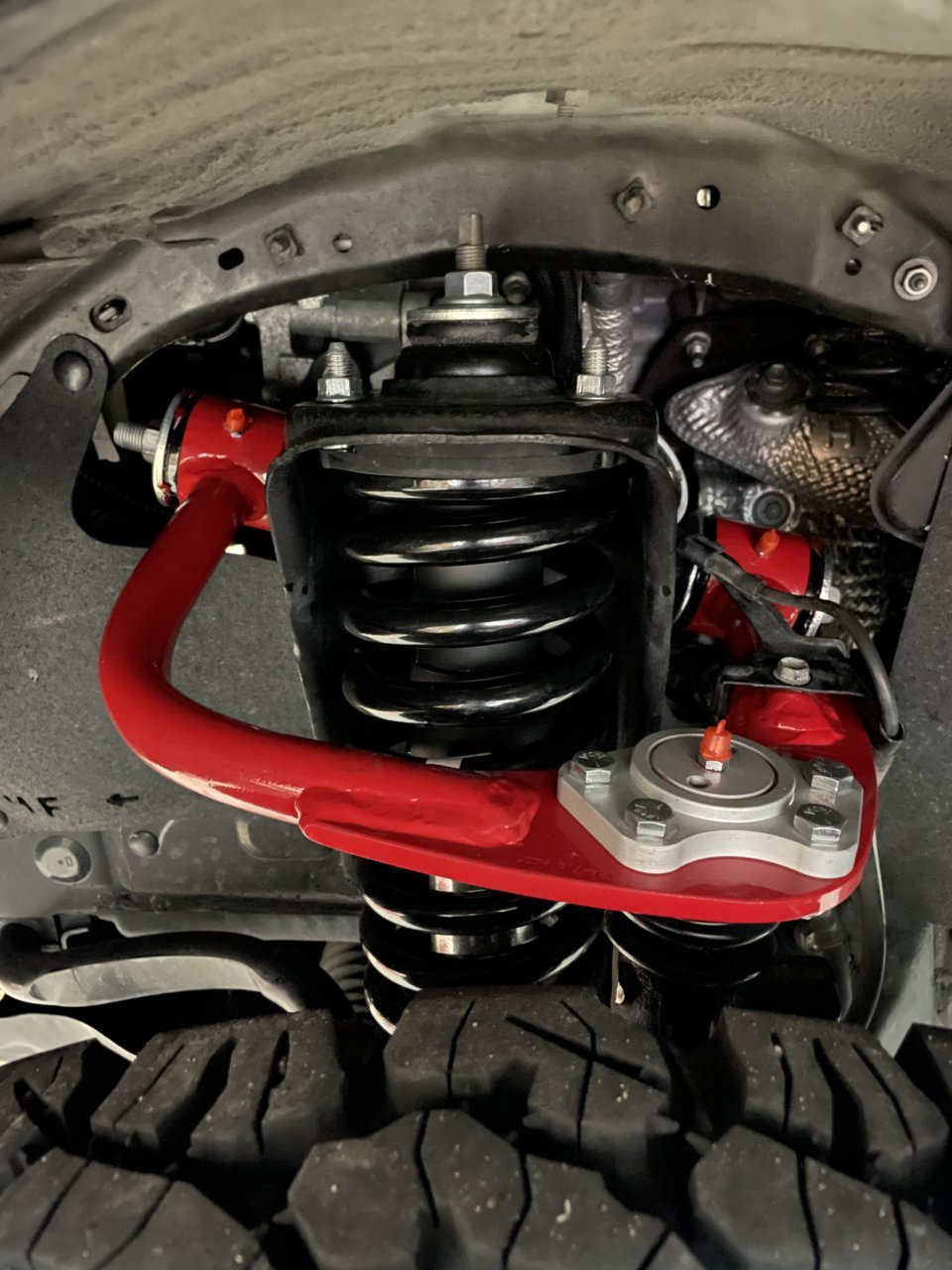

    5100s. OME 885s. JBA ucas. East coast gear supply bushing. Just got them last weekend. Rides great for the driving I do. Sits a touch lower in back. Hopefully settles a hair in the front.
