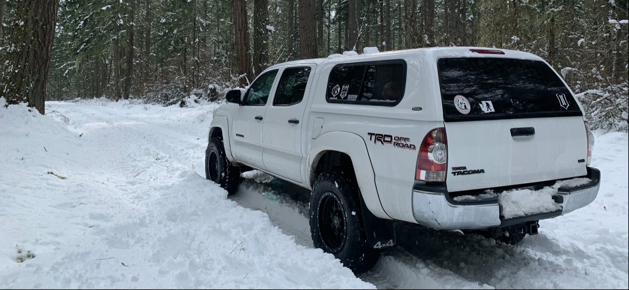

    Was this photo after install? I see so many conflicting reports on what the 885/5100 combo yields, I’m hesitant to pull the trigger. It’s a lot of money for things to potentially not work out

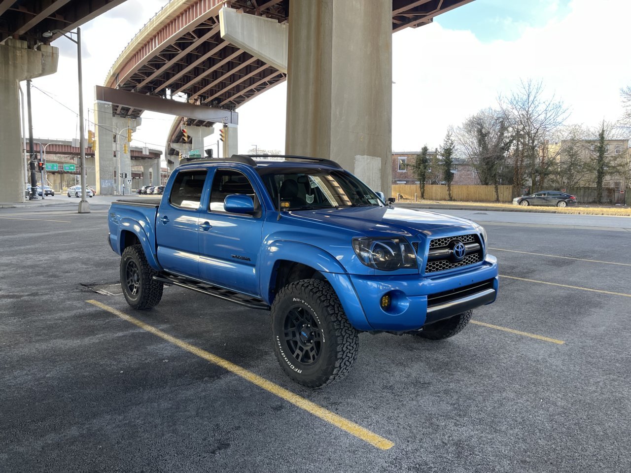

    285/70/17’s with 885/5100’s. Highly recommend this setup. it looks perfect!

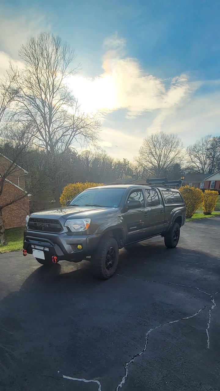

    Just installed 5100s all the way around with 885s on the bottom notch and 1/4" driver side plate spacer up front and a 3 leaf AAL from Headstrong for +1.5"-2" in the rear.
    Pretty happy with it so far.. although my 265/75/16 KO2s look a little small now. Might bump up the size when these run down
