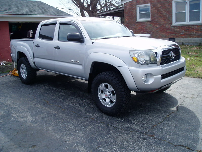

    My truck;
    Lift is 5100's @ 0", 885X's, 1/2" spacer on drivers side to get front level. (Most seem to do it with 1/4" spacer) Front lift measures 2-5/8" from stock ride height. Rear is 5100's, Deavers 2" AAL, Headstrong U-bolt flip kit. Rear is full 2" above stock ride height.
    Ride is excellent, front AND rear. Low speeds are much like stock when it was new. High speeds (interstate) is far better than stock ride. Off road it has plenty of flex, firm enough to handle a load (that a Tacoma should be hauling) I have a restored Airstream travel trailer. I've pulled it a few times. The suspension is more than capable of pulling what the truck has power enough to pull... Braking is solid and straight, no nose diving or fishtailing.
    Personally, I don't know what else I could ask of a lift kit. This is my 17th 4wd over 42 years, 4th Tacoma, and I drive well over 30,000 miles a year. I'm not an "expert", but not a first timer either....

    that looks great! yeah have to decide which leaf's i want to get, also i plan on running stock uca's
    you didnt have any problems with alignment did you?

    I kept my stock UCA's.....and got ideal alignment numbers. (2.9* caster) still in the middle of adjustment range. The truck drives straight, handles BETTER than it did stock, and has room to lift it more. I MAY throw in a 1/2" spacer each side and bring it to a full 3" at some point. I'm sorta OCD about my trucks....Gotta be PERFECT before I'm happy....
    And I'm happy!

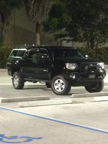

    image.jpg No alignment issue here either and still have stock ucas
