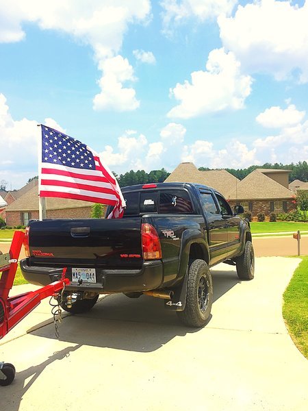

    image.jpg Hope everyone had a great 4th of July!

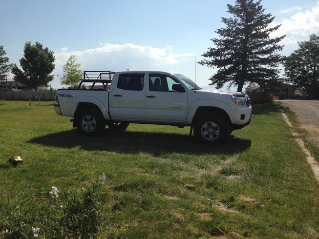

    885x coils on 5100s. SPC upper a-arms 255/85/16 bighorns, 12k lb reciever mount rear winch,CBI offroad moab bumper,8k lb warn front winch, swaybar delete, spidertrax,icon minipacks, custom dog box, husky liners
    Just installed 5100s at 0 with 885x coils. They will clear 255/85/16 tire on stock wheels.

    4X Innovations Sliders Tech deck Bilstein 5100's OME 885 CB radio install Rear diff breather mod After market front bumper lights Redline hood struts Shorty antenna door seal protectors Glove box/ Center console motion light Trailer harness plug relocation mod/Edit SOS HC rear bumper Ditch mount Lights with CBI brackets morimoto fog lights
    TREED got any pics:worthless:
