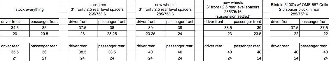

    Hey. I don't post too often on here, but figured I could possibly help out. My current set up is as follows:
    Fronts:
    Bilstein 5100's with OME 887 Coils (perch ring set at lowest setting)
    Rears:
    Bilstein 5100's with stock leaf springs and a 2.5 spacer block
    running 285/75/16 BFGoodrich Ko2's
    FYI, I purchased my entire setup used from a member on here a few months ago. Ive put on maybe around 3-4k miles on them so far; however, previous owner claims to have used the suspension for about a year. Was a bit skeptical on that because the shocks looked like they've been on his truck for over a year, but who knows... I honestly didn't really care too much at the price I got them for. I imagine these have pretty much settled down since these have been used up quite a bit. Here's some measurements I took with everything. Top measurements are from fender arch to ground and bottom measurements is from fender arch to center of wheel hub

    21
    2020 TRD Sport
    Thanks! That's kinda the information I was curious about. Seems like this is the amount of settlement everyone was getting after a year or 2. I was also curious to see what the experience is now from those that had it on for 3-4 years. One of the biggest reasons I would pick up the 2887 over the Wheelers is because shipping to Hawaii cost an arm and a leg and then a little more. For kicks, I went all the way to the shipping part and the coils would cost $80 just to ship lol.
    Again, probably wont lift my truck anytime soon tho... Just collecting knowledge from others as I was for all this Covid issue to settle.
