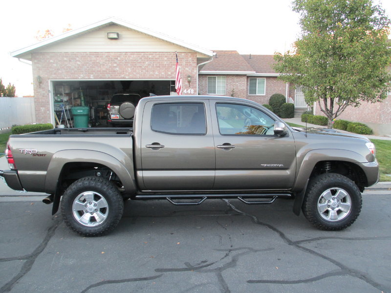

    Here is mine. Fox shocks, set at 3", no rub.
