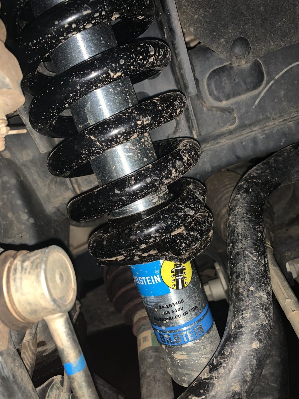

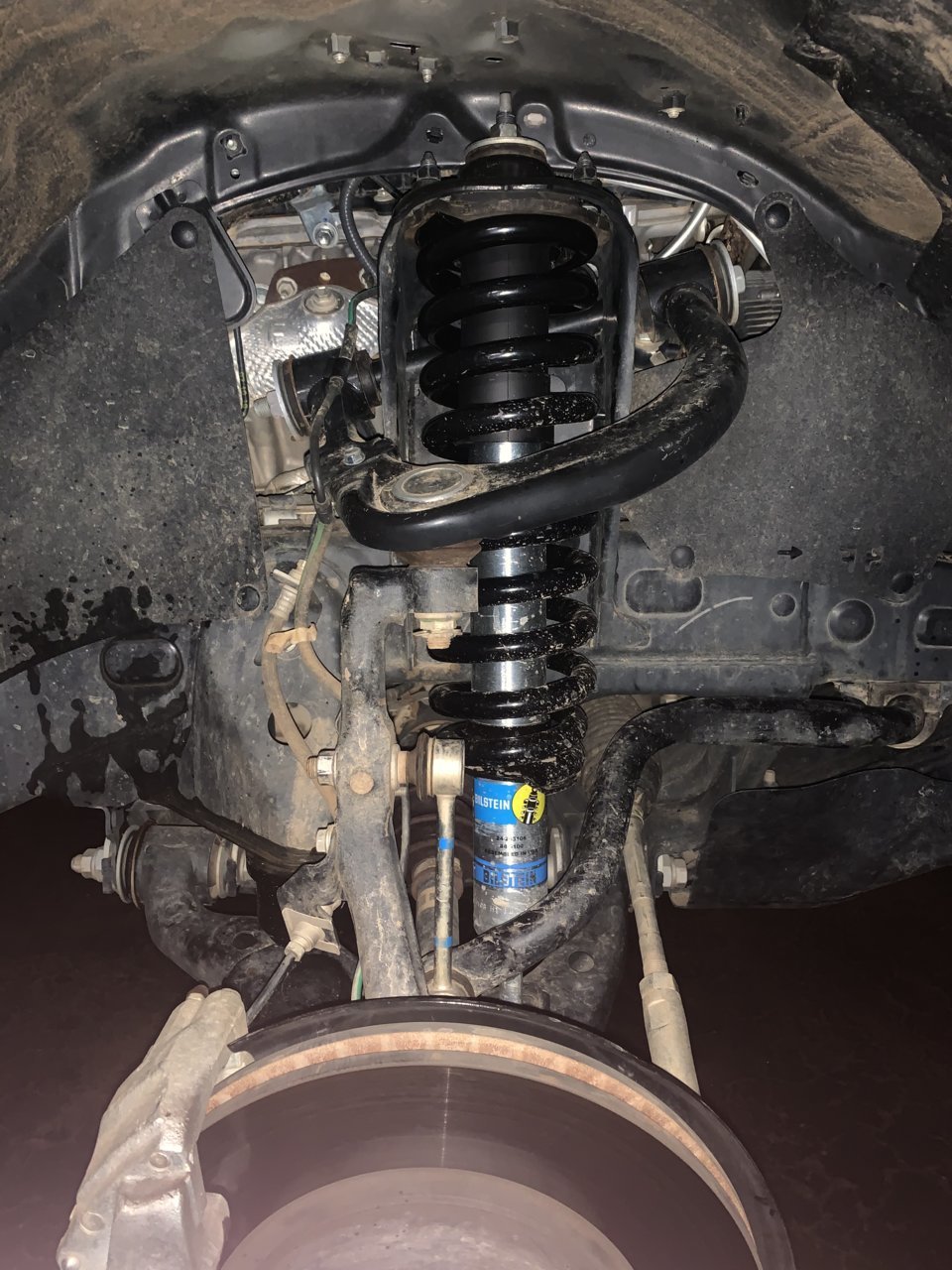

    45043704-3D83-406F-85BA-AE9AA798C254.jpg 3C435925-B305-4148-A175-D6E88E6F5A3D.jpg 40A357D1-C7B9-4483-B729-AC7CE3110879.jpg I recently installed new bilstein 5100’s with OME 887 Springs on the lowest notch of the Bilsteins and got no lift out of it. Was told I should get about 2 inches of lift. Help

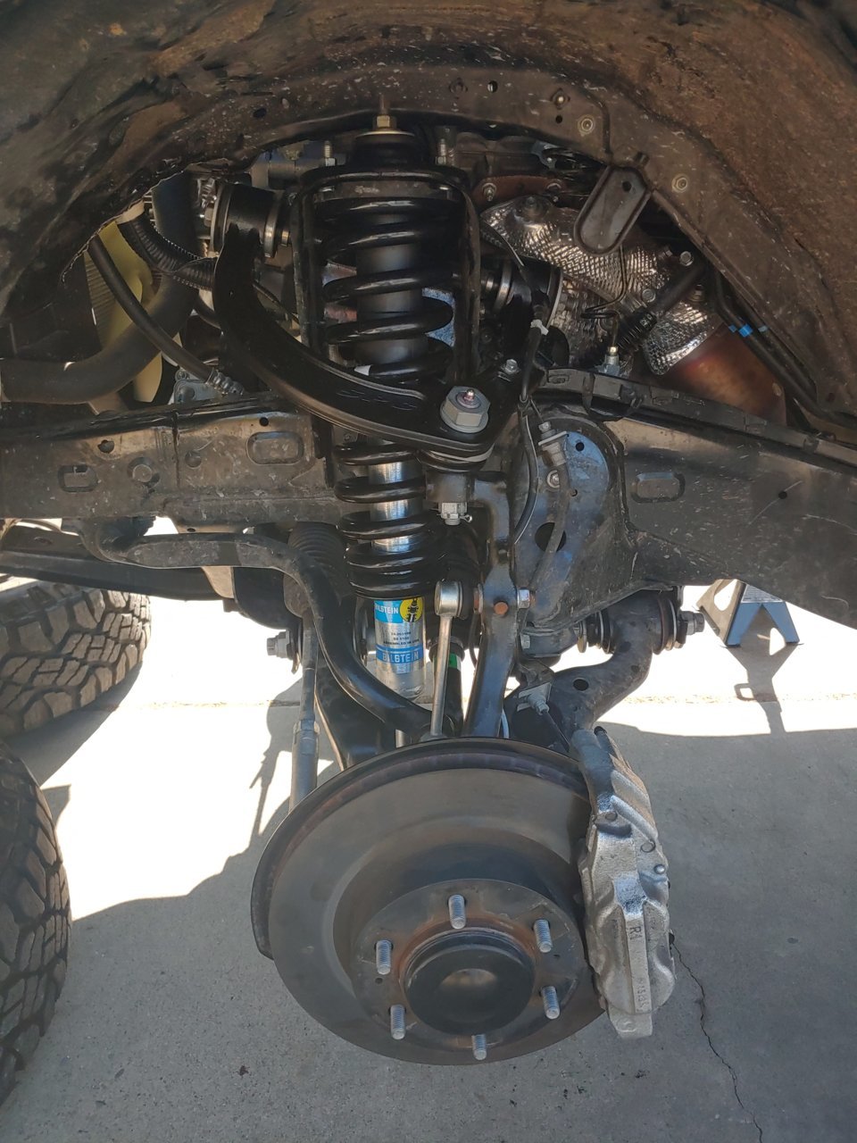

    Take a pic and post it. Here is how mine
