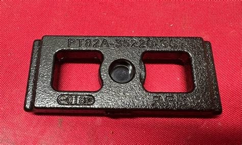

    Toyota makes a 1/2" block that slips in rather than Toytec's shim, which requires disassembling the leaf. Toyota dealers carry and sell them.

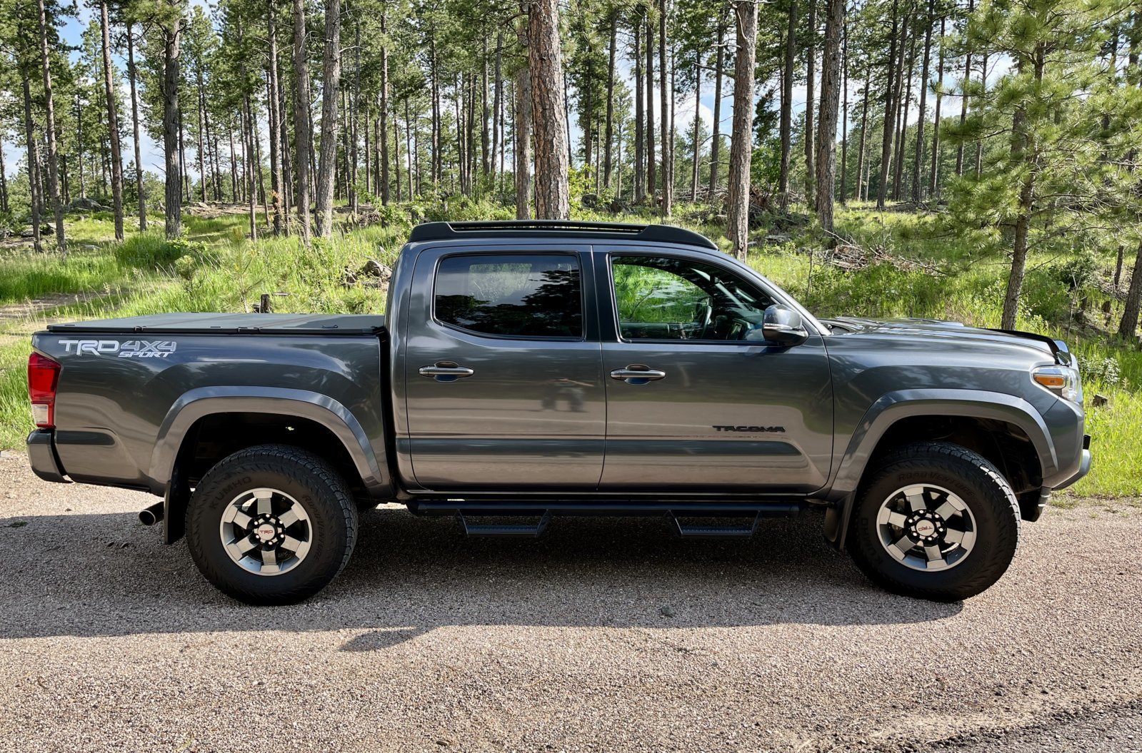

    IMG_6872.jpg I have 5100s with one inch rear blocks, with fronts set to provide natural rake stance. 265/75/16s, rides just right.

    12
    Looks good! Any problem with downsizing to 16” wheels on the sport? I’ve seen some comments saying it can be a challenge with the front break calipers

    I do not believe so. I’ve just seen people saying depending on the wheel, it might be tight. And some have said shops have told them 16” won’t fit, etc. So I was just curious his experience of downsizing to 16”. Because I’ve considered it.

    Truck had these 16 inch wheels when I bought it with 20k miles, came off FJ Cruiser. Truck was the dealer sales managers lease, so the dealer did the original lift with spacers. The rims must have the correct offset, no rubbing or interference noticed. I then had the front spacer lifts originally installed, replaced with 5100s, and downsized tires from 285s to 265s when I needed new. I think shop used the third clip from the bottom but I did not install, I had a shop do it, and they left the 1 inch blocks in the rear untouched. I think I can see two empty clip slots beneath strut. When I went to pick the truck up after installing 5100s, they claimed level, but nose looked too high so I had them take it back in and lower the front one clip notch. About an inch drop back to front. I think it turned out great.

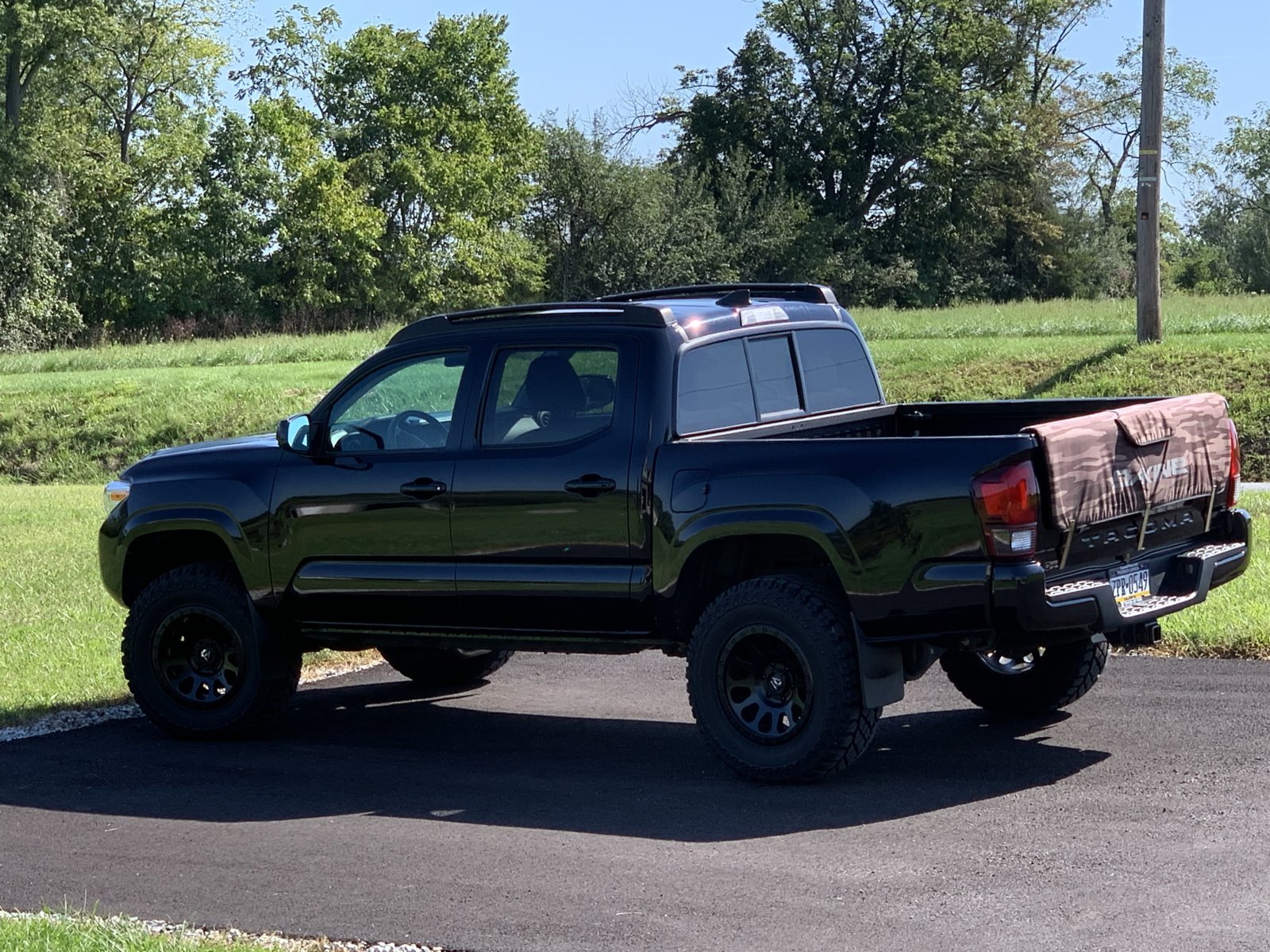

    I have 5100 4th position and 1 inch block in the rear running 275/70-17. Only buzz the front mud flaps from time to time when turning and hit a bump. upload_2024-3-17_14-48-12.jpg
