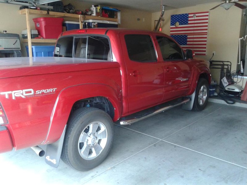

    End result is I want level. No rake. So with a 1.5" lift in rear I'd need to come up like 2.5" in front I believe.

    Yep. Stock bumps also. I have the 5100s rears for 0-2" of lift. With my OEM overload in on my 3 leaf pack (2+1) I have 2 inches. Would recommend leaving your overload spring in as well.

    Check your measurements now and see what you'll actually need as far as height difference front/rear to be level.
    You have a 4 leaf pack, right?

    Rear 36" ground to fender
    Front 34.5 "
    4 leaf?

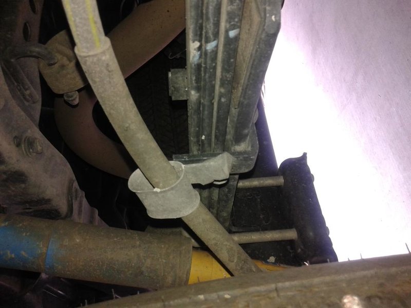

    4 leaf. 3 main and the thick one at the bottom is your overload. I would make sure that 3 leaf AAL is compatible with the 4 leaf pack just in case.

    Seems like it should work. Thats the leaf set from wheelers
    "A 3 leaf progressive racing style Add A Leaf set. Works with or without your factory overload leaf. Comes with longer U-bolts and center pins."

    Both the U bolts and centering pins are length long enough. I had to cut my centering pins shorter.
