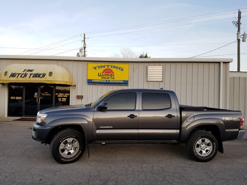

    Order bilstein 5100s , trying to decide on .85 or 1.75 setting. Just want to level out my truck with out doing anything to the rear. Truck has 14k miles and stock everything.

    Take "before" measurements (center of hub to bottom of fender) to determine where you'll be. @ .85" you'll gain ~1" in the front, 1.75" will get you ~2" in the front. Typical factory rake is 2" (back 2" higher than front), so @ 1.75", you will be level, to slightly nose high.

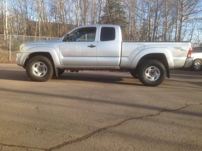

    Northern Taco
    Northern Taco Well-Known Member
    Oct 8, 2015
    #166156
    2,820
    2022 Tacoma trd off road premium 2023 tundra trd off road
    Looking at your truck in your original picture I wouldn't go any higher than 0.85" as it looks close to level the way it is. Here is my trd off road with tsb rear springs. I have a lot of rake and I'm still going 0.85" as it'll give me 1-1.5" or maybe more of lift from what people have posted on these forums.
