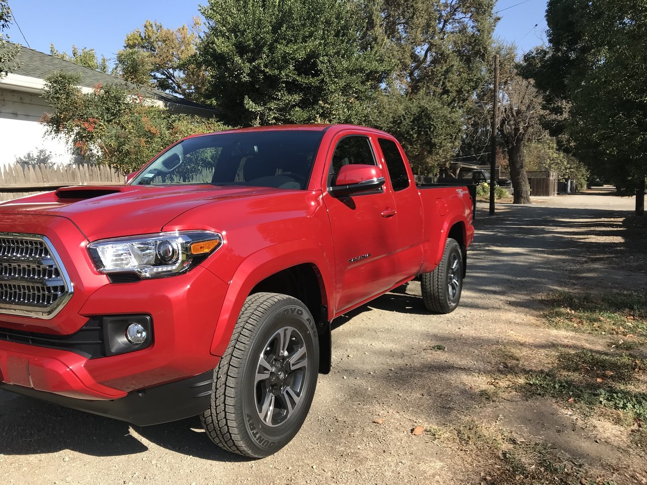

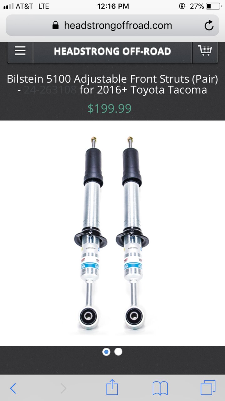

    Hello everyone. I am currently looking to get my 2017 tacoma leveled and based on the research I have done, Bilstein seems to be the way to go. I’m wondering what kind of wheel setup I can run with leveling my truck using the 5100’s. If you guys are running these struts please post pics. TIA977D5C4B-FFC1-4EE0-9558-EB027FC00ACC.jpg

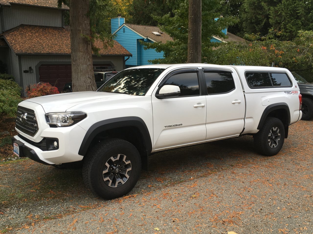

    I have 5100s up front on the 3rd notch. 1.5” toytec block on the rear.
    265/75r16 or 265/70r17 is the perfect size for this setup.
    Mine currently has stock 265/70r16 but have 285s on the way :)

    It squat a little from the canopy, which brought it down maybe .5”-.75”, so goin with the 1.5” F&R, it sits slightly raked still which is perfect IMHO.
    Your truck on the 3rd notch should sit pretty level without adding anything to the rear.
