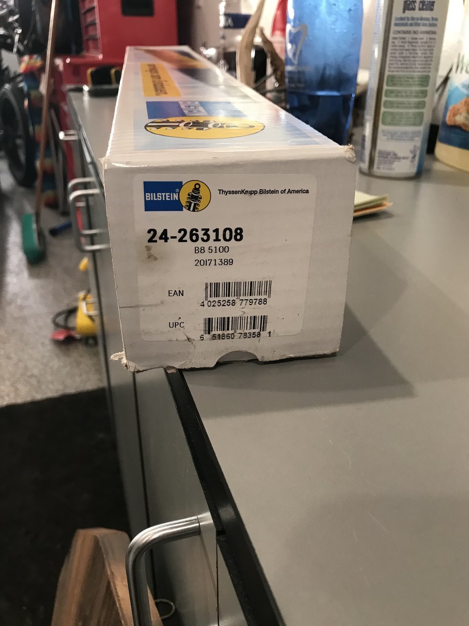

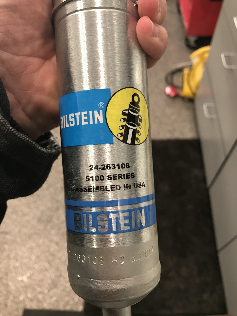

    This is what I ordered and bilstein says this is correct for a 2017 Trd off road tacoma

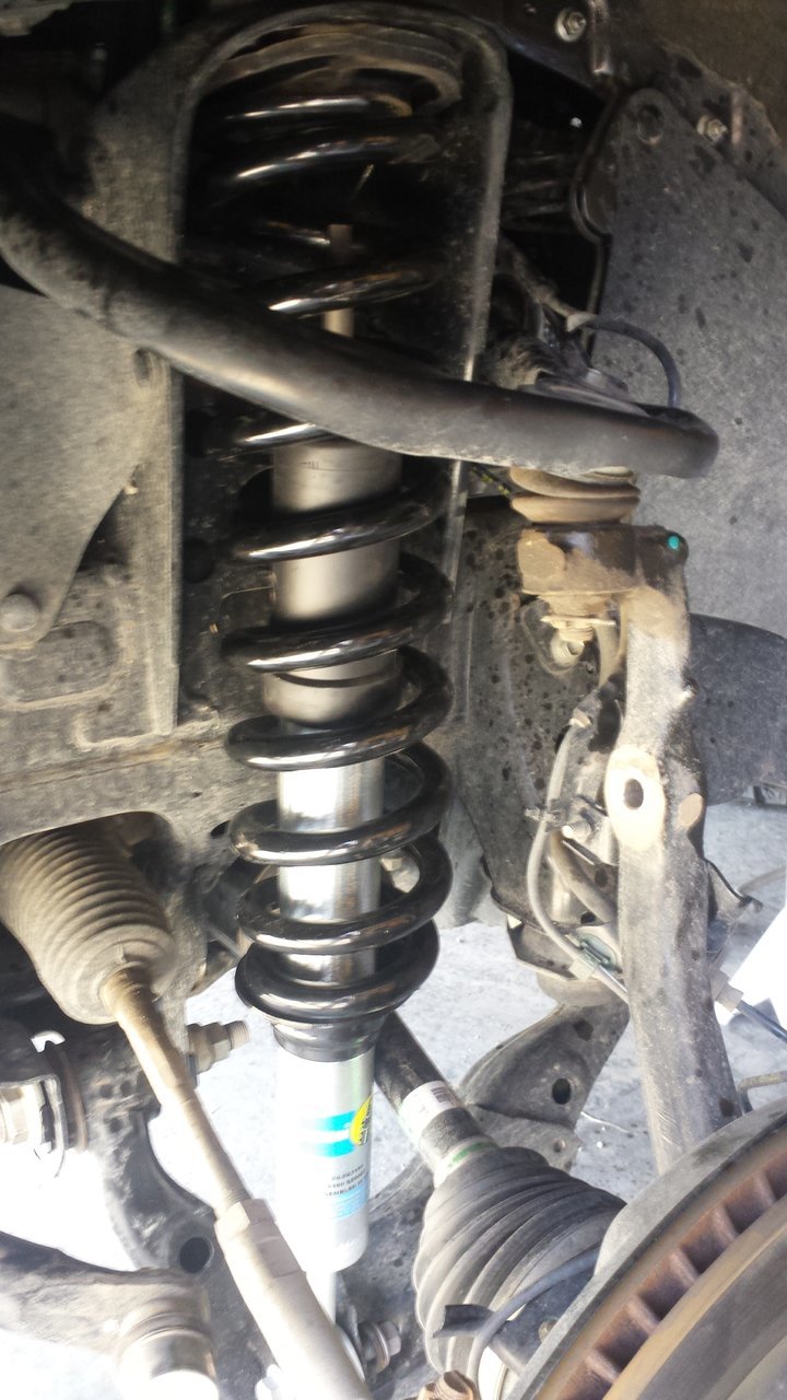

    Notice the seat here is the correct eay for installation. s643139587468852138_p242_i2_w960.jpg
    Notice in this pic the black spring seat had the edge which supports the bottom of the spring facing up.

    Well that would make up the difference. The post above that stealth mode posted is incorrect?

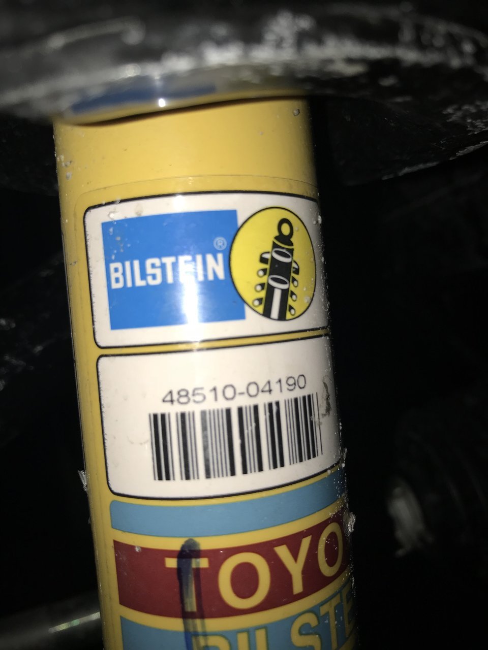

    A940ACBC-1DB2-402C-9EEA-2D7BC6840E66.jpg My bad thought they were 2 different posts. They claimed they installed it that way on your first pic. This is the stock shock on my truck now.

    Correct they should fit from the top like a hat. Not like an upside down umbrella.
