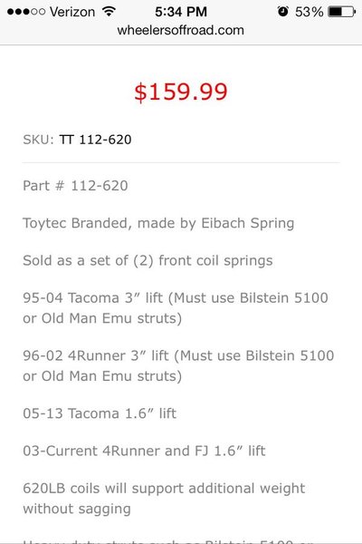

    Eibach doesn't recommend any setting above the lowest on your 5100s. You'll get just under 3 inches if they are the 620 pound spring. closer to 2.5 if you have a heavier front bumper than stock. Eibach is really good about responding to questions if you send them an email. Some guys put a .25 inch spacer to get a full 3 inches.

    This is were I'm getting the 1.6" of lift

    Eibachs will get you 1.6 lift. Set the 5100s at .85 and you get right around, maybe a tad less than 2.5 inches of lift. If you want 2.5 inches of lift, I would look at OME shocks as well. That way you don't have to compress the springs to get any lift making your ride smoother.
