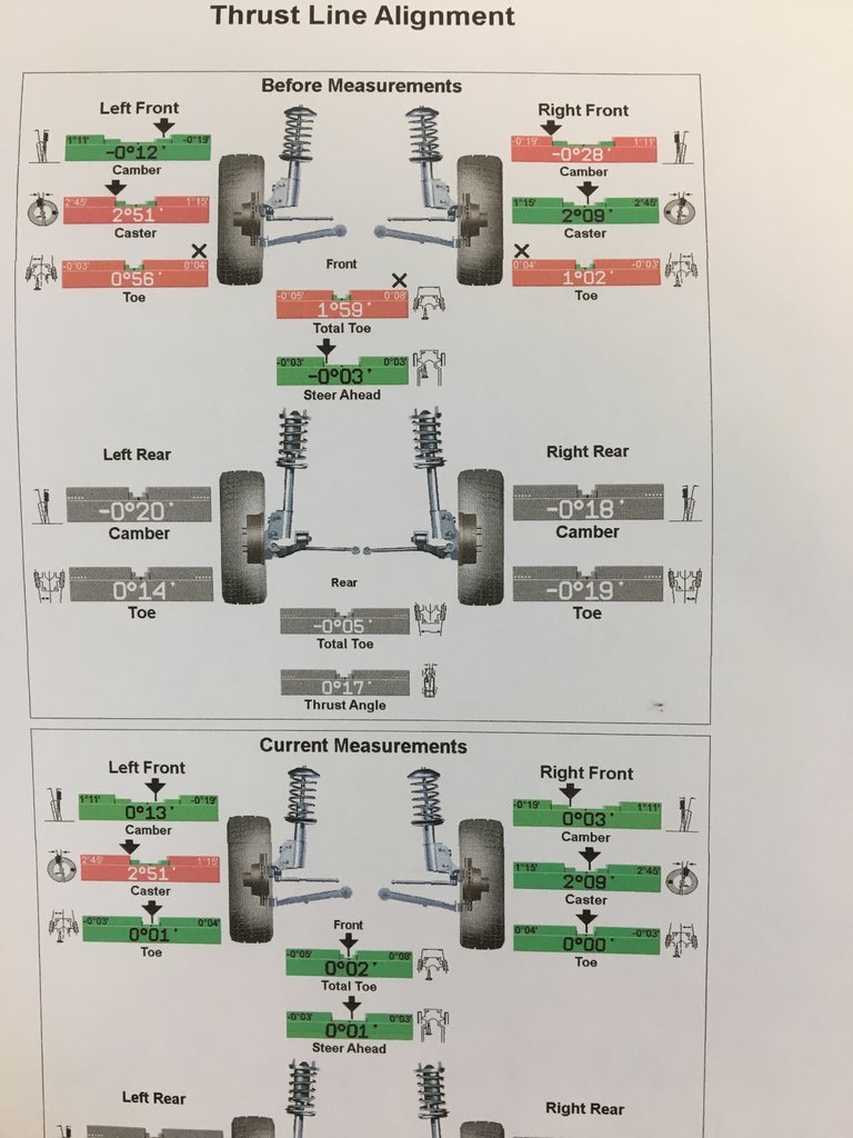

    So i measured ground to fender on my truck and got about 2 inches of lift with the extra weight of my plate bumper. I could tell my camber was slightly messed up just from looking at it in a parking spot.
    So can anyone with a similiar set up chime in and tell me if this looks alright? Disregard my front toe being all messed up in the before, all i care about is the camber and caster.IMG_1858.jpg

    My goal was 0 toe, 0 camber, and 2 or more degrees caster.
