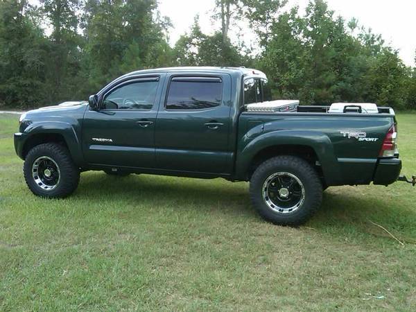

    Here is a pic of my access cab 4x4 with the rear tsb done and 1.75 billys (stock coils) in the front to give you an idea.

    IMG_0245.jpg BILLY 5100 FRONT AND BACK 1.75 FRONT/STOCK REAR
