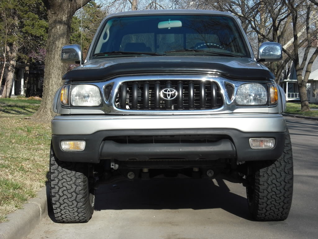

    I've got the 3" ToyTec lift on my '01 and added the diff drop kit. It's cheap, and doesn't hurt anything, so I figured why not? It does help to keep your CV joints in a "closer to factory" angle, so maybe they won't wear out any faster. I've had the lift and diff drop on for about 4 years now and haven't had a problem with my CV boots. It does just consist of spacers to drop the front of your differential and some longer bolts. You have to modify your skid plate a little by drilling out the rear holes by about one hole lenght to bolt it back up. I just used a Dremel Tool and cut them out a little further back. Everything bolted back up just fine after that. Here's a pic w/o the skid plate on so you can see the "spacers".
