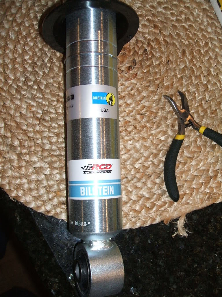

    Ok so I got my 5100's from Sonny at DSMS (great service and shipping btw!) and I want to confirm I have the right setting for 1" of lift for my appt on Thursday. I moved the snap ring to the middle groove, and so the perch just slides down and sets on top of it, right? Anything else I need to consider or tell my installer? Thanks for the help!

    :drool: at both pics :laugh:
    I think you got it right bud

    send me some of those ribs and ill tell you if your shocks are set up right:D
    jk, that is set up right, your good to go.

    Dude, I hear your concern in the question. Bottom line is you have no real options with the 3 notch billies. You know the bottom one is 0 and the top one is maximum (presumably 2.5"s). Only the middle one remains. It will be what it will be. And it will be perfect for your setup!

    Thanks man, wasn't sure if the perch slides freely until the coil sits on it or if there was something I needed to snug down so that it is set in place beforehand. Is there a certain positioning of the perch, does it have to line up a certain way?
    Also, do they normally come with bushings? Sonny said no bushings or dust boots yet my 5125's had boots and all 4 had bushings??

    No it does not matter how you position the perch. And you have to reuse the old bushing for the top plate.

    Ok good to know, thanks m8. So it should be straightforward for my guy to do the install, I'll just footnote to reuse the top plate bushings, new bushings elsewhere.
