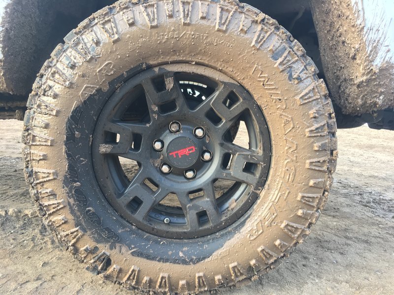

    Cab mount chop..the perfect combo that I've personally seen on a 3rd gen that has no rub at all is 285/70/17 Goodyear duratracs on trd t4r rims..with bilesteins all around an set at the 4th notch

  6. Apr 11, 2017 at 12:06 AM
