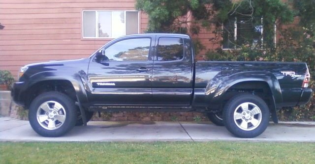

    5100s all around....front set at 1.75. Rear leaf TSB.
    Front at 1.75 with rear leaf tsb......nice and level.

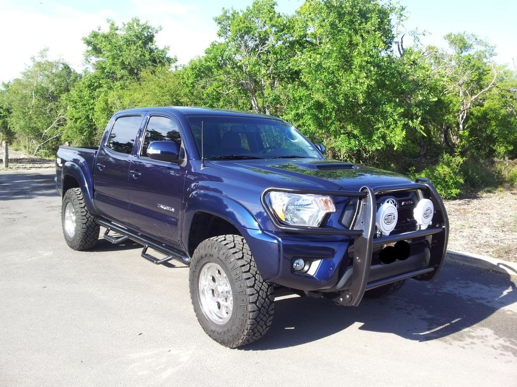

    265/75/16 S/T Maxx 16X8.5 Level 8 Trackers 5100 1.75 HID, LED interior, 3" N-Fab step bars
    1.75 in the front and I have 4 factory leafs in the rear and it is level and the ride is much better than stock. I thought stock was way too spongy. It is now firm and very smooth. You will also need it aligned after installing.
    I would also get the 5100s for the rear...you will see the difference in the actual shocks and feel it in the ride. I don't think the coil route is necessary unless you plan on putting an aftermarket bumper or do some heavy duty off roading. But for going around town and light duty off-roading...5100s on each corner is the best route.
    Some people also suggest getting this 1/4" plate to make the driver side perfectly level....I don't have the plate and the 1/4" difference is imperceptible to the eye
