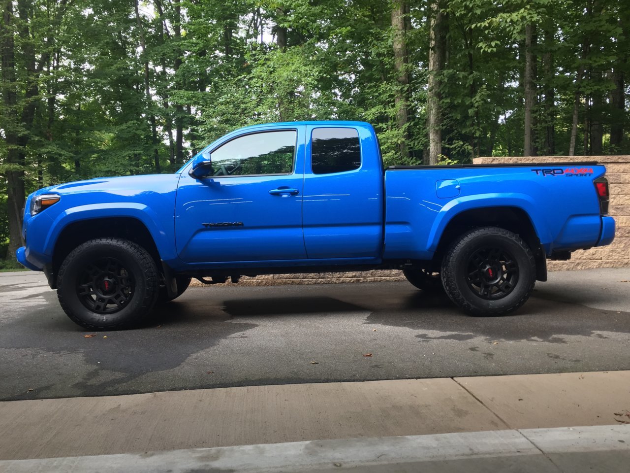

    5100s on front at third groove (1.1"), stock rear, and 265/70/17 tires.
    I'm liking it.

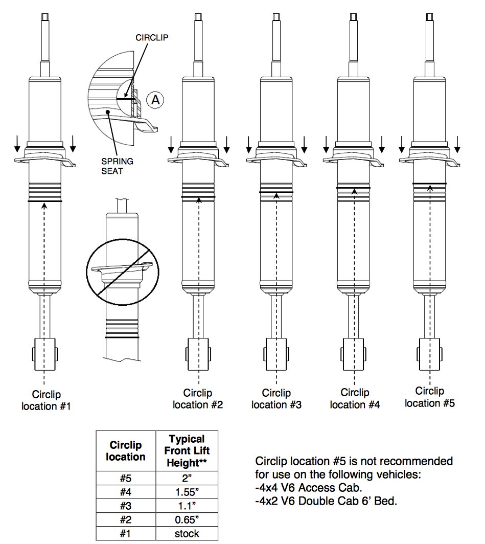

    I added my rear 1" block, a week after my 2" Bilstein 5100s up front and it looked like a Carolina squat! Now with the 1" block in the rear, it sits perfectly level at 37.5" inches all around at the bottom of my black wheel wells. Stock UCA's and stock coils as per Bilstein recommendations.
    If you dont want to ad an inch in the rear, then just set your front 5100s at 1.1" (3rd notch) and it will be level all around.

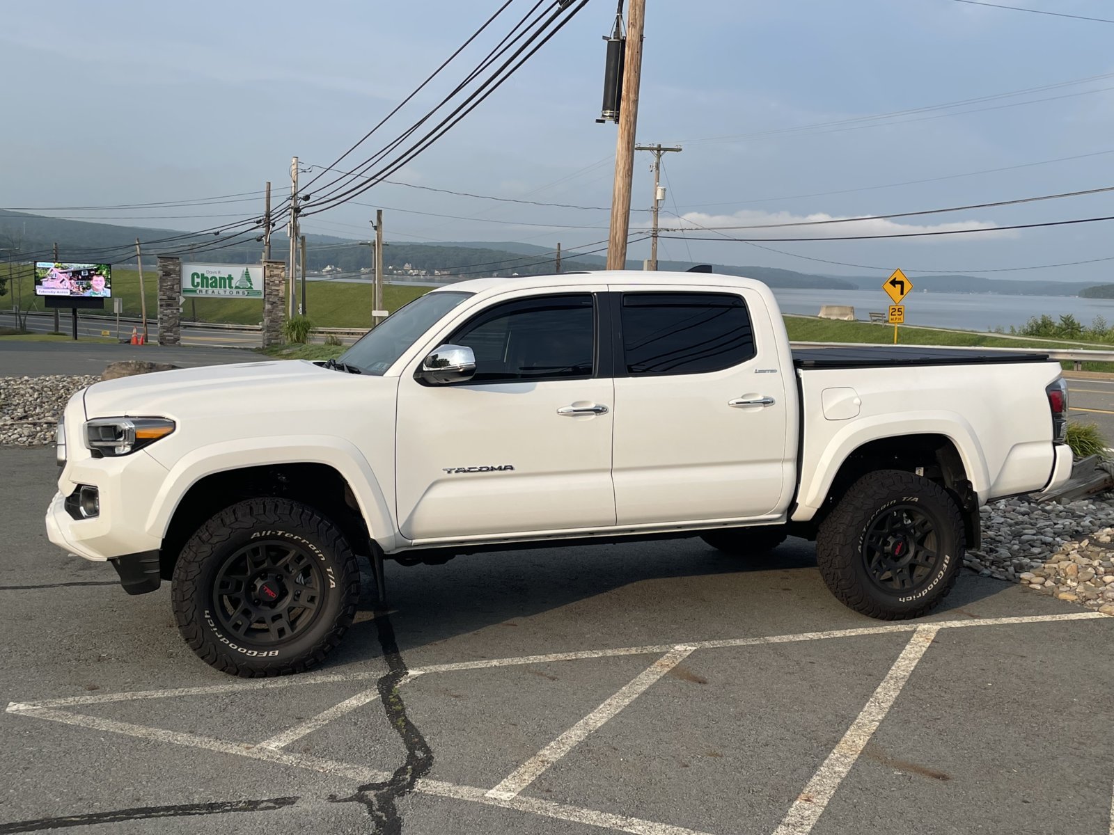

    2023 Ice Cap Limited: 2" Lift using Bilstein 5100s and 2" rear spacers (maintains rake), TRD Pro 17 x 7, 4mm offset rims, and BFG 265 65R/17 K02 tires. Tinted windows (30 front/5 back), Weathertech window deflectors, chrome tailgate letters, raptor lights, front tow shackles, and red painted OEM skid plate
    I just lifted mine 2" with Bilstein 5100s front and back. They added 2" spacers to the back to keep the rake. My tires are 265 65R/17 KO2s on 17 x 7 wheels w/4 mm offset. I like it! IMG_3927.jpg
    I don't know, since I took mine to a shop where they customize trucks. I do know that they used the stock springs with the new shocks.

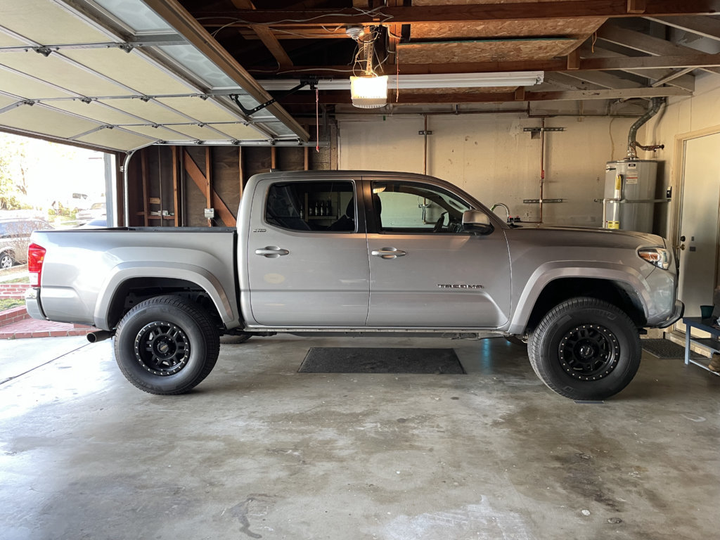

    Sharing my setup that I just got done last week, added bilstein 5100s front and rear. Was really stuck between the 1.1" and 1.55" setting but according to my measurements, a 1.55" would have put it dead even. Glad I went with the 1.55" (4th notch). Rear sits ~1/4" higher than front. Rides wayyyy better than stock.
    Hope this helps anyone else out there.
    2016 Tacoma SR5 2WD
    Rear - stock height
    Front - 4th notch, 1.55"
    Stock coils
    Tires: 265/75/R16 (I've always ran these on stock height, never rubbed. Wanted to level for a better overall look).
