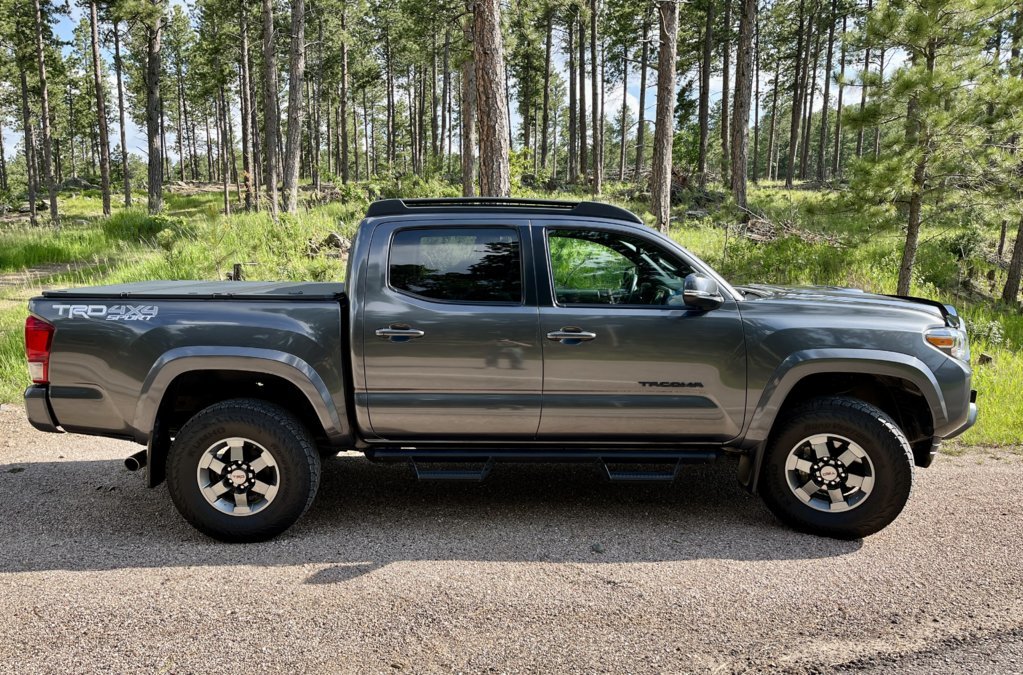

    Leveled with Bilstein 5100 shocks, Falken Rubitrek AT 265/75 tires, Redline hood struts, R4T tailgate lock, Matt Gecko LED strips in bed and under hood, WeatherTech hood guard, OEM bed mat, Husky floor mats, Carhart seat covers, Grille replacement with Toyota letters, Sony AX6000 head unit, OTT lite/mild tune, and an occasional splash of fuel additive.
    IMG_6872.jpg 1.1 inch front (two clip grooves visible above mount) with 1 inch block rear as I like the stance.
